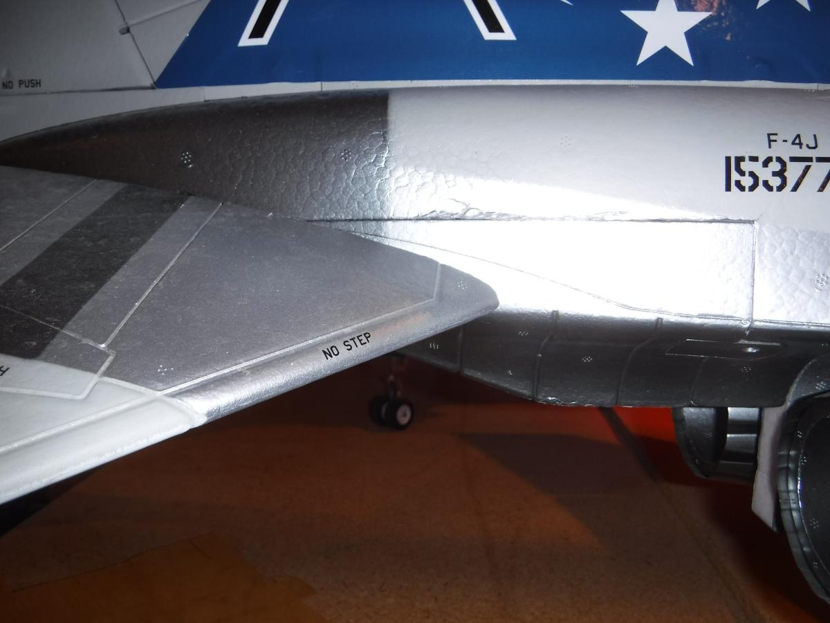

                #5267
                Originally posted by jasmith41
                When you're taxi'g back, was the elevator in a 'neutral' position? If so, it looked like you have a ton of up elevator. Is that correct?
                This is takeoff setting about .8" below the line

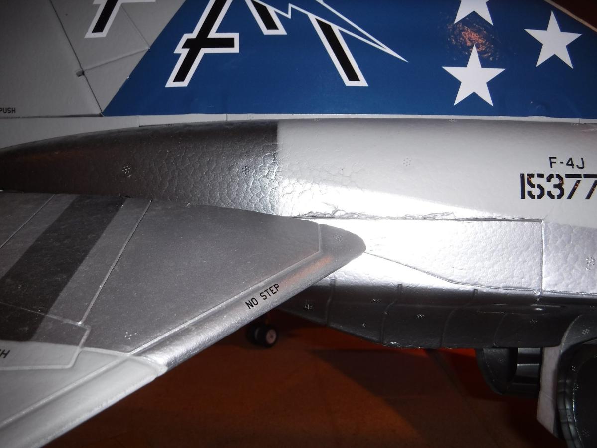

                  #5268
                  This is cruise setting with about 75% power. The plane will climb at full power with this setting. about .5" below the line

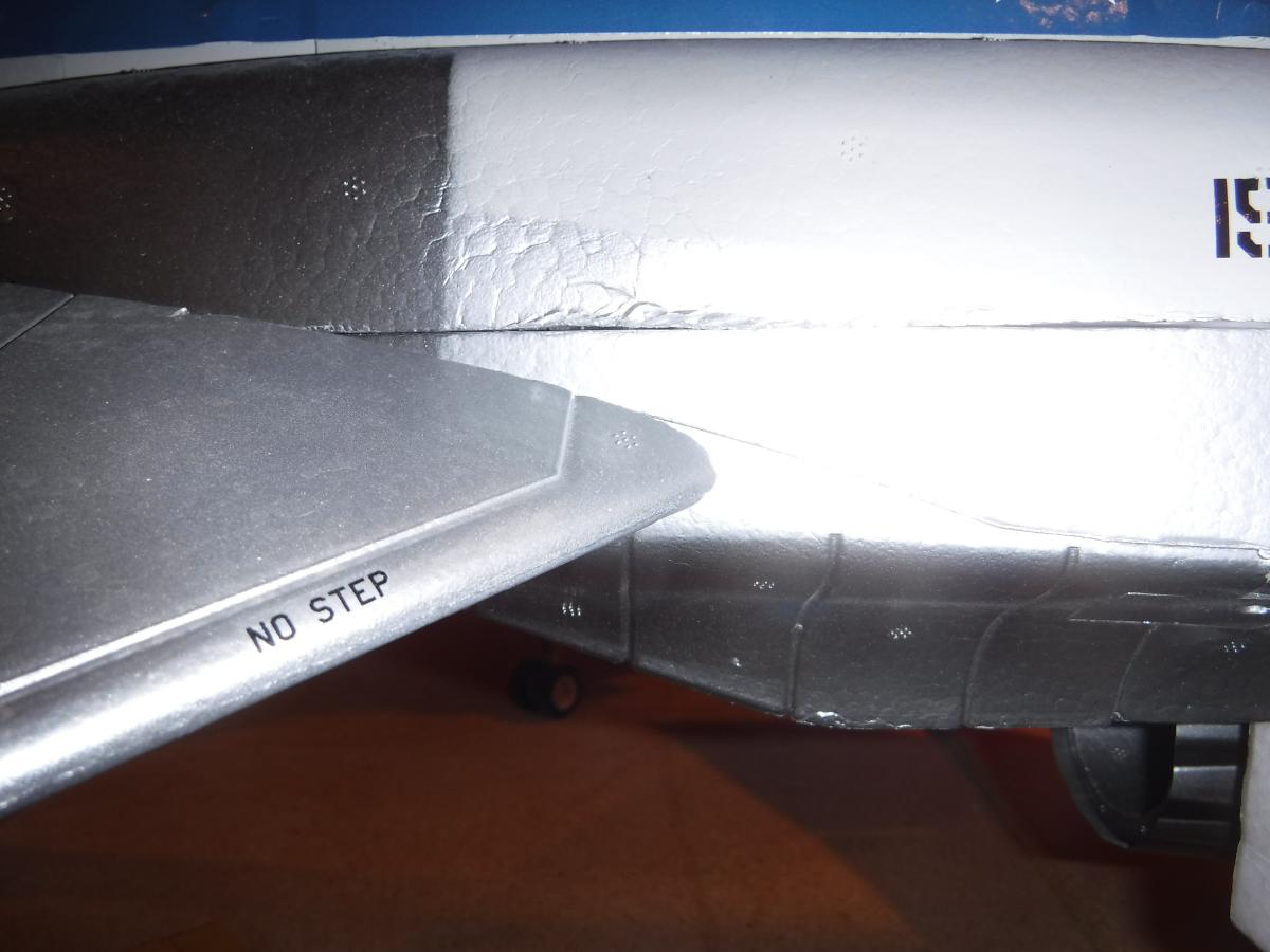

                    #5269
                    This is landing with full flaps. about 1" below the line
