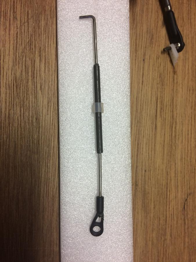

            Did you do the modifications to the elevator rods, lingages, and servos? If you did or if anyone else did can I please have the parts #? I want the F4. But, haven't bought it because of the modifications that needs to be done to the elevator. If I knew exactly what to buy then I would get the F4.

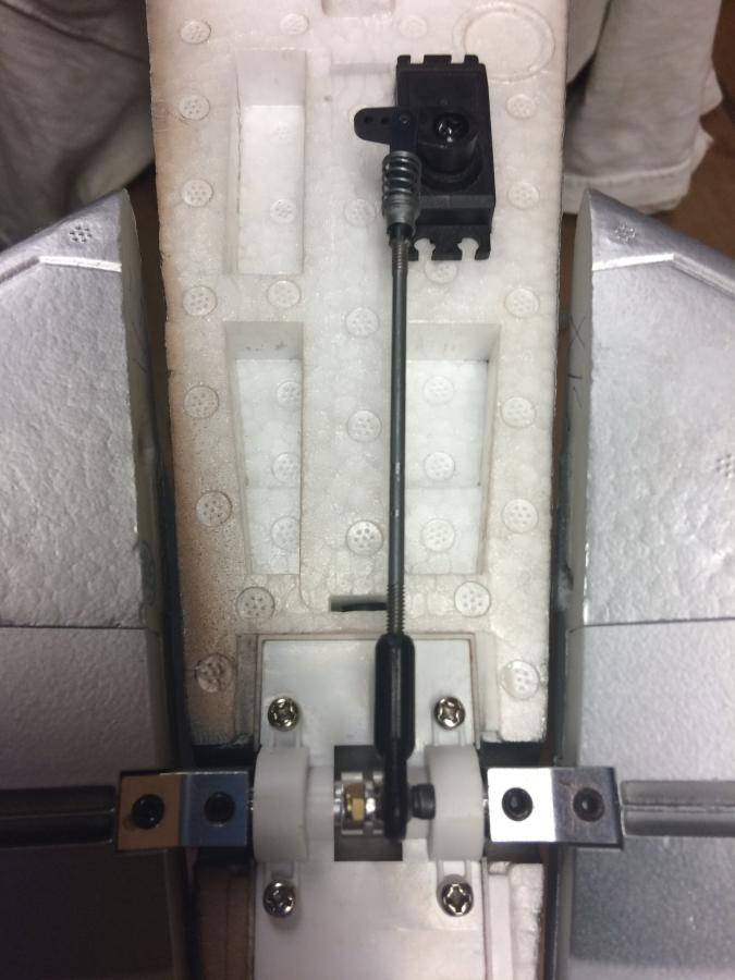

                Suggest the following:
                1) A 4-40 threaded rod which you will cut to length
                2) DU BRO 4-40 secure lock
                3) DU BRO 4-40 heavy duty ball link
                It is also a good idea (since it is critical) to install a high quality high torque elevator servo.
                One suggestion: MKS HV69. It is smaller, so you will need to make a plywood mount.
                -GG
                  Definitely a good idea to do the elevator mods, but I like livin' on the edge! I have 2 F-4's and have only beefed up the servo mounts with marine plywood and put a carbon fiber tube over the existing control rod. The ball links and a better servo are great ideas, but I figure I'll commit one of my many "pilot errors" before the elevator "system" causes a problem. If/when it does, I'll at least have an excuse to blame a problem on something other than my own pilot shortcomings. With that said, both F-4s have over 70 flights and no issues yet.
                  You may also want to change the nose gear pin as some guys are breaking those on landings, causing a whole host of other "repair" issues. I initially replaced mine by modifying a Spitfire 1600mm main axel, which will bend and not break. I did change it back to the stock nose pins about 40 flights ago and have yet to break a nose pin, but then I think I've got the landing technique down a lot better than I did when I first bought these several years ago when they still came with the crummy outrunners (immediately upgraded both to the 12 blade inrunner- but I think the stock 9 blade inrunner is fine, especially if you fly off asphalt). The stock nose pin will actually take a little more abuse without breaking than the Spitfire axel will as it will bend in a landing that the stock pin would not break at. But there is that fine line of just how much force before it does break. I conducted a very scientific experiment :lying_face: using a hammer and noted it takes a lot more force to break the stock pin than it does to bend the modified axel. Just land with the nose up and as slow as you feel comfortable at.

                    #5289
                    :pleading_face:Oh my gosh Hugh….:scream:
                    I respect you, man. But a rich poker player you ain’t gonna be.
                    Your flight #70+ will go like this (ask me how I know)…,
                    1) Stock ball link snaps (yes snaps in two).
                    2) FFSs lock full up.
                    3) F-4 goes into a nose high saber dance
                    4) F-4 eats dirt
                    5) Pilot does the WALK OF SHAME to a pile of foam which HOPEFULLY DIDN’T damage something on the ground or injure someone!
                    Really….The ball link broke!!!!
                    Don’t fly with the stock elevator ball link unless you love playing a loosing hand. It is a known issue for the F-4!!!!! It is the reason why I am on F-4 #3!
                    F-4 #1 was lost due to a radio glitch which occurred BEFORE I began using RF Chokes. Search on choke or RF choke and read and learn AND USE THEM on this bird. She benefits from them. I have had no radio issues with the F-4 since installing RF chokes. (Soap box speech).
                    -GG

                          • 5415
                          #5292

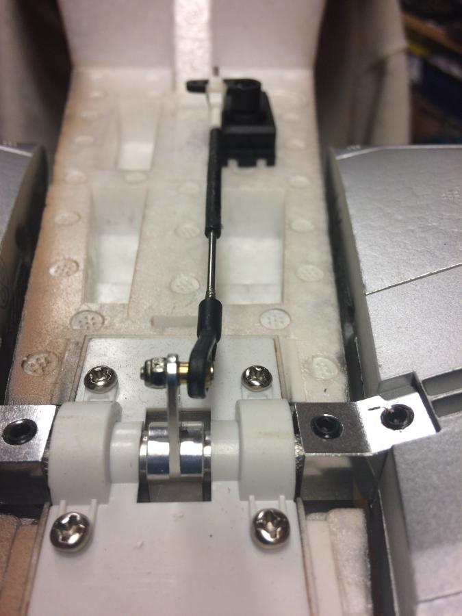

                          Here is what mine looked like after a few flights, by a few I mean just three... And my replacement.
                          Mine was an early one and FreeWing may be using the heavier duty ball links that come in some kits like the MiG-29.
                          Click image for larger version  Name:	bent push rod link 2.jpg Views:	0 Size:	105.3 KB ID:	348862Click image for larger version  Name:	bent push rod link.jpg Views:	0 Size:	56.1 KB ID:	348863Click image for larger version  Name:	better push rod link.jpg Views:	0 Size:	62.3 KB ID:	348865
