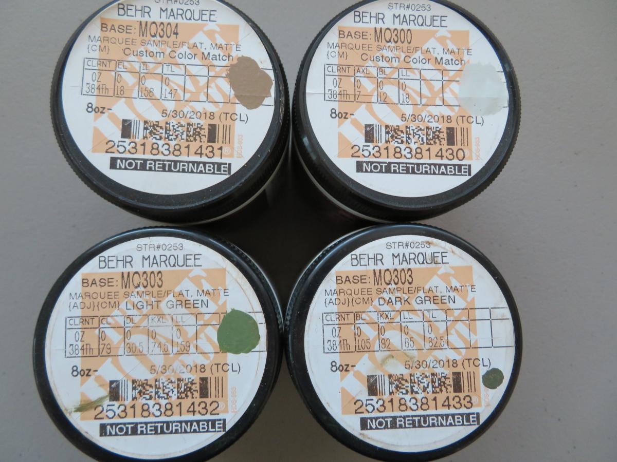

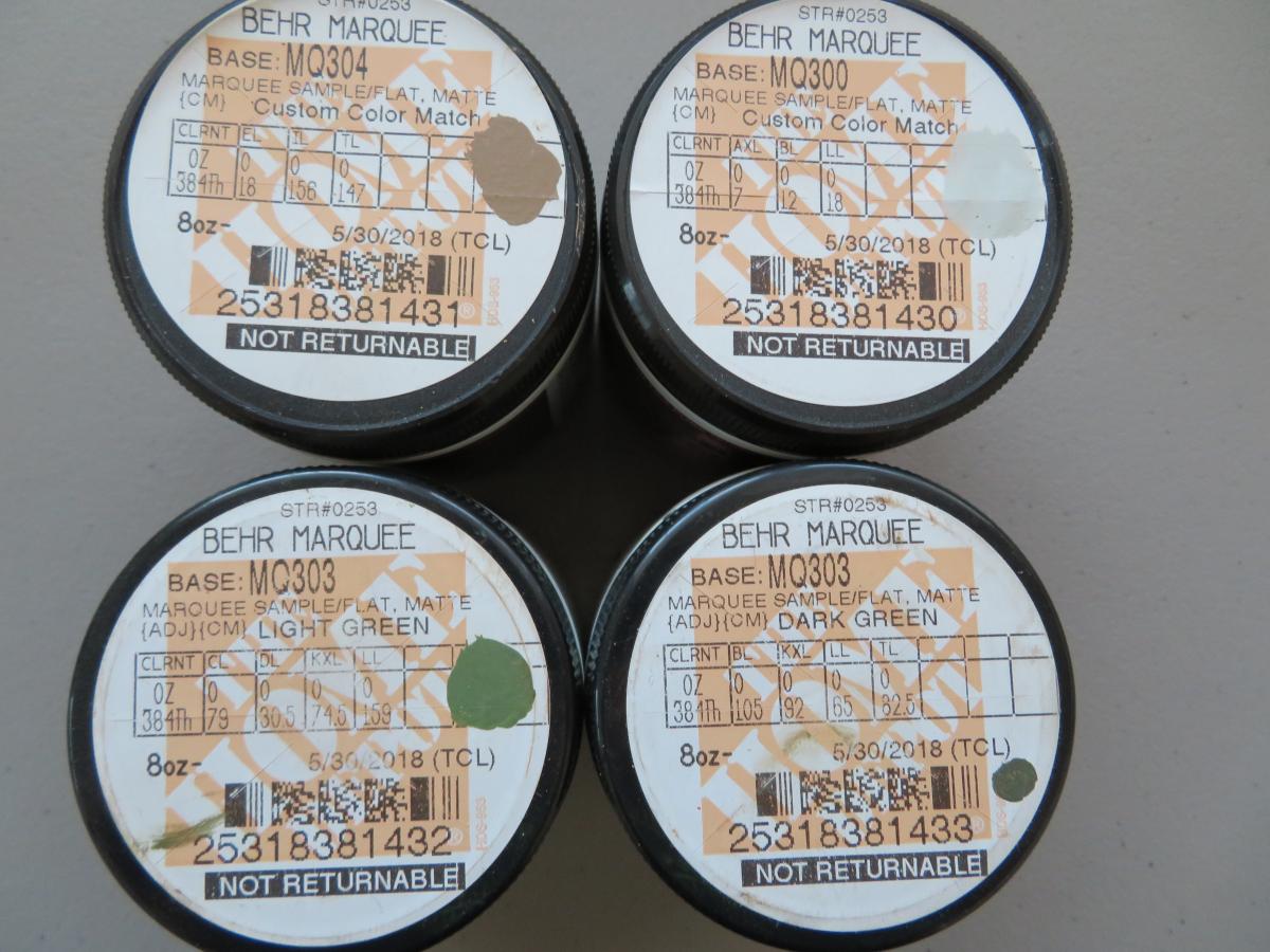

          Does anyone have photos of the paint mixing labels of the Home Depot touch-up paint for the F-4. I have some patch painting of all the colors form an accident repair and, wouldn't you know, I need ALL the colors.
          Thanks in advance,
          Bill

              Is this what you are looking for??

ID:	359577 Is this what you are looking for??

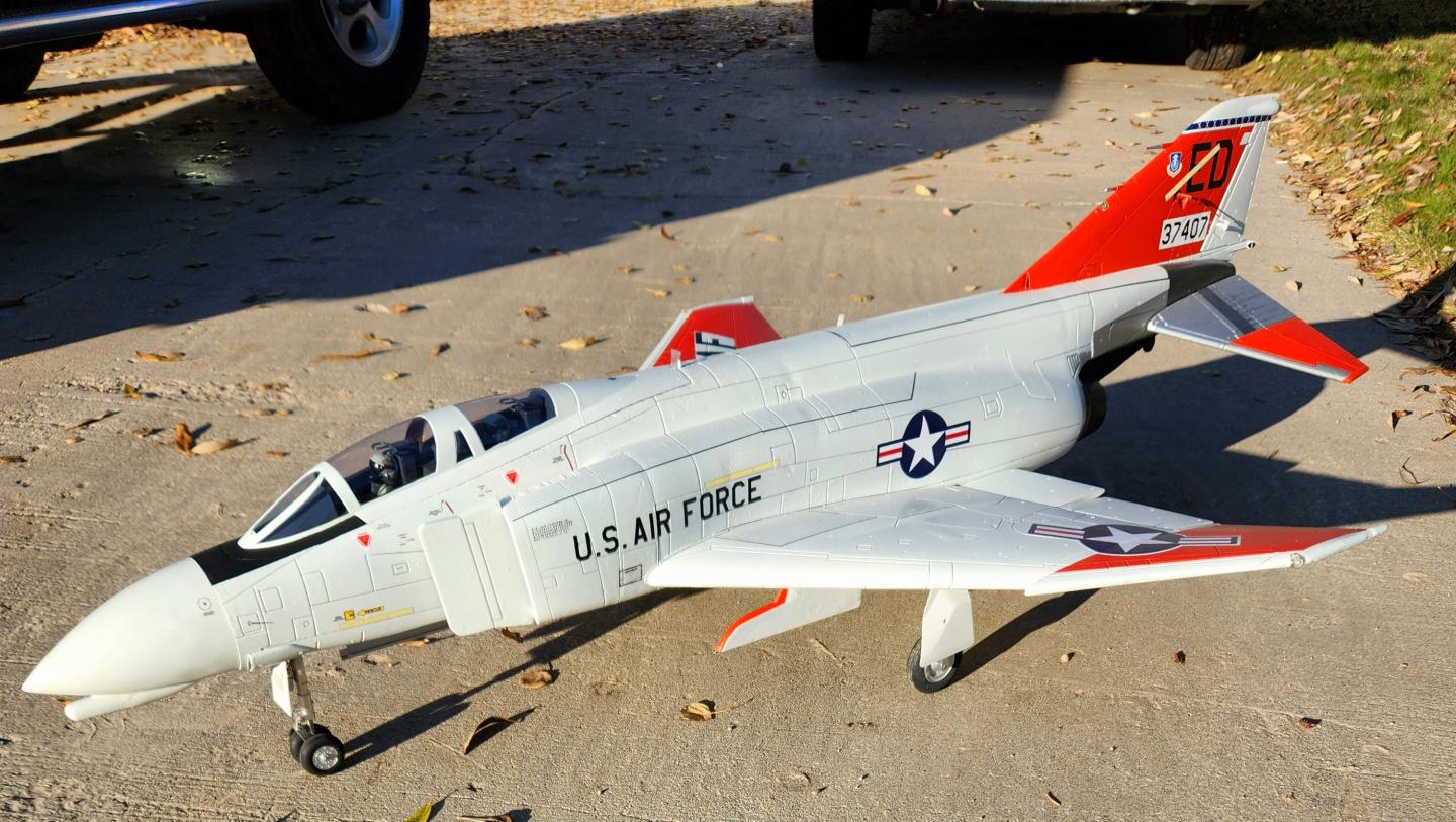

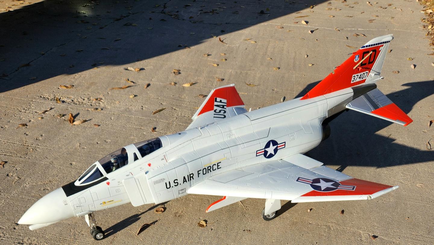

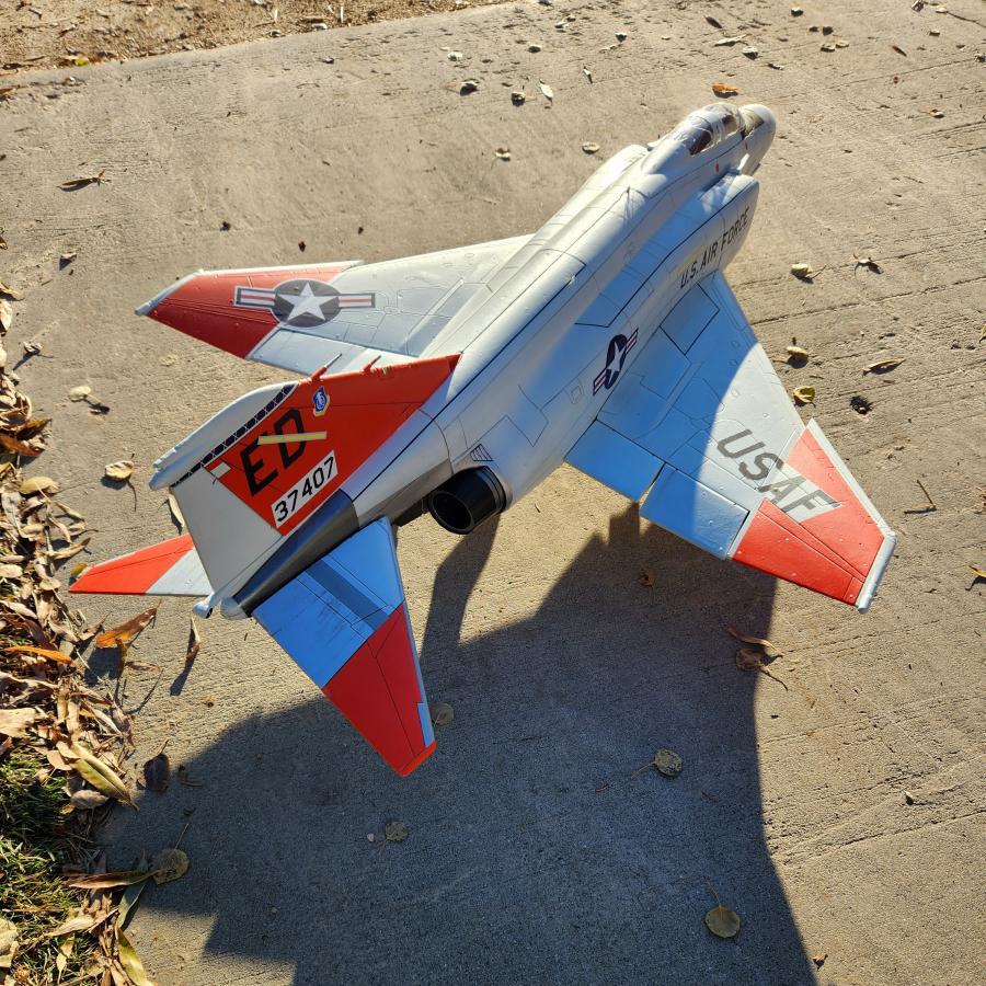

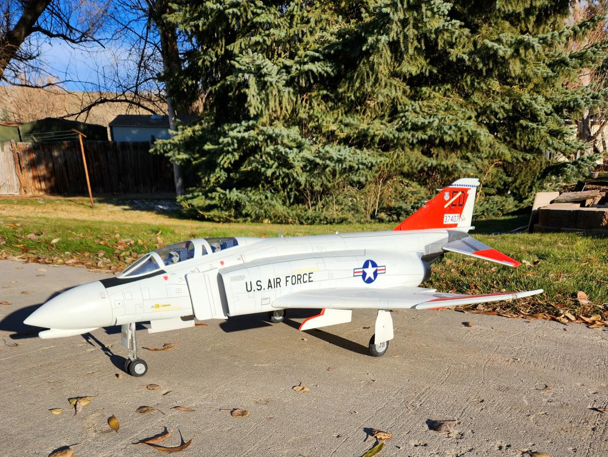

                          Greetings fellow r.c. enthusiasts!,
                          May I present the latest creation from the Wallsburg Warbird Works!.
                          Freewing F-4 Phantom II C/D SEA camouflage version re-worked as NF-4C #63-7407 "The Elder".
                          Built as an F-4C-15-MC and delivered 11/1963 to the U.S.A.F. Assigned to the 4453rd Combat Crew Training Wing McDill A.F.B. Florida. There it was converted into an NF-4C test aircraft.
                          It spent it's life bouncing back and forth between Eglin A.F.B. Florida and Edwards A.F.B. California and now is now on display at the Edwards A.F.B. museum.
                          By 1990 it was the oldest "Charlie" version still in active U.S.A.F. service and was named so on it's logbook cover.
                          For me the really cool thing is that my dad flew it in the early 70's according to his flight logbook when it was attached to the to 3346th Test Wing at Eglin A.F.B.

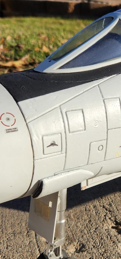

                          My bird is based on a photo of it sitting on the ramp at Edwards A.F.B. In the summer of 1989 while attached to AFFTC ( Air Force Flight Test Center). Hence the white radome rather than the usual black radome of 6512th Test Wing aircraft. Reference used was the photo book Superbase 12 EDWARDS Home of the Right Stuff by George Hall 1990 Osprey Publishing.
                          Using FS standard paint #'s. All acrylic paints were used from Home Depot. Sprayed on with a Harbor Freight touchup HVLP spray gun. Panel lines were drawn in with a Forum soft pencil and lightly over sprayed with base color to soften the effect. Walkways and edge lines were masked off and sprayed with a pasche single action airbrush. A combination of Callie grafics and stock decals were used for the markings.
                          I used the "C" variate infrared seeker from the resin upgrade set to replace the "D" infrared seeker under the radome. An AOA indicator was made from the tip of a toothpick. Painted silver and stuck on port side of nose. A IFF antenna was added along the spine with sheet styrene. The stock exhaust tail feathers looked closer to a "C" variant than the resin replacement so I painted them to more closely match photos and over-sprayed them with flat black to look sooted up.
                          4 coats of minwax polycrylic gloss were applied before 2 finish coats of Microscale satin finish. The anti-glare panel in front of the windscreen was finished with 2 coats of Microscale flat. The windscreen was coated with Future acrylic floor polish mixed with blue food coloring to represent the armored glass.

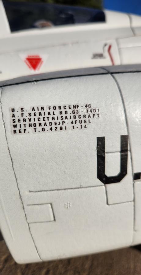

                          Aircraft I.D. panel markings were individualy cut from sheet and applied with a toothpick and glued with Future.
                          weathering is minimal as Edwards test bird maintenance crews labored hard to keep these birds spotless. Only places where hydraulic fliud leaked at aileron hinge points and elevator pivot points are highlighted.

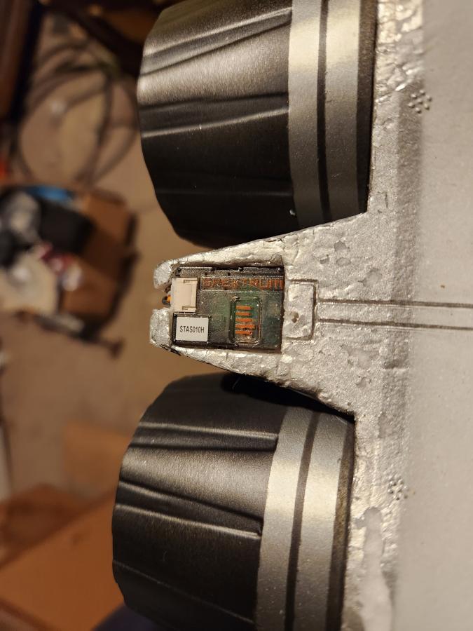

                          The fan is upgraded to a 9 bladed 3672-1900 KV I/R . A Spektrum AR8020T reciever with satellite. The satellite is installed between the exhausts underneath at rear of the fuselage.
                          I chose this scheme for it's high visibility and verifiable accurate paint scheme. Perfect for an old guy with less than perfect eyesight!.
                          Thanks for looking. Hope you enjoy this plane,
                          Spad Driver

                            SD, What a great story and a fabulous repaint with mods. She is a beautiful thing, Sir. Bravo Zulu. Best, LB

                              Thank you Elbee Sir,
                              I have loved painting my models different than what comes stock ever since I built my 1st plastic model as a kid.

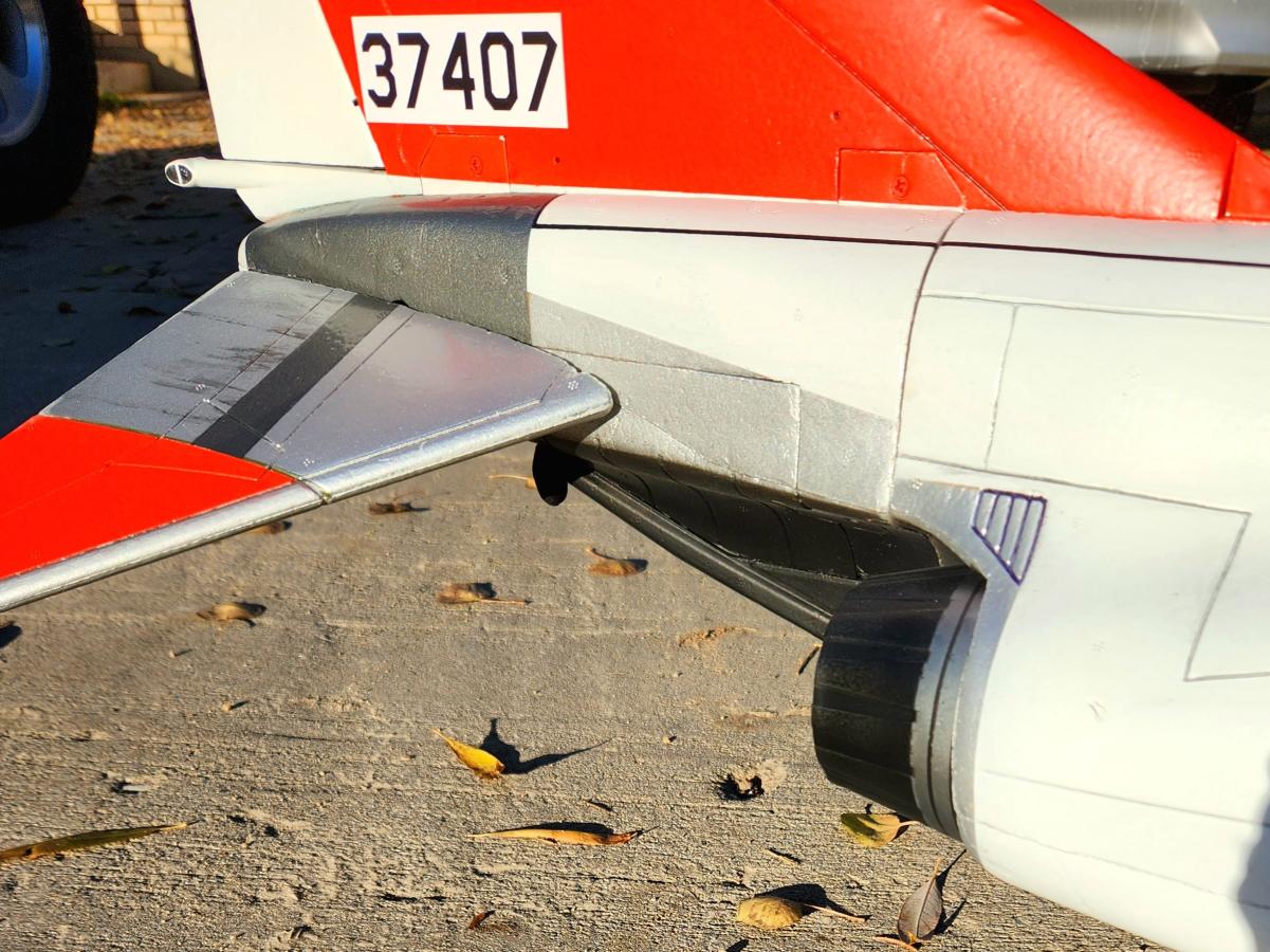

                              Would it be helpful to add to my long winded rant that I found two really close matches for the metallic colors at the exhaust area?.
                              For the bright metallic area:
                              Folkart metallic finish acrylic 662E sterling silver
                              For the dark metallic area:
                              DecoArt dazzling metallics Zinc Da339
                              No matter how carefully you mask metallic colors something has to lift!😫
                              And these two match the best.
                              check out the photo of the exhaust area by rudder. There was lots of loose stock paint that just would rub off at the slightest touch. So lots of touchup.
                              S.D.

                                    I'm a little late with the "THANK YOU's" for the photos of the Home Depot paint formulae...Sorry:cry:. The samples provided were Exactly what I needed...Thanks again!!!
                                    Bill

                                      Bill, Happy to know those colors are what you were looking for. Gary
