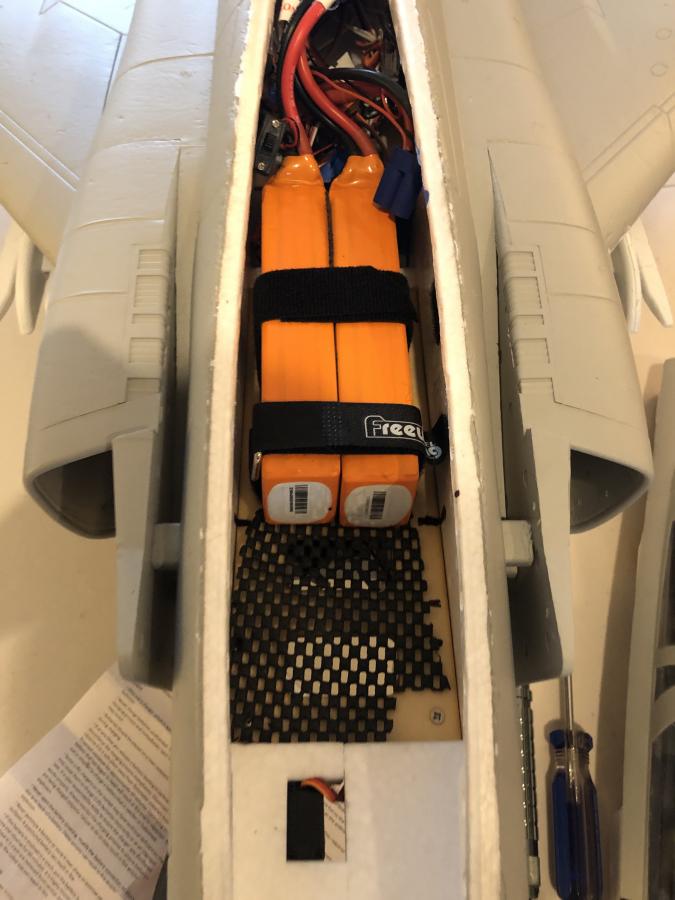

              Hi. I’m hoping to maiden my phantom tomorrow weather permitting without graphics. I’ve followed the input picked up here and my CG is just around 195mm and I’m using surface throws per the manual. I was a little surprised with the battery location to achieve the 195 CG. Does this look right to you. Thank you for your input.
              Tony

                Tonybons that looks about right. I have the stock 6S outrunner fan and stock ESC and fly at 195-198 CG with a RT 6250 mah that weighs about 798 g and the added twin afterburners giving it a little more tail weight along with 4 coats of spar urethane. You have the 8S setup so I image you have a little more weight in the tail (or maybe not since I have the AB's) and are using 2 4S batteries which probably weigh more than my 6S. I have my battery about 10mm further forward of were yours is, so with the differences, that should be OK. I balanced mine upside down with the gear extended using the Great Planes CG balance machine, so I'm pretty sure I'm at the CG I stated.
                I've learned not to guess where the battery get's placed compared to others because it seems each one is a little different depending on what you have modified. Of course the only way you'll know for sure is to fly it, which I'm sure you will have no trouble with. Carry On.

                  Thank you Hugh. I know my CG is right around 195mm but was surprised where the batteries ended up. Your info very helpful. Your profile says you are in Miami. I am in Windermere near Orlando but I’m in my Miami from time to time and I’m a member of AMPS. where do you fly.
