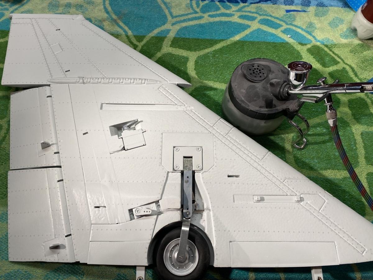

        Hi guys,
        I used the light gray from the bottom and mixed in some gray from the top. I applied the rivets with an airbrush to the bottom of one of the stabilators. The rivets are subtle.
        What do you think?
        WN, Subtle detail indeed. I think many times rivets are overdone to the point of distraction from the overall. We've all seen 1:1 aircraft and it is rare I remember the rivets more than color nuances, panels, and markings. Bravo Zulu, SIr and Happy Easter. Best, LB

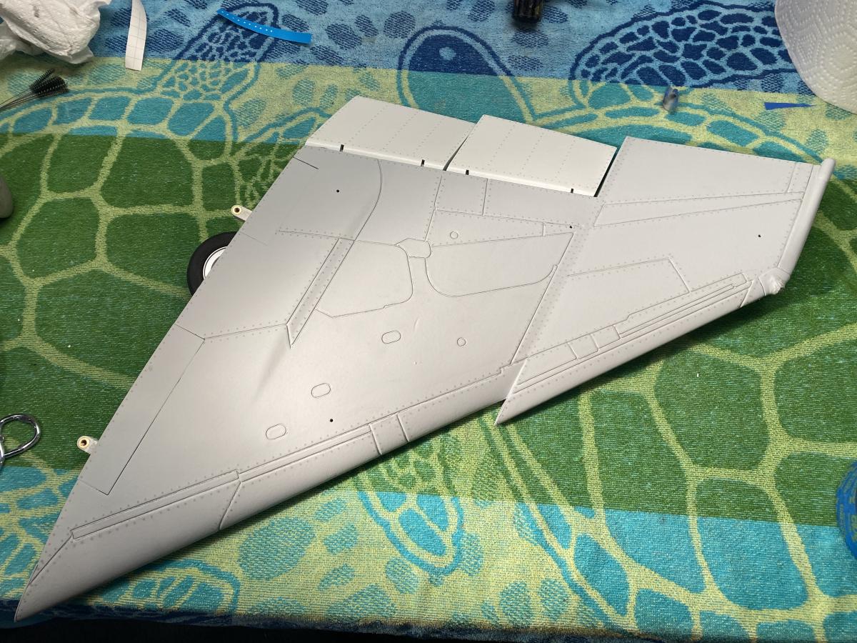

          I may regret this, it took me 4 hours to spray the rivets on the bottom of one wing panel, good thing I don’t have much to do for a while . I am going to have to cut at least one more page of rivets.
            Incredible detail, I would say the 4 hours were well spent.:clap:

                    Spent 11 hour’s airbrushing rivets today. I will be seeing dots in my sleep. The bottom side is done.

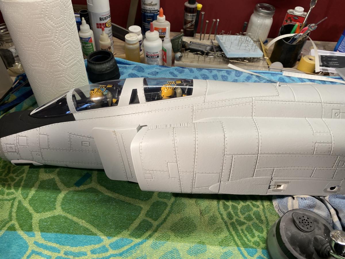

                            I have to say I have learned a lot about airbrushing in the past couple days. Air and paint flow control takes a while to learn. I am using latex in my airbrush which isn’t easy. I have found that you need to double strain the paint to keep it from clogging up the airbrush. Also tip dry is a constant issue.
                            I did get a color mixed for the top rivets this morning. The top of the stabilizers and one wing panel is finished. On the top of the wings I am subscribing to the theory less is more. There are going to be a lot of rivets on the fuselage and a lot of graphics being applied. I can always go back and add more if needed.
                              Hi guys,
                              Looks spectacular. Are you sure all of the rivets were properly installed and are securely fastened? You may want to go back and check each one again to make sure, shouldn't take more than about 18 hours.

                                I am so getting tired of airbrushing rivets. Looks like the fuselage top side will be a 2 day job.

                                    True, just monotonous as hell. After you spray the first 4,000 the rest start to get a little old.

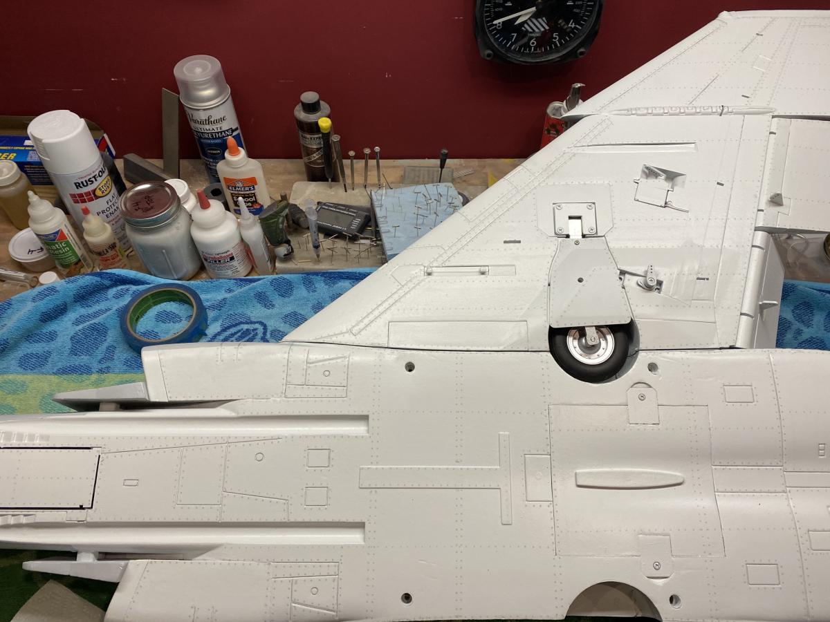

                                      WN, The detail is amazing. My thought was one way to save some time is don't paint rivets where the marking are placed, since a painted marking would also have the rivet shape. So do you add rivets over rivets once the markings are in place or are the rivets 'proud' enough off the surface to show through vinyl markings? Inquisitively, LB

                                        Hi LB,
                                        The rivets are undetectable, they will not show thru the vinyl. It would probably take me longer to lay out where all the vinyl will be going down than to just paint all the rivets. I don’t want to risk trying to paint the rivets after the vinyl is down. If something bad were to happen good luck getting the vinyl off.
                                          #4160
                                          Looks fantastic though so you will be rewarded for all the monotony.
