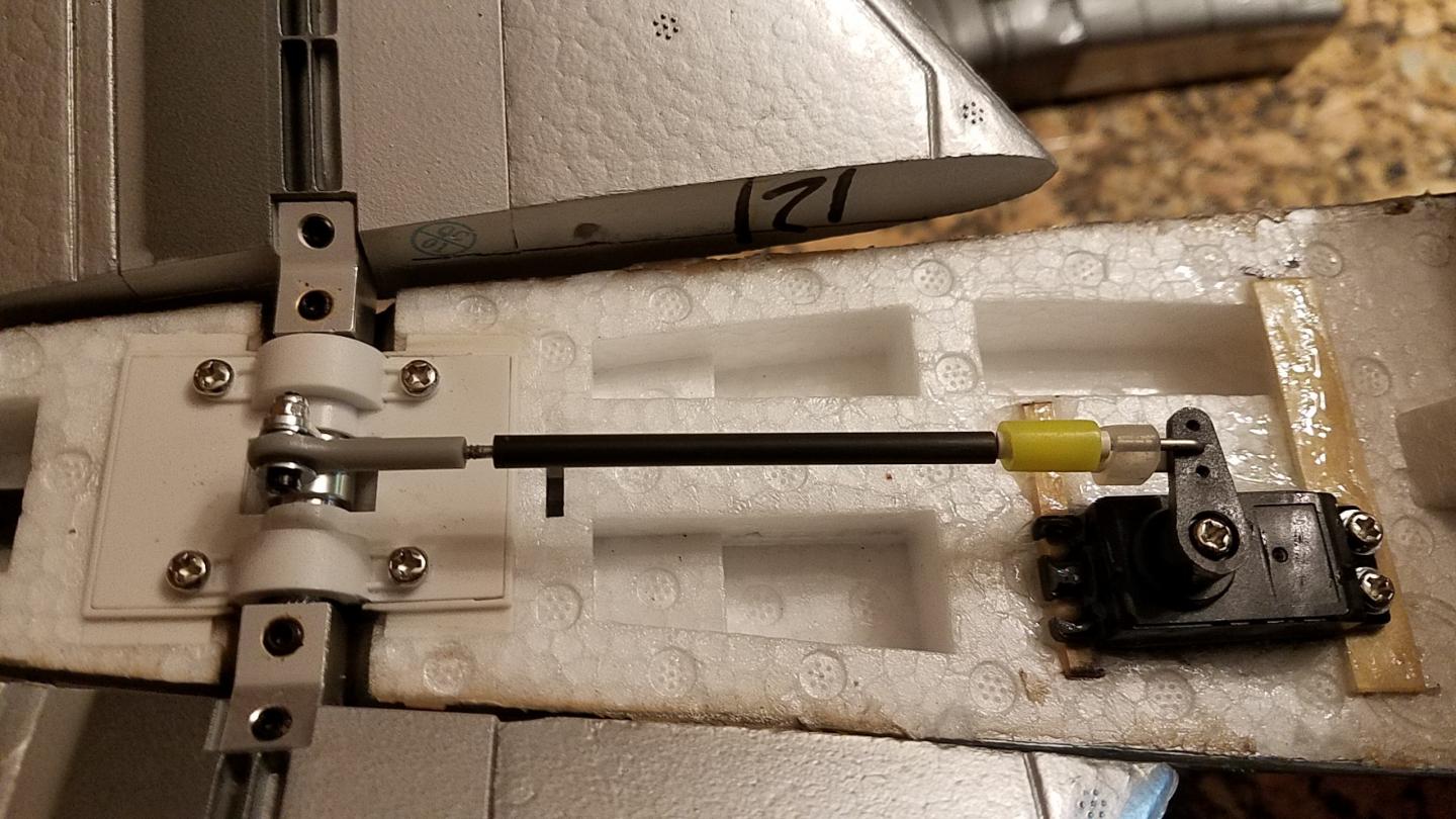

    Alright, I am ready for my maiden. I set it up by the book for CG and used MM for my rates. What are you guys running for CG? It's the 6s version. And what did you end up with for rates, elevator nuetral, and flap mix? Close to the book?

      Between here and the RCG thread we’ve all posted this. I maidened mine a long time ago at all the book numbers but believe my CG is now further back but throws are about the same. Did you reenforce the elevator push rod?

        ok, thanks. I did upgrade the elevator servo setup.

          TB, Great work on the mod for the Elevator Push-rod. Best, LB
        #4064
        Now you are good!!! Everyone needs to do that if you “Want to live”.

          What is the brand of the push rod? I find it top in size

                With all this extra time on my hands, I finished all my minor fixes and modifications to my entire fleet. The pushrods and clevises of my F4 Phantom and F4 Blue Angel were the last as I had earlier secured the servos in. Now what do I do to keep busy?
                I didn't have a larger diameter push rod to install, so I kept the FW rod and slipped a 4mm carbon fiber tube over it for rigidity, fit perfectly. All my 2-56 heavy duty ball link clevises don't fit the FW rod either, so I used the ball and clevis from some spare parts of the SU-30 for that and attached the ball with a 2mm allen head bolt and lock washer. Not as snazzy as everyone else's fixes, but it's at least better than it was before. Probably should have upgraded the servo as well, but need to live a little dangerously, and besides, if there is a mishap with the elevator, at least I have something else to blame other than the true cause of "pilot error".

                  4-40 threaded steel rod, 3mm ID carbon fiber sleeve, and traxxas rod ends.
