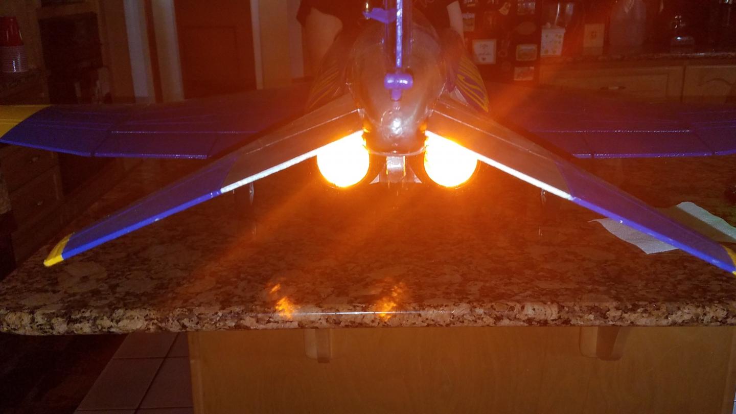

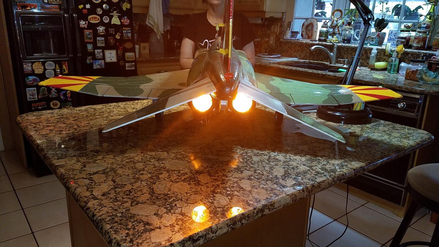

            Got the new twin cone afterburners installed in both F-4's. I thought the original single cone AB's were bright, but these seem twice as effective. So much so, that I couldn't really get a decent picture of them even at low throttle where they first come on (it blinded the camera). Although both leads can be hooked up with a y-connector to the controller, I followed Chris's recommendation and gave each a servo wire to the controller which has 2 separate inputs if desired. This gives each nozzle it's own random flashing sequence and makes it look like there really are 2 fans. The best screws to attach them with are M3 set screws, either 4 or 5mm in length. They are self tapping and fits flush so you don't have to cut off a screw head, making it much easier to remove if you need to. The M3 set screws can be picked up from Amazon if you're interested.

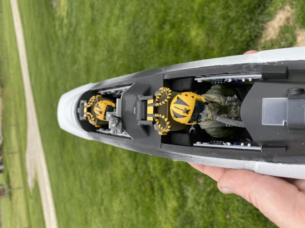

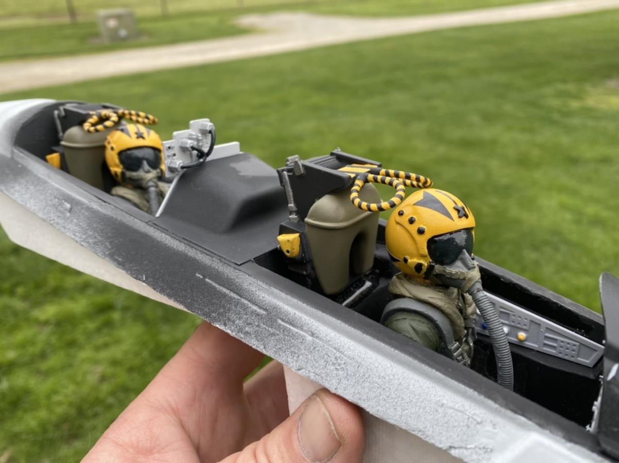

                    My pilots from JHH arrived in the mail yesterday, I got them suited up in their VF-84 colors and mounted in the cockpit. Not as good as some others work on here but I think they look good.
                    Now I can get back to work on the plane.
                    Callie Graphics BTW: I want to give a big shout out to Callie. I received my graphics for the F-4 last week. I noticed the wing walks were black with white lettering. This is fine for the camo version. I contacted Callie and she is making me a set that is gray with black lettering which is proper for the Navy version. Great person to deal with and does excellent work.

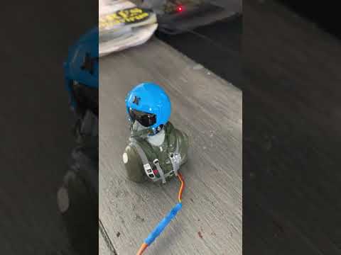

                                        • Ludovic
                                          • 28
                                          #4140
