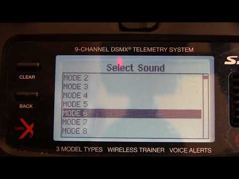

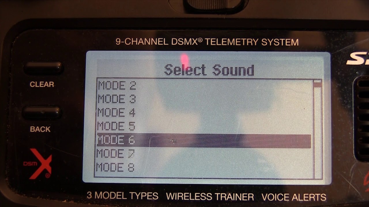

    • Found this video on setting up Flight Modes. He uses it for slightly different things not tied to the flap switch, but the theory is the same.

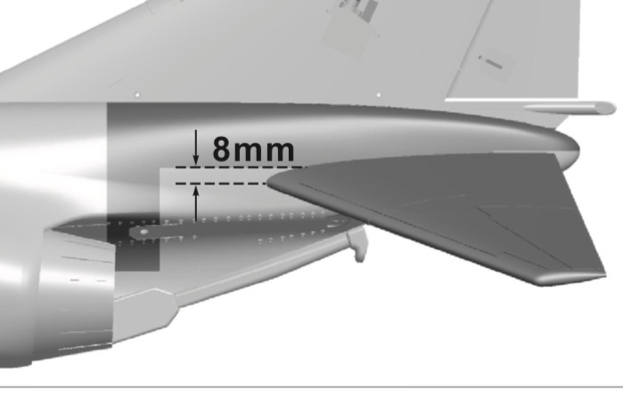

      • Originally posted by GliderGuy View Post
        Hi Davegee.....
        Pretty critical / need to get it CORRECT.
        With flaps up (no flaps)...adjust per the photo below. Then to the left of the photo the manual says....(and I am adding text for clarity)
        FULL FLAPS AND HIGH RATE 5 mm more nose up elevator (this means the front edge will now be 13 mm below the seam)
        FULL FLAPS AND LOW RATE 3.5 mm more nose up elevator (this means the front edge will now be 11.5 mm below the seam)
        Don’t overdo the mix!!! Make sure everything is the same on both sides.
        Basically, the bird pitches nose down when the flaps are lowered....so the mix counters this.
        If you have your CG aft of the manual recommendation, reduce the above amounts a little.
        -GG

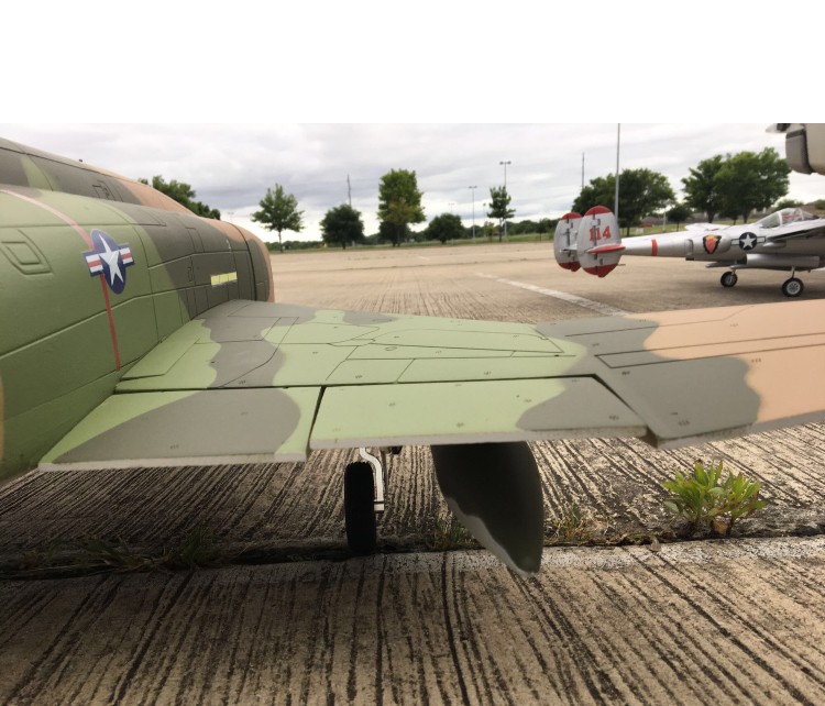

        Photo of trim setting....Flaps up
        Transmitter elevator trim slows “0” or neutral and the elevator stick is in the middle....no stick pressure applied.
        Click image for larger version Name:	B3EDC837-9283-4767-88E9-C01556C5A8E6.jpeg Views:	0 Size:	28.1 KB ID:	310605
