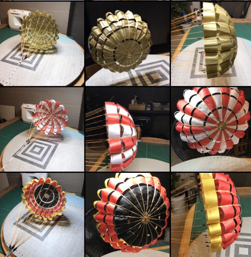

          This is the black and gold I make.

          • What is the inflated diameter?
            Can you make larger ones?
            • Originally posted by Turbine guy View Post
              The flat diameter is 17” for this certain scale model. The real F-4 chute has a flat diameter of16’. I make chutes according to scale up to 35” in flat diameter. Thanks.
              192 divided by your scale = ?
              192 divided 7 = 27.43”

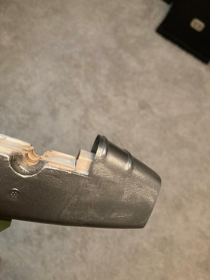

                • I have my chute mod done and ready to go as soon as I repaint the tail section to match. I have finally found a paint mixture to match the original and have sanded and painted twice. Color looks good but I am not happy with the finish around the fiberglass tail mod. The filler seems to stay porous and I can not get a smooth finish. I have tried Tamiya Basic Type Putty and Foam-Tac Foam Filler, sanded and followed with Foam Tac Foam Finish and Hobby Coat. I am using 1000 grit flexible sandpaper. When I sand, the filler does not sand smooth and hard but feels like maybe rubber and stays porous. Could someone please share what you use to fill and smooth gaps and rough areas before painting? Thanks!!
                  • paulsnapp Lightweight spackle that can be found in hardware stores, for spackling walls. It spreads well and sands well, and is light in weight. I know I've seen some you tube videos where a specific brand is recommended. RcGeek probably has a video tutorial. I believe the stuff I have used is made by dap products. There might even be an ultra lightweight. The key word on the label should say sandable.
                    • What they call performance spackle. It's thicker and dries harder than normal spackle.

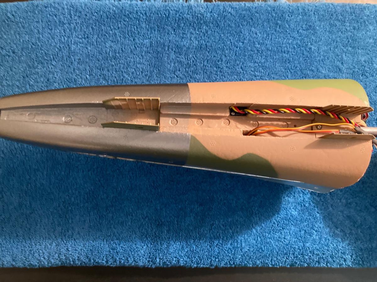

                        • I have finally finished my chute mod along with installing a beefier elevator servo, plywood elevator servo mounting, 4-40 pushrod with Carbon Fiber sleeve and a heavy duty ball link. Now I need to finish my Phantom!
