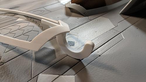

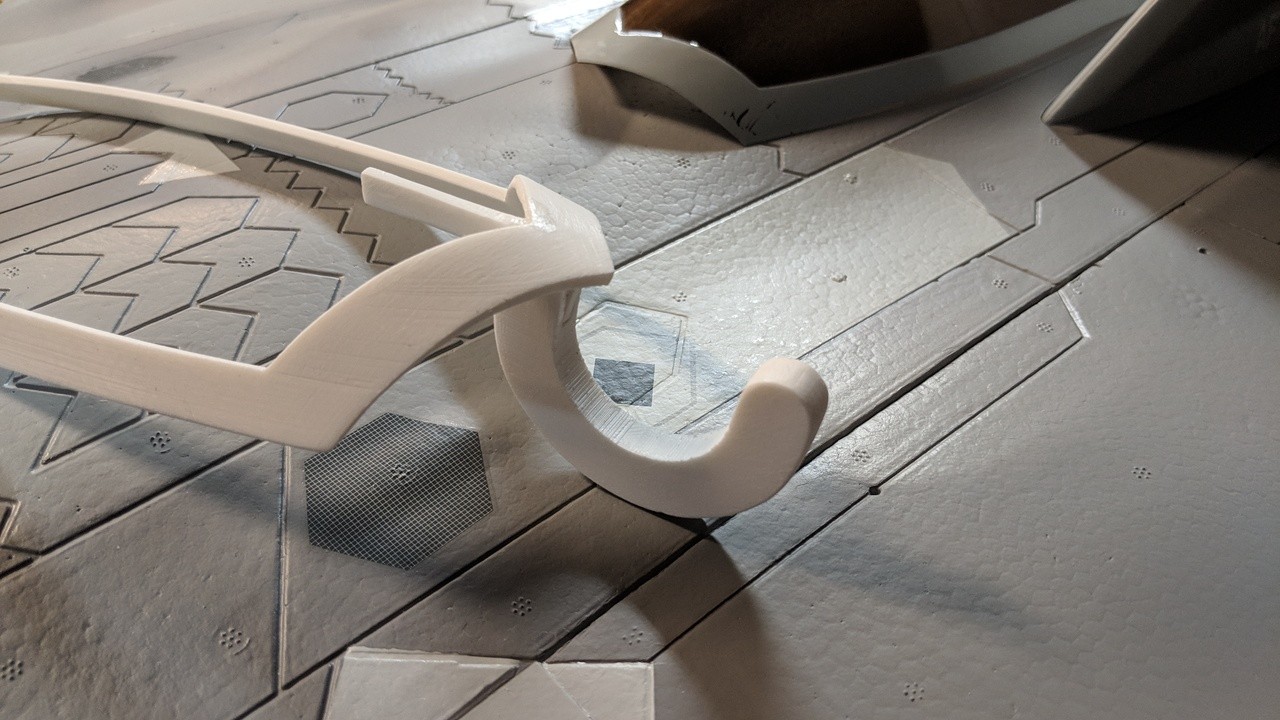

Tom, I have your canopy frame printed but have also designed and printed an arm to allow it to pivot. Here it is attached to the frame and a quick video of the basic operation. I will be designing a few more parts to be able to secure it in the hatch and then will send it to you.Originally posted by Pogo View Post

Steve, that hinging method looks really good, solving the problem of how to get the canopy up and away from the fuse while keeping the hinging strong. When you so kindly offered to make me a frame I didn't realize it would come with engineering solutions too!:Cool:Originally posted by RCjetdude View Post

Hey Tom, I gotta have some kind of idea how it will work so while I am at it I might as well make a few extra parts. You will still have to do the hard part of fitting it all together.Originally posted by Pogo View Post

Oh, for sure. Using this printed frame will be so much quicker than making one up from ply, as I have in the past. That the canopy is one piece is an added bonus on this bird as there's no front canopy/ rear canopy joint (or corresponding frames) to deal with.Originally posted by RCjetdude View Post

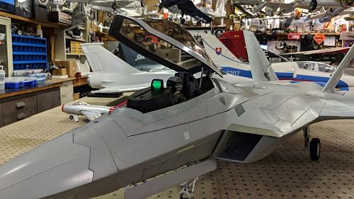

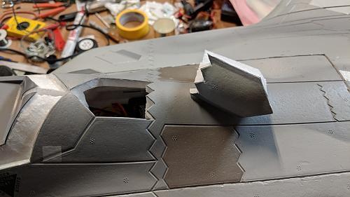

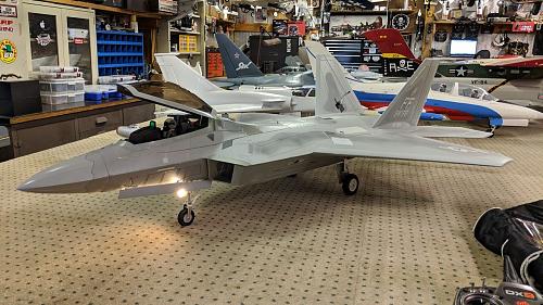

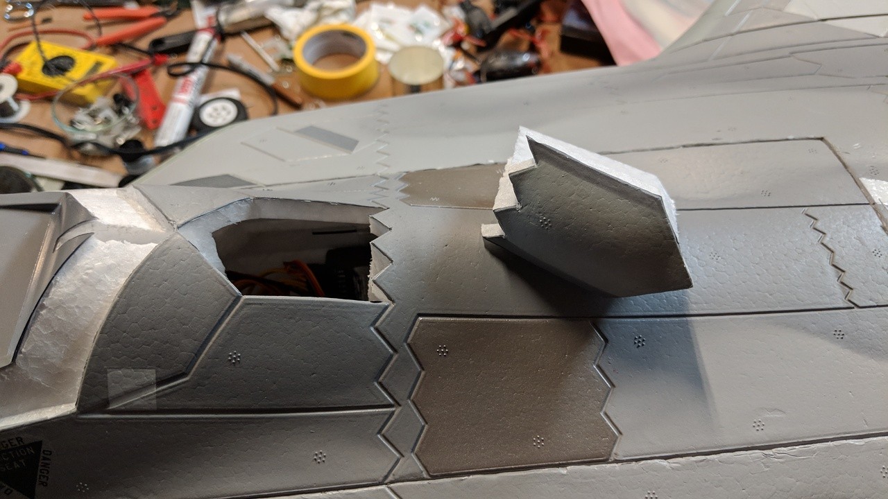

Hey Steve, that canopy frame looks awesome and, as Tom said, having the hinge design already there is super handy. Looks like you had to shave the foam around the canopy seat area to allow for the frame thickness. I too would love to have that setup when your ready to sell me one. By the way, how did you light up that green sighting mechanism? After seeing how visible that is on the real Raptor, that would add even more realism and just plain bling. Go Hawks!!

Yes, the install of the frame requires shaving some foam away around the cockpit. I then lined the bare foam with 0.010" styrene. The green HUD is not lit up but a piece of green transparent plastic I got from HobbylincOriginally posted by downwindleg View PostHey Steve, that canopy frame looks awesome and, as Tom said, having the hinge design already there is super handy. Looks like you had to shave the foam around the canopy seat area to allow for the frame thickness. I too would love to have that setup when your ready to sell me one. By the way, how did you light up that green sighting mechanism? After seeing how visible that is on the real Raptor, that would add even more realism and just plain bling. Go Hawks!!
