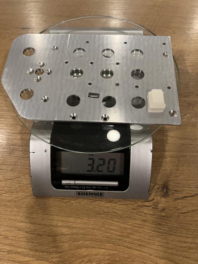

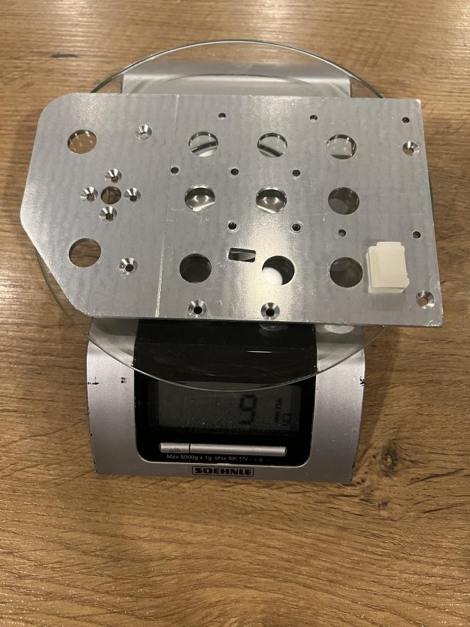

        Steve,
        I am referencing the OEM aluminum "rear fuse plates" that you replaced; what is the total weight of the PEM plates?
        I have thought about replacing those with carbon fiber plates if there is there is a sufficient weight difference?

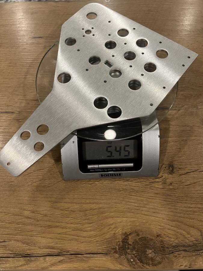

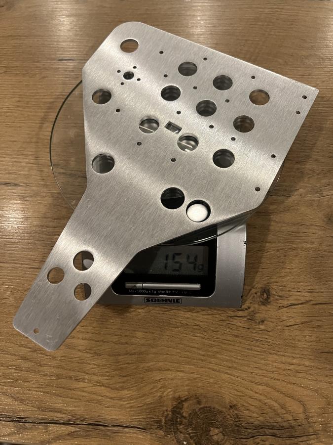

            LB,
            see attached pictures for original plate weight and the modified plate.
            Original plate - 91 grams or 3,2 Ounces
            modified plate - 154 grams or 5,45 ounces
            many people have flown these plates. the Tomcat can take the weight, especially with the latest power units installed.
            I don’t believe making them out of carbon fiber is easier - the lamination and baking of the Carbon must be spot on,
            remeber these two plates is everything that holds the wings to the airframe.
            just my two cents worth.
            more pictures soon…

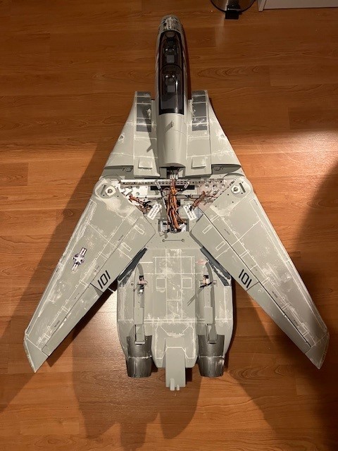

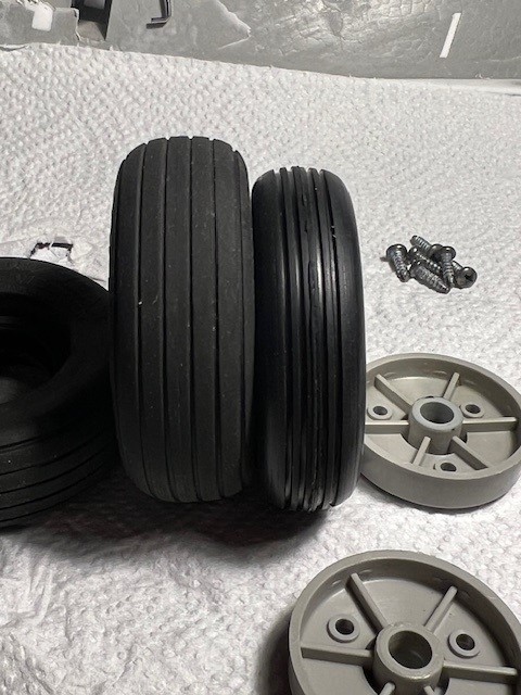

                                • @Elbee,

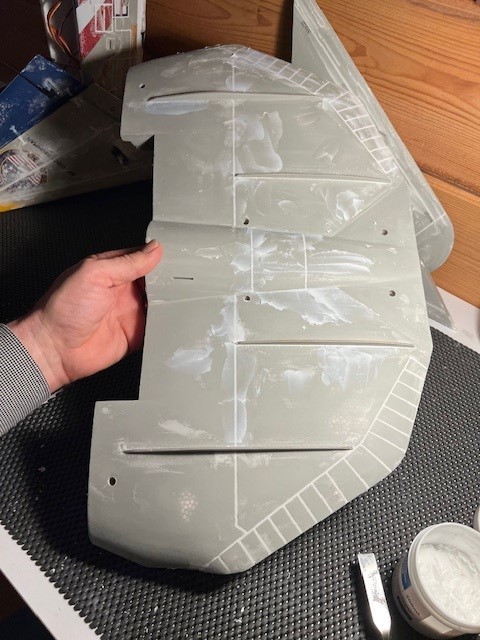

                                  Here are some pictures of the prep work for the finish of the Tomcat along the lines of Chris (RCgeek), i.e. filling panel lines, poly coating and basically cleaning up the airframe.
                                  I also changed the wheels for fatter, softer, more scale dubros. They absorb landings better and generally look more scale on carrier planes (no weight added).
                                  It's many hours of hours filling sanding filling sanding work, but worth it.
