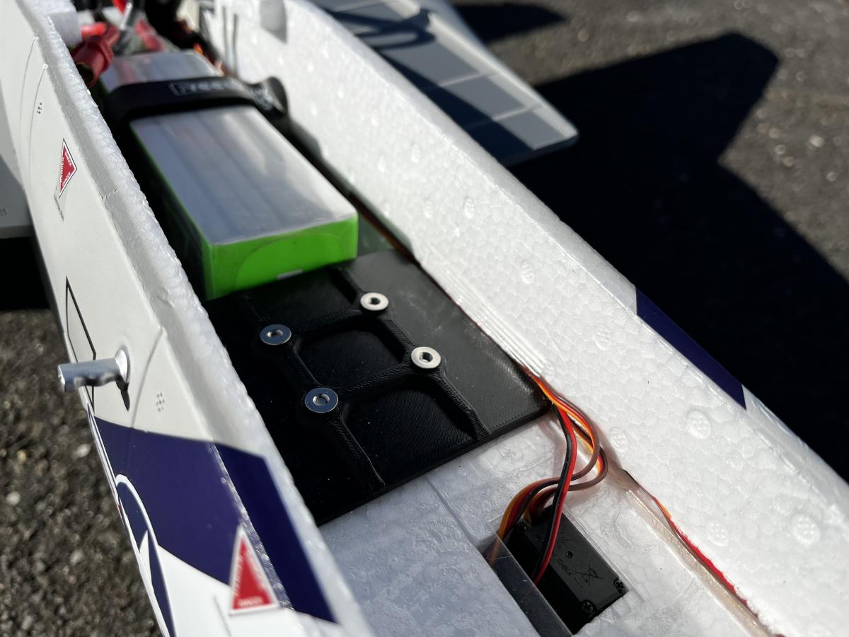

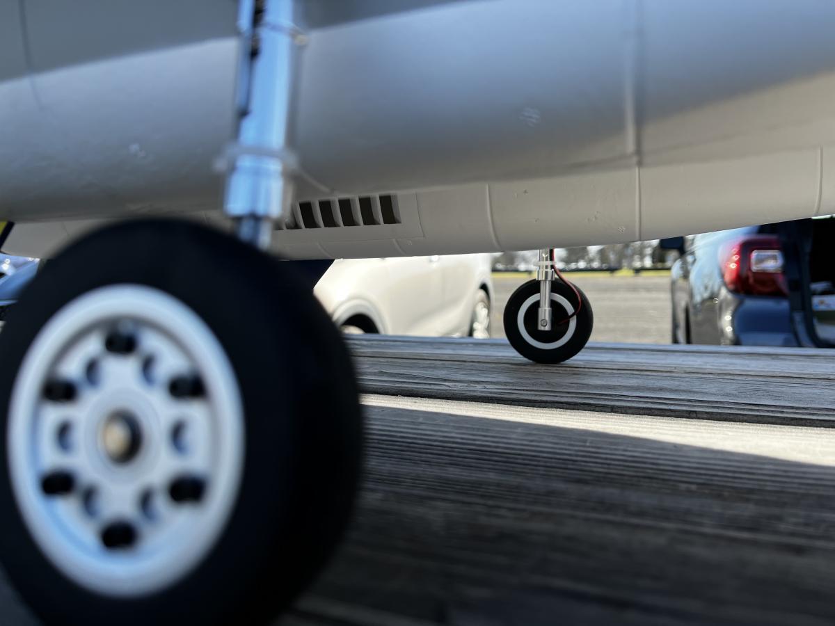

    I’ve finished the non-cosmetic portions of this build. I’ve done the wing box modification, as well as the battery tray and nose gear reinforcement plate from Thingiverse. The two upgrades I placed the most thought in were the power system and how to get this jet to stop, so I went two routes on that: adding thrust reverse and magnetic brakes. I’m really underwhelmed by the effectiveness of the thrust reverse, but it’s a means of adding some resistance with no weight penalty, so I could see why some might opt only for that. The magnetic brake setup is really effective for the small weight penalty. Given these wheels are only a few ounces heavier than the stock wheels and very near the CG, I wouldn’t go any other way. Here’s a video to show what can be done; it’s easy to see that spooling up the throttle with the brakes on is a great way to use as little runway as possible. And to see that I’m able to accelerate to roughly 30-35ish MPH and stop in such a short distance is really encouraging. These are the 65mm magnetic braking wheels from JB Hobbies, I got them from Efflux RC.
    There is a slight uneven braking which is happening, but that should just be accepted. I purchase an Assan AG63 pro as a possible means to solve this but quickly found it to be unreliable and pulled it out. I may end up with something fancier in the future, but for now I think this will work fine and if necessary I may just add a nose-wheel gyro.

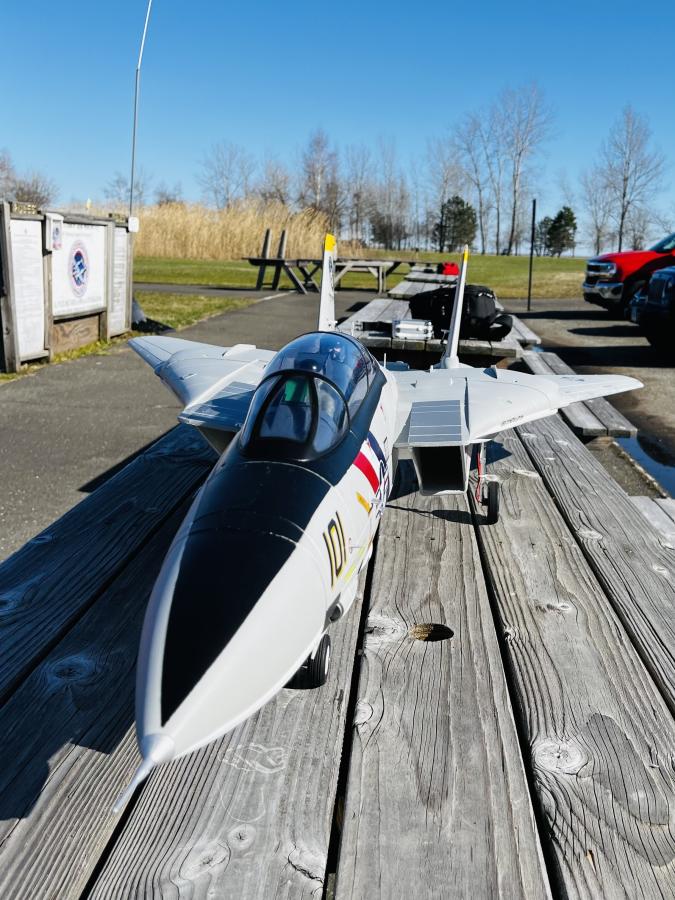

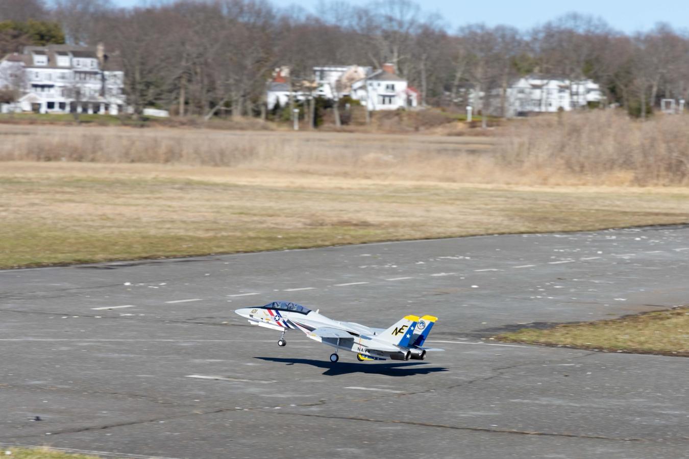

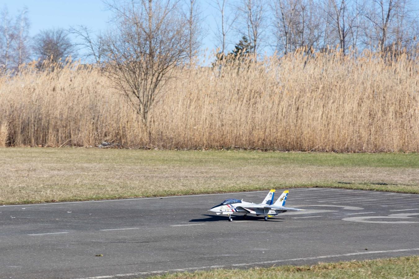

          It has flown! And it flew well :).
          I was very lucky both to have my RIO with me, as well as having friends who came to take photos and video. Here are some photos of the afternoon!
          • Looks good! Congrats!

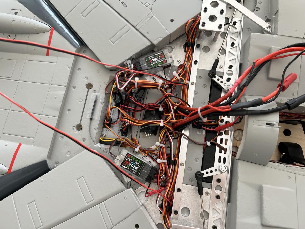

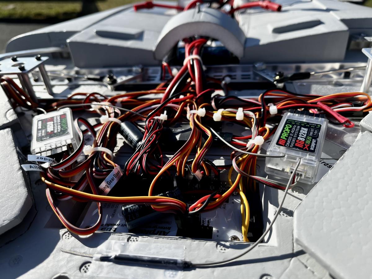

                      Yeah for mine I needed 14 channels. In the photo you see the controller and the two cables I’m holding are the brake lines.
                      One of the benefits of the DMSS receiver setups here was being able to neaten and split cabling using the RG812BX (ch. 1-8) and the RG812BX-B (ch 9-16). In the photo you see the cabling and the brake controller in the center, I’m holding the brake lines.

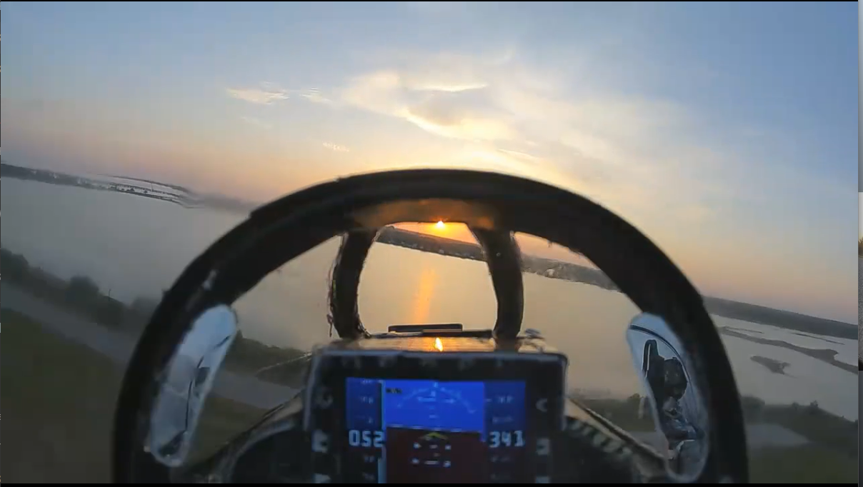

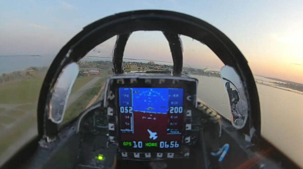

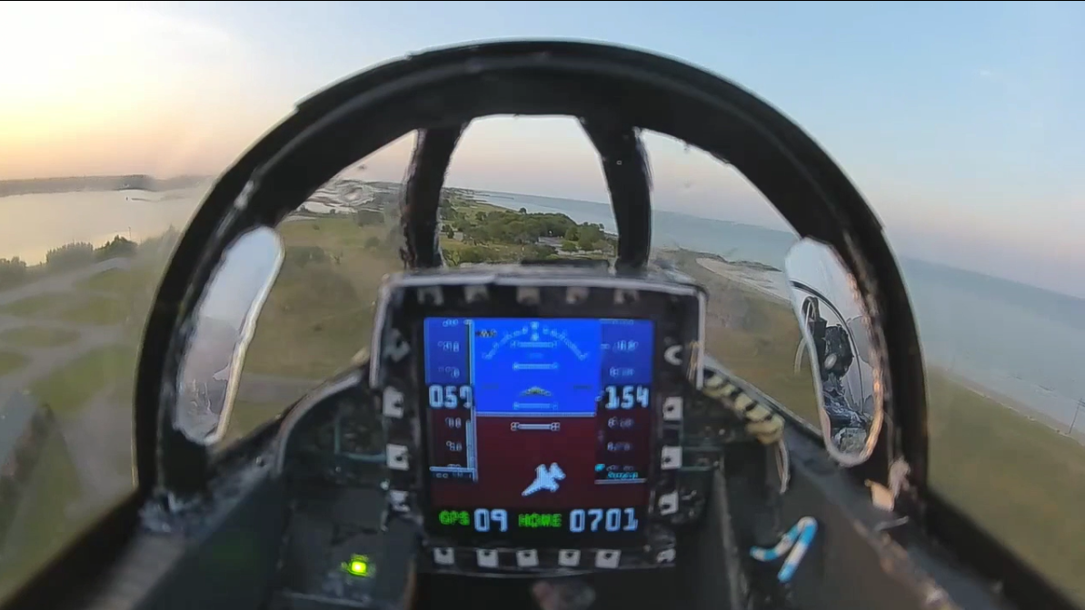

                              • got the FPV bird airborne on Thursday.
                                • more shots from the maiden
                                  • Originally posted by latebloomer98 View Post
                                    LB, beautiful picture, very cool. Best, LB
                                    "You just need the will to do what the other guy wouldn't."
                                    ~Keyser Soze~
                                    • latebloomer98 You're cockpit looks badass, and you're flying location looks pretty spectacular from the cockpit! From the photos it looks like a Tomcats natural environment, very cool.
