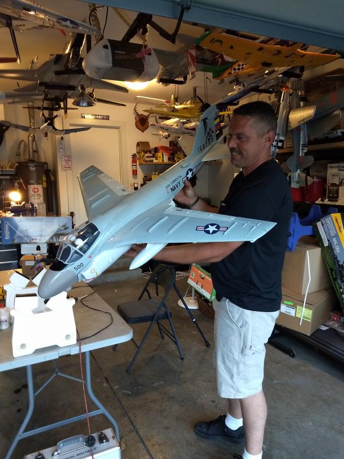

ID:	131823 A-6 Intruder built tonight with some help from my bro Justin K. Maiden flight this coming Sunday. Bajora, would love to have you there Sunday morning for her maiden, keeping you in the loop sir. GOOSE

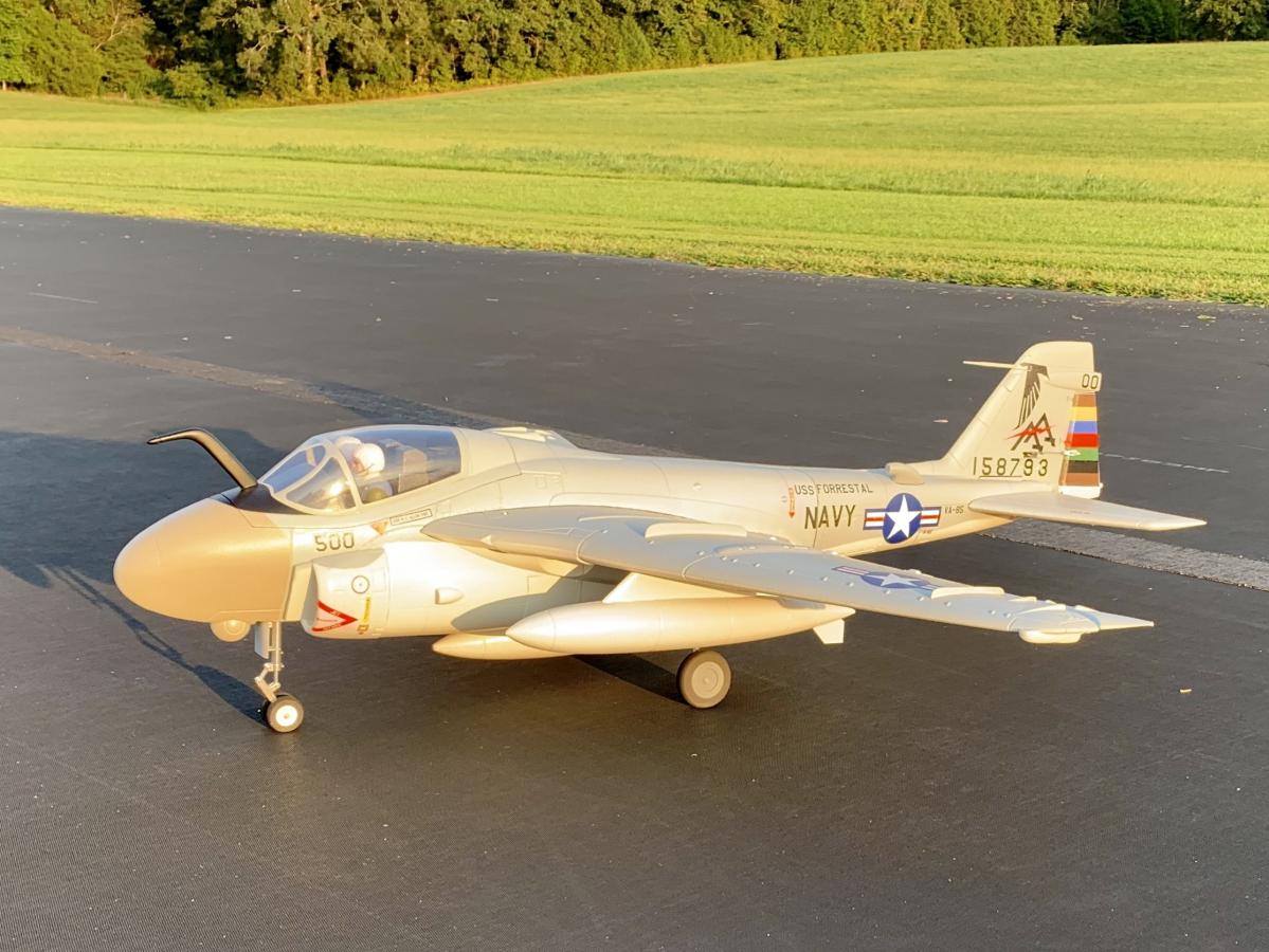

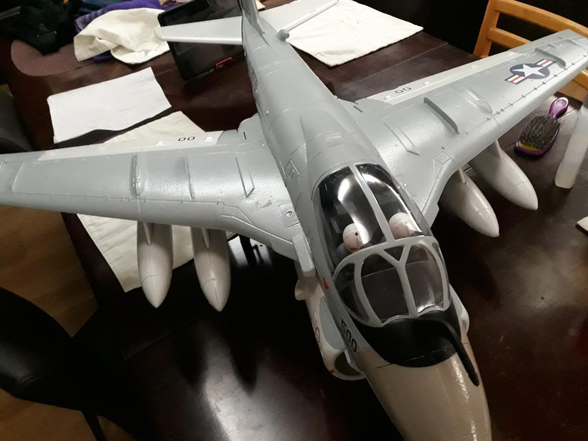

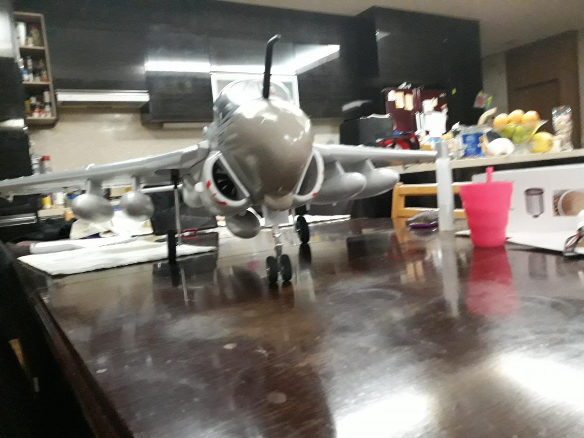

            About to maiden mine this weekend, grabbed an extra set of tanks since they no longer carry the bomb option. So I've turned mine into a tanker! Gonna see if the extra belly tank will look ok on my 80mm A-10.
              #66
              Looks good, Phantom! Draggy but pretty when all loaded up!
              • Phantom
                • Mar 2019
                • 504
                • M.D.
                #67
                I have some high obstacles to clear in final where I fly at so the more drag the better, atleast on the maiden. :Cool: I slapped everything I could on my 80mm A-10's maiden and she still carried too much speed, I had to do two go arounds on her maiden. Now I just fly her on the rails. Ya just have to learn how a plane lands first, at my field before you feel the speed. Because touchdown location is everything for a successful flight.

                        Well the maiden went well, she took off easily cruised around at half throttle, there wasn't much difference in speed from half to full throttle with 5 tanks on, but I look forward to flying it next time with just bare rails. One thing I noticed, even with the tanks on, she floated in ground effect forever! Got to find the throttle setting, to still land with power, but not drop or float forever. Oh well practice, practice practice.
