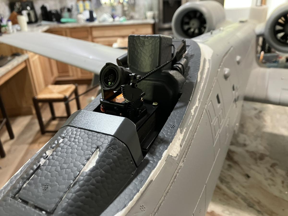

                        So guys who fpv, what are the odds of fitting 2 motionsic units in this bird side by side? By some of the pics on the website, looks doable.

                            #173
                            This is the unit in the A10. The unit has a servo box underneath it that may make it impossible to fit in the A-6. Give me a day and I’ll measure that box up and post.

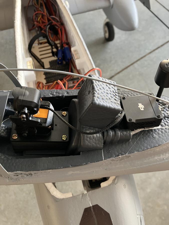

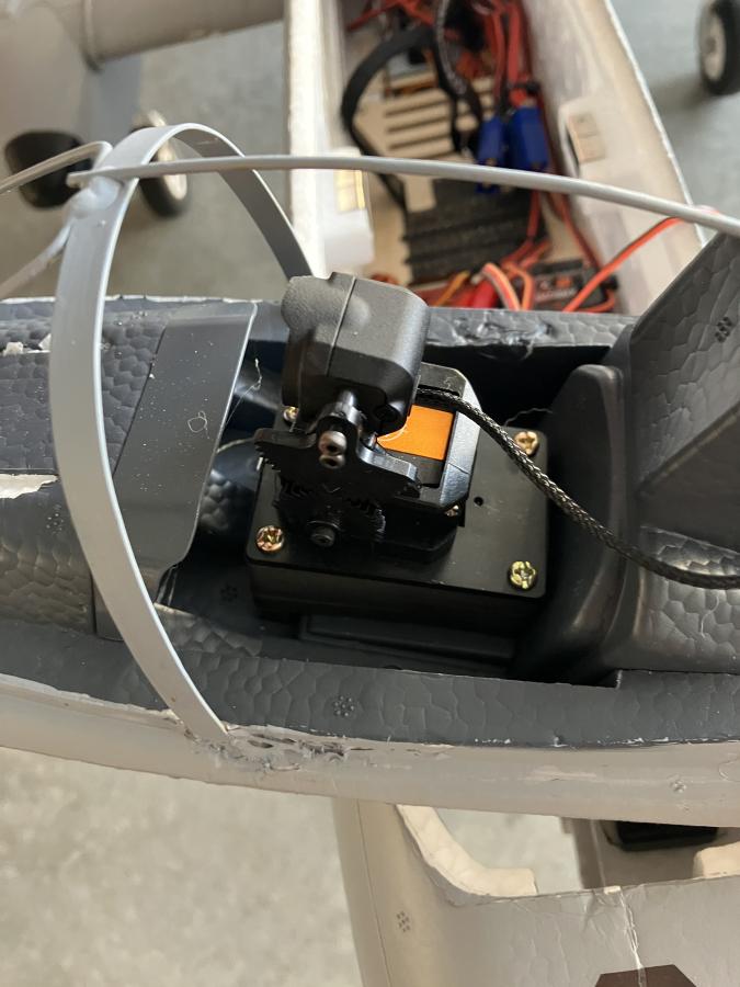

                              #174
ID:	382321Click image for larger version
ID:	382320 Based on my observation you will have room for two let alone one.
