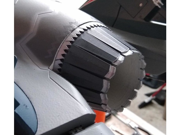

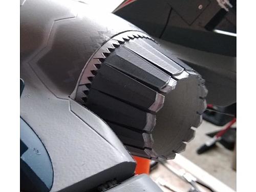

    I have been flying mine a lot, for a small, simple jet it has great presence and for me no bad habits. With Gooniacs Fire Booty it is my most impressive afterburner too. I fly it on a 4000 mAh pack and get 4 minute flights. I haven't done anything with spoilers or flaperons, it lands and takes off just fine. I do have a gyro in mine, the one MRC sells for $22.
    You can improve the looks by replacing the cheesy foam nozzle with this one:
    https://www.thingiverse.com/thing:4660791

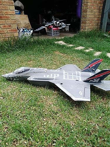

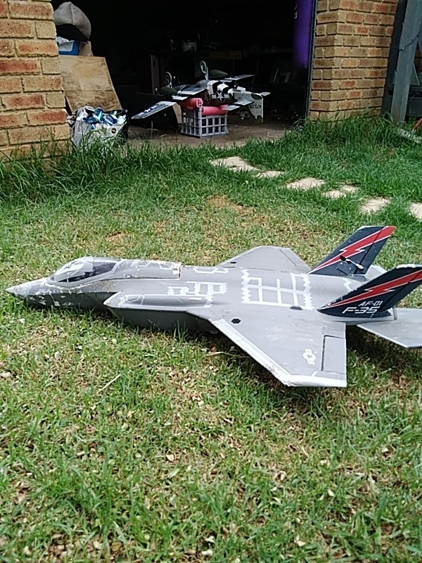

    Well done husa i stuggled with mine,, im nervous to fly it again.. but i dont like trailer queenx,, so sure i will .. just wana beat it.. last time i flew it i tried to slow it down to much,,, ouchClick image for larger version
ID:	338782 a pik in its beat up a bit shape..
