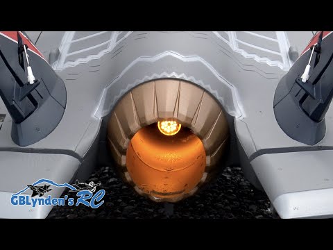

    Here it is with the Gooniac Fiery Booty installed. This was my first attempt at flying it with the AB and I learned a lot from it.
    Thanks for posting GB!!

    The Firey Booty is usually much brighter than that. Are you sure it's connected up right? Also some ultra-white paint or reflective tape inside the nozzle will make it brighter.
    It has a lot to do with the camera too. Especially with those sky conditions. The contrast makes it hard to get things to show as your eyes will see. It does help quite a bit with white paint in the thrust tube!! I am going to be rebuilding a monster of an F-35 in the coming weeks and will make the thrust tube white and tail cone the proper color as well...

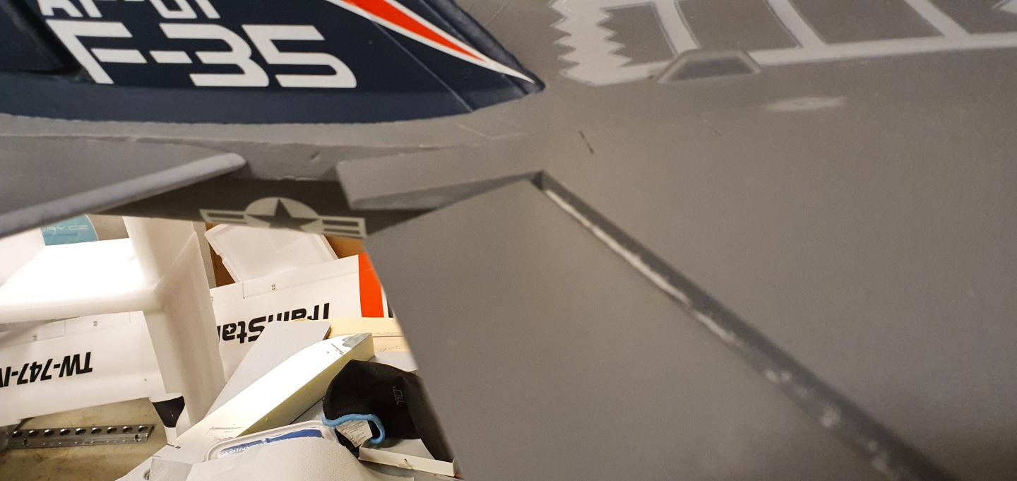

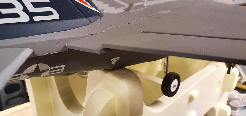

    Here is my spoilerons and flaperons. What do you think?
    Should there be more movement and does they need mixing with up or down elevators Click image for larger version

    Easy with a Spektrum - set the wing type to "flaperon" and then just use the flap system to make them go up instead of down.
    Yes agreed... but he is using a different radio... so not sure
  • kallend
    Its the same as slaperons but the surfaces go up instead of down. Not sure how to do it on that radio but you will not need to use that much to get the desired effect.

    Can u guys tell me how to do spolerons
    What kind of radio system are you using? You should have some sort of option under plane type etc..
    I'm using spectrum as soon as I get time I can post the travels I said I would this weekend along with the setup details.

    I use spoilerons with my f35 and it's amazing. Let's you pull some nice high alpha flybys an landings.
    It's quite stunnig how well spoilerons work with this!!¡!!
    Yeah its pretty amazing how well it can work! I spent quite a bit of time figuring out how they work with my sky surfer back in the days and also had a pylon racer that would not slow down at all until I decided to try spoilerons on it. Once I did it would slow down to a crawl to land! From my own experience using them makes the plane much more controllable with the nose up and makes is almost impossible to stall. I will have to try it out on the F-35 too but use the spare channel for my afterburner at the moment. Maybe this new airframe will get the spoileron treatment. I use the LemonRX 7ch with gyro which should make it even better....

    Interesting. How much up movement fo You use?
    I'll have to get the F35 off the wall and toss a battery in to measure it for you. I'll try and do that later this morning / today then i'll get it posted up for you.
