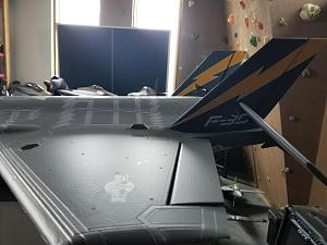

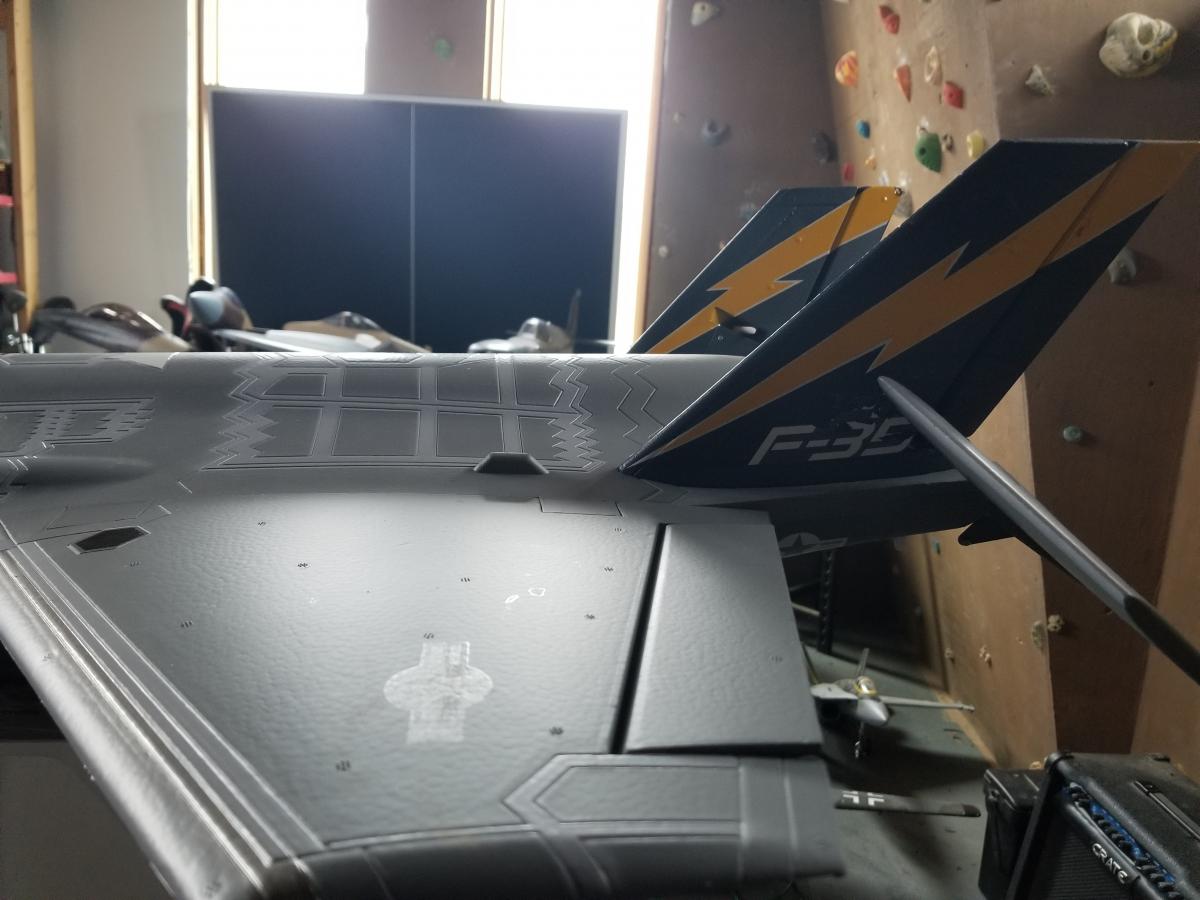

    Ok, it is the A variant wings and all, but a touch of spray paint helps to pretend it's the C. Click image for larger version

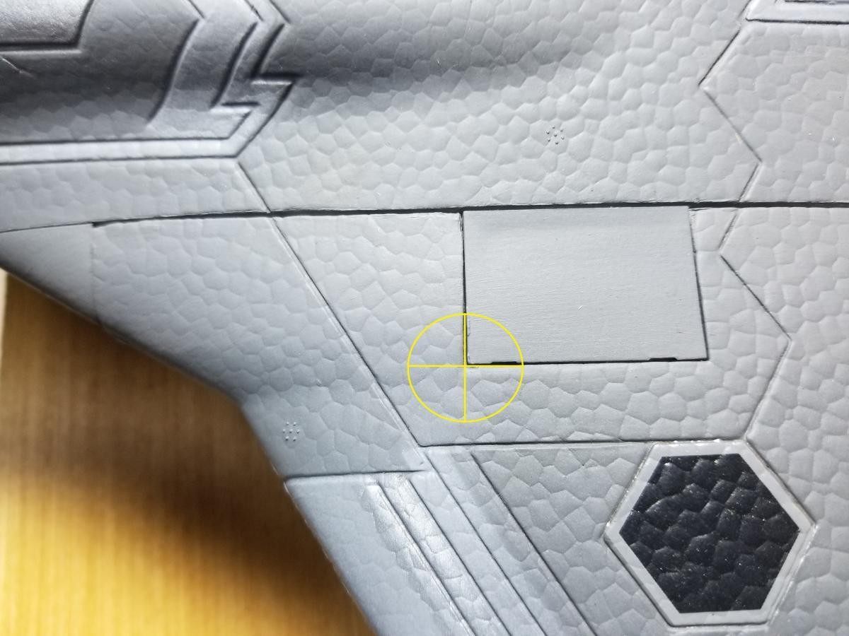

    Be very careful of aileron travel i would think 5 too 8 mm travel to start go from ther.. fun plane to fly.... icut 1 inch,, 25mm from internal part of aeilerons.. glued it to wings .. i have since increased travel,,,, more roll control,, 4 me... pics previous on this thread

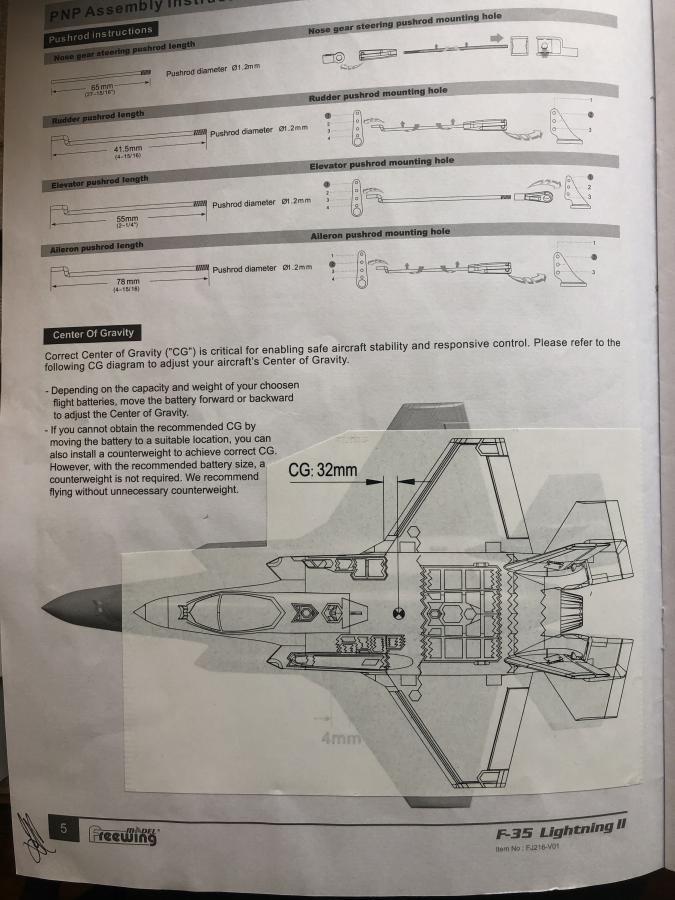

    Originally posted by F16fan98
    Quick question, does anyone know of the proper CG in the Freewing 70mm F-35 V3 (2019 Version)? I'm using an Admiral 4000mAh 6S 22.2V 40C LiPo Battery. Should I move the battery back towards the edf? Any help would be appreciated!
    Here is the revised CG Taken from the manual F-35 V3
    The CG was revised after the original manual was put out. Go to the product page "support" to see the new CG. As for where to put the battery, it doesn't matter what battery you're using. CG is CG. It goes where it needs to go to balance the plane.
