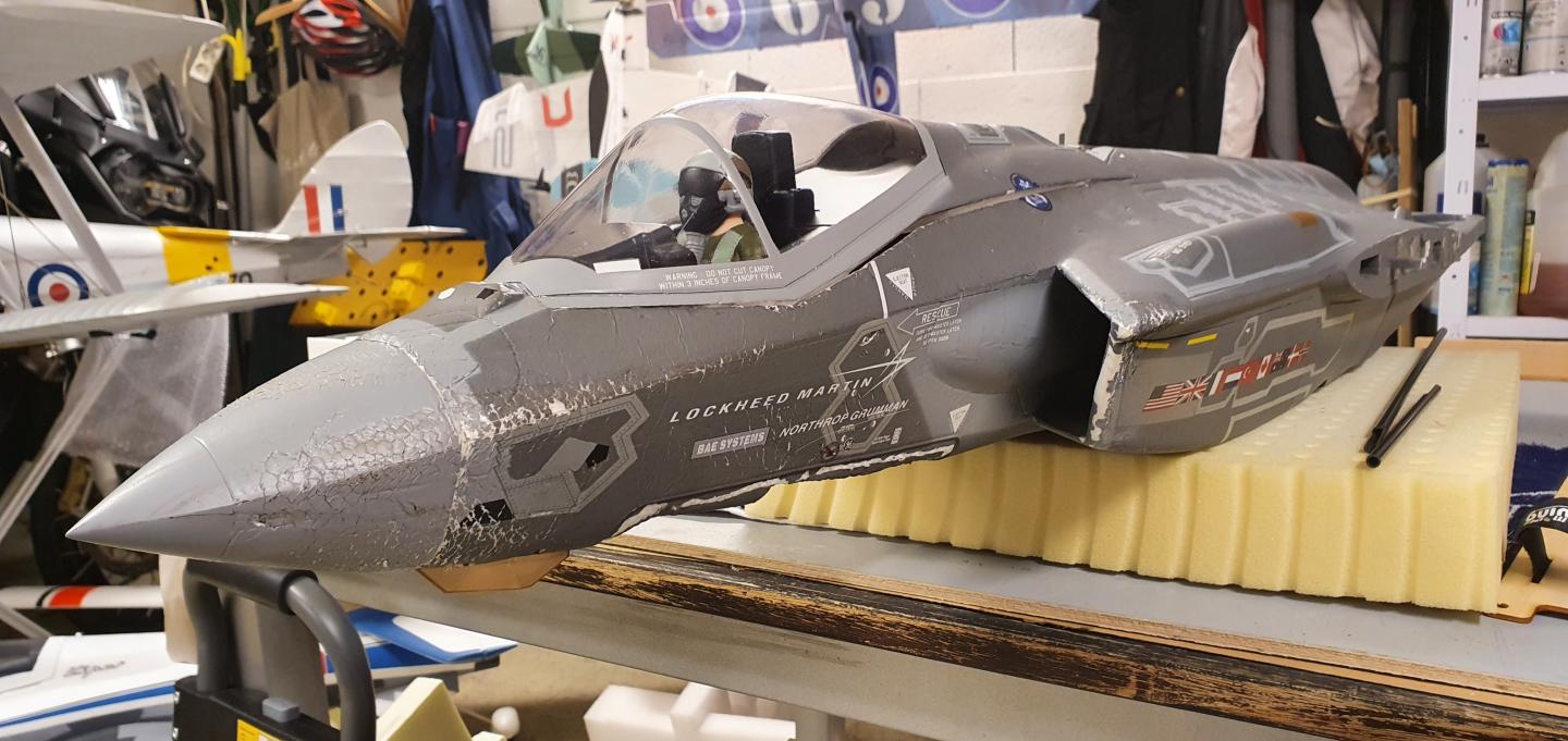

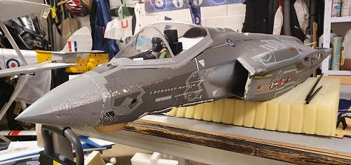

    I have a Badger 150 airbrush, and at first going to use some Wonderfill to smooth wrinkles. Click image for larger version

  • f4u ausie
    Sorry but unless its major repair. Use a brush. .... Ads to the. Weathering effect
  • f4u ausie
    I have repaird mine more than i would like to admit. B4 my new fuse. I paint cars 4 a living. If u buy black and white paint. And mix. About half and half. U will b close. Ad either as req. ..... Acrylic paint is good with a fifty percent thinner
  • Tilehtin
    Can someone help me with the colour codes of my F-35?
    Have to make some fix paintings after a bad flight.
    I'm going to airbrush it.

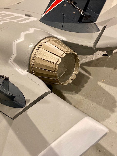

    Originally posted by kallend
    In case, like me, you need tailweight to move the CG back to where you want it, I created a 3D printed nozzle to replace the foam one. It weighs about 60g (depends on the printing parameters). It is also more accurate.
  • kallend
    STL fie is at:
    https://www.thingiverse.com/thing:4660791
