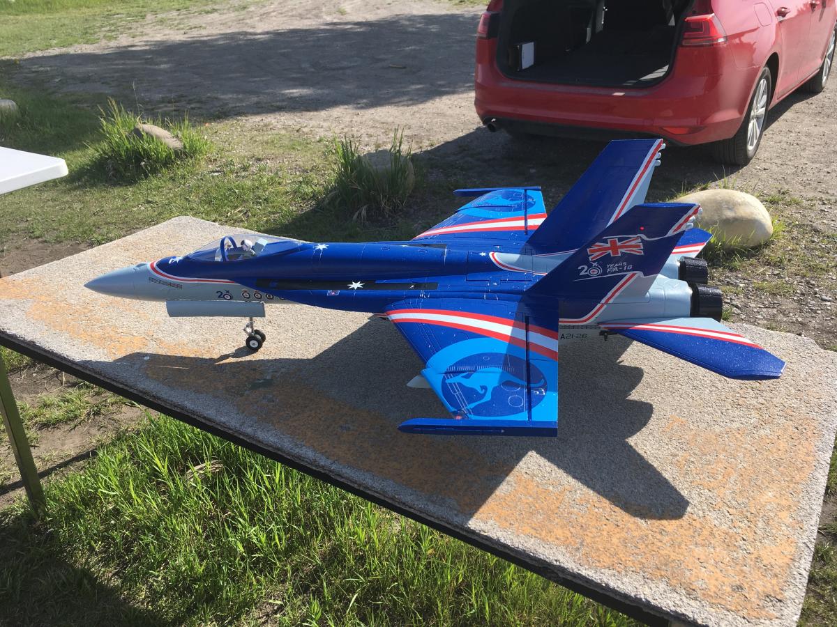

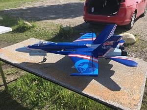

    Hey, man, I love you Aussies. One of my most favorite vacations ever. I even have an F/A-18 in the OZ RAAF theme. The only thing lacking with this F-35 is a similar livery.
