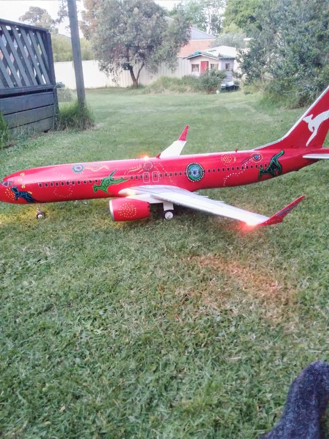

    Hey guys hope u r all safe an well....... im getting more adventurous in my endevours. 8s on f4 cooool thing,, anyway ,, 3 minuts not long on this thing so made myself a parralel xt90,,, 2 5000 mah givs 5 minuts or there.... the hrb 6000 is 820 grams,, the 2 5000 hrb 5000 1400 grams.. i no i will need to keep speed up,, but was interested if anybody had done similar things im hopeing so.... maybe 2 4000 better,, looking 4ward too some advice slash guidence:partying_face:

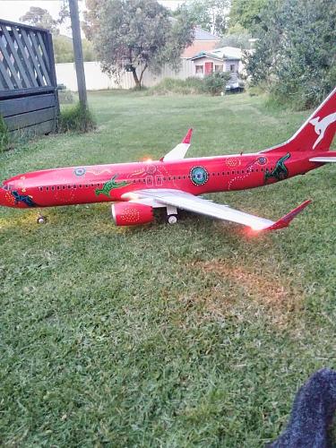

  • f4u ausie
    No probs 4 me also,, around 12 flights.. keep up the speed in turns,, on take off.. mine is unmodified. HAS NOT LOOKED LIKE DROPING A WING hav fun bsafe Click image for larger version
