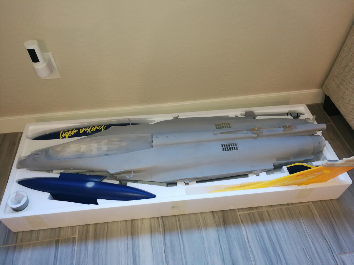

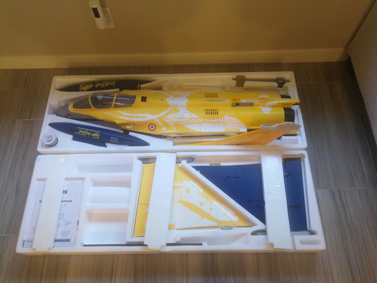

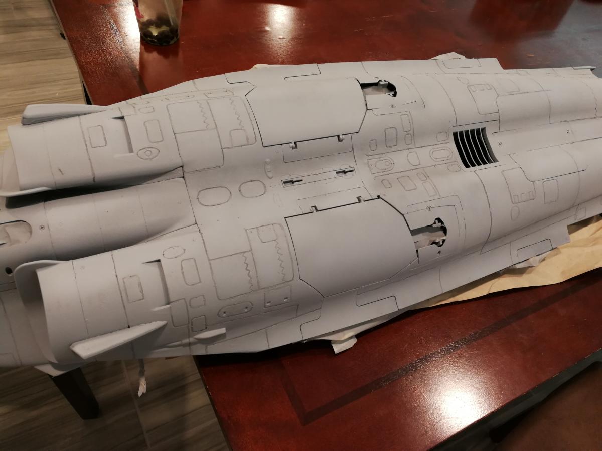

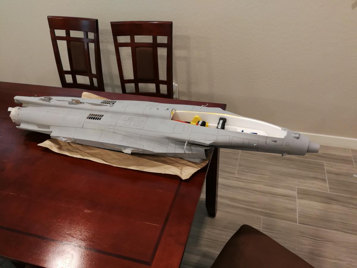

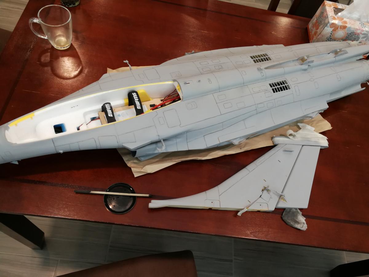

    I just can't stand the factory paint scheme so ended up repainting mine. I want my war-birds to represent front line fighters, not some airshow plane. Spent the better part of the afternoon painting panel lines. For base gray I used Tamiya gray surface primer spray can. Panel lines are done with Tamiya acrylic flat black. Still WIP.
    I really wish MRC can bring back the original Mirage 2000 without the Tiger Meet.

      Looks nice, makes you wonder who was thinking that more people were going to like that stock ugly yellow scheme over a real front line fighter scheme...

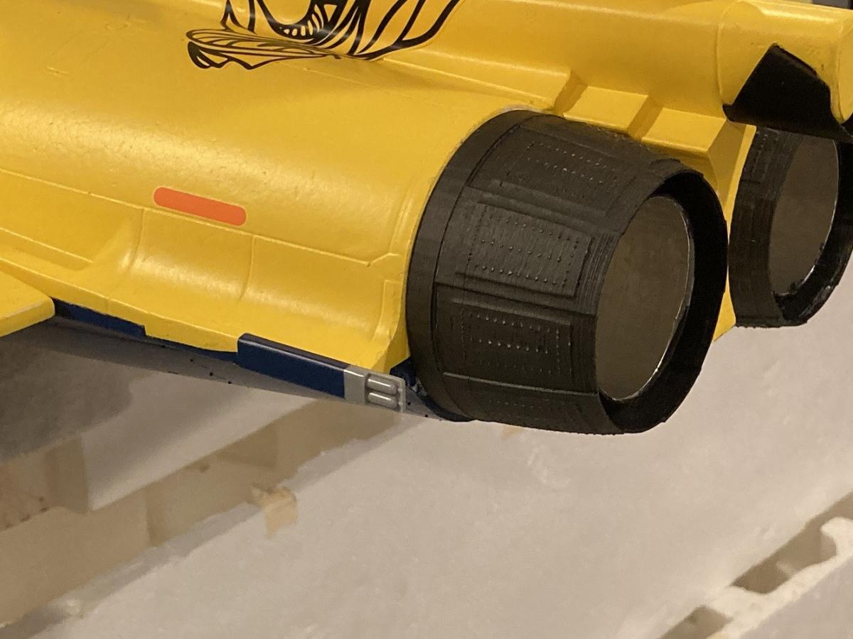

                            I've been challenged to produce an afterburner to fit in the confined space behind the motor, and new (3DP) exhaust nozzles.
                            So I ordered one today.
                            What exit diameter for the nozzles would be appropriate? I was thinking 50 - 52 mm or thereabouts.

                                      Here are the 3DP nozzles I designed. Exit diameter 52mm.
                                      Measured static thrust 2.7kg at 102 Amps peak current, Gens 5,000mAh pack at 18 degrees C.

                                          I have also posted some nozzles with 100% FSA (as well as looking better than the stock nozzles). They give a modest thrust improvement.
                                          https://www.thingiverse.com/thing:4827133
