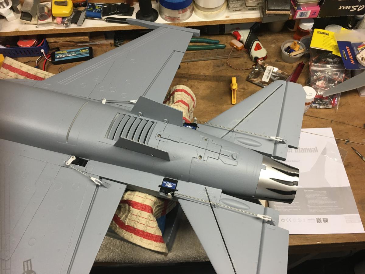

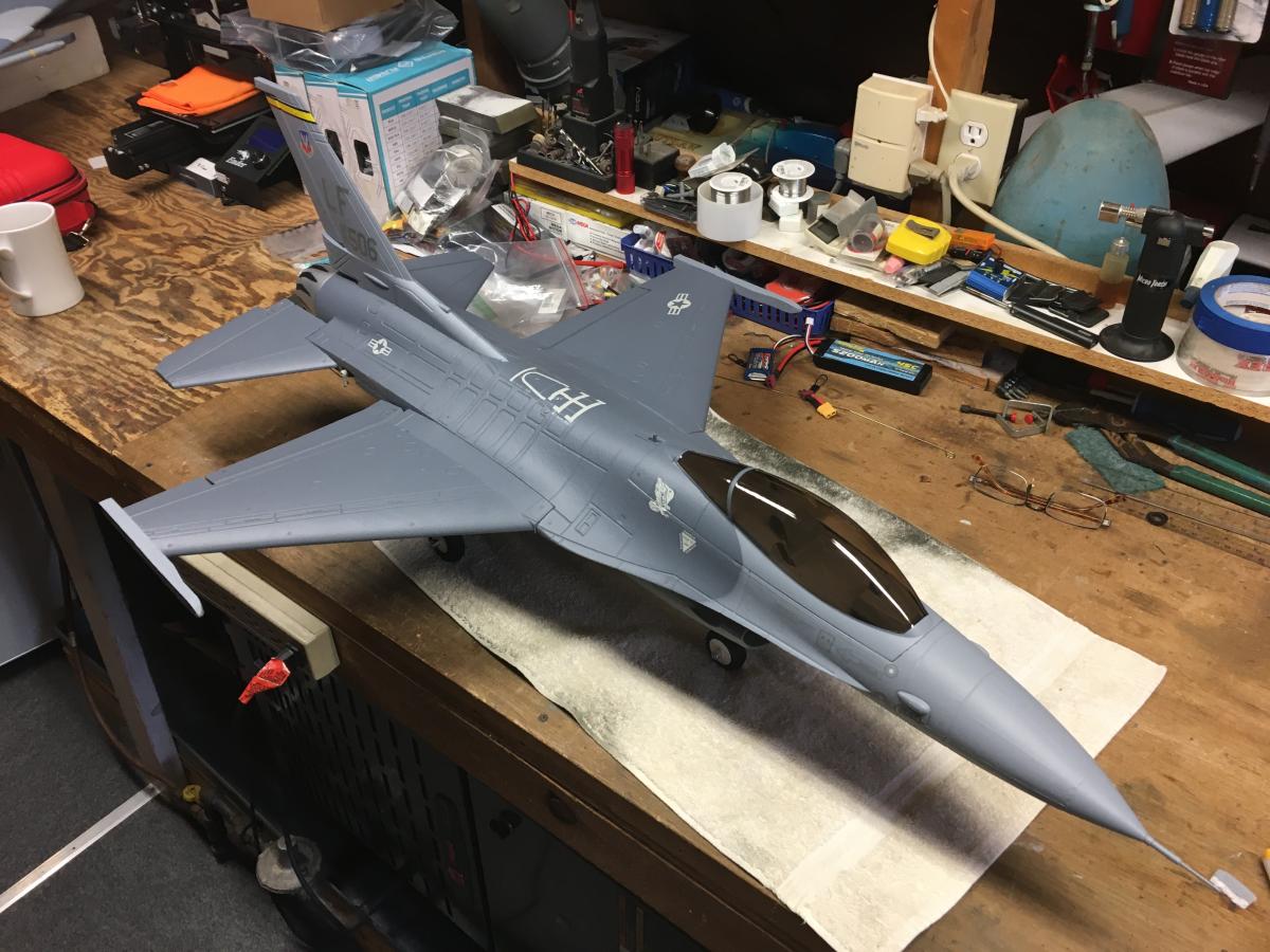

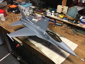

                      I did get one and it's modified and ready to maiden. I took a power reading of the stock set up and yanked it out, it pulled 43A and 672.5W. I put in a 60A 6S ESC and a Arrows 6S fan, it pulls 47.5A and 1095.6W. Also cut in a pair of elevator servos so I have separate ailerons and separate tailerons. The 1800 6S packs are 1/16" too tall with the stock battery tray and strap but moving the tray and strap back a little fixed that. Like my other F-16's I have flaperons and tailerons and have flap w/ elevator compensation, have basic tailerons with ailerons and a mix where the rudder is added so all surfaces deflect the same direction with ailerons.
                      Ended up at 1075g ready with 6S battery and landing gear, 788g without battery. I did have to add 20g of weight in the tail to balance. 450W per pound should make it a rocket ship.

                              The servos work well there. On 4S the plane balances out easily and the servos aren't too far back. On 6S, with a heavier pack I probably should have moved them as far back as I could to help balance. Keel the little eyelet the pushrod goes through. Since you are pushing to give up pitch a flexing rod is bad. I used metal gear digital servos from the Arrows Mig 29, I really like them. I thought about mounting them vertical underneath as it would hide them a bit more but the horizontal way is mechanically more efficient.
