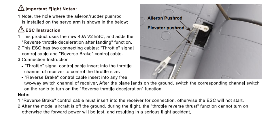

          I had a question about the reverse function. I'm using a Spektrum DX8 with an AR630 receiver. I have the reverse cable plugged into a free channel as mentioned in the manual below.
          Everything works fine initially after powering on but when I press the bind button (I use it for audio alerts like for timer) then it goes into reverse thrust mode and stays in it. The only way to not have reverse thrust anymore is to keep the bind button pressed down. In order to reset this behavior I have to re-bind the transmitter to the receiver. I also made sure to unassign any radio channels from the bind button but I'm still seeing the same behavior. Any idea why this would be happening?
          Click image for larger version  Name:	image.png Views:	0 Size:	223.3 KB ID:	360280
            • 5397
            #45
            When you go to the monitor screen on your radio what is the channel you have reverse plugged in doing when you push the button? What if you plugged it into ch5 and used your gear switch to reverse?
            • xargsgrep
              • Jul 2021
              • 56
              #46
              Thanks that did it, I explicitly assigned the reversing channel to another switch and I can now use the bind button for other stuff. I didn't bother setting it up before since I'm gonna be doing grass landings but I guess I should have done it anyway.

                      Help! I can’t get thrust reverse to work properly. I have the reverse lead on its own channel set on a 2 way switch and no matter what position the switch is in at half throttle the motor goes from forward to reverse thrust. If Enabled the switch the motor will run full power. I am using a Spektrum NX10 and a Spektrum receiver. I am out of ideas.
                        • 5397
                        #51
                        Sounds like you have your throttle mixed to the channel you are using for reverse. The easiest thing to do is plug it into the channel you would use normally for retracts with no mixing.
                        • Iamrcpilot
                          • Jun 2021
                          • 13
                          #52
                          It is in the normal gear channel (5) and I have no mix at all set up. I also updated the AR637TA and cleared the previous aircraft from the receiver.
                          • Iamrcpilot
                            • Jun 2021
                            • 13
                            #53
                            I got it. I had channel 5 channel assigned as throttle and I put it back as Gear and it works. Thanks
