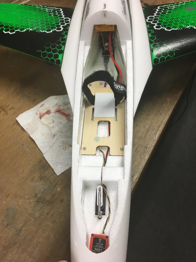

ID:	366919Click image for larger version

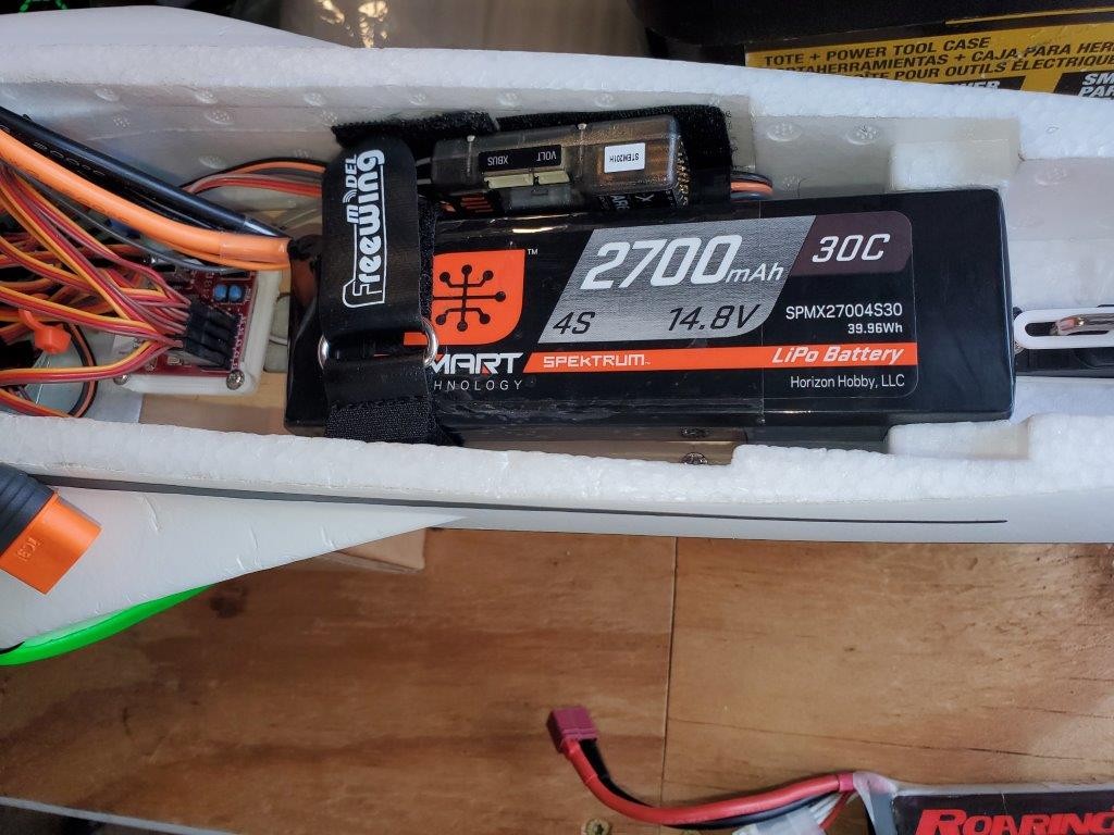

ID:	366920 Ok, got a Banshee as a Christmas present. Liked it so much I bought a 2nd one. I hand launch/belly land the first one but put the landing gear on the second for when I fly off of a runway. I have to say that this is far and away the best flying 64mm jet I've owned and actually, it's really my best flying EDF period. It's smooth and it's QUIET! And the stock version has very adequate power, even for jet aerobatics.
    I have a comment though on it's use as a hand launcher. There is no good hand grip. I absolutely have to launch with 2 hands and that means I have my hands off the TX during launch and immediately after, while frantically searching with the hands while keeping my eye on the plane! So what have I done? I put a Flex Aura Lite stabilizer in it. The Aura has a launch assist mode where it keeps the wings level and keeps a 30 degree up angle until you move the sticks. Then you regain control. So I heartily recommend it for hand launchers like myself. It works well, very well.
    I'm experimenting with Spektrum telemetry so I pulled the stock ESC out and put in an Avian 45 Amp ESC. I also put in an AR6610T telemetry receiver and I'm mostly flying with a 4S, 2700 30C SMART battery. The battery is virtually identical to the Roaring Top 2700's which I also use. (For those counting the $$, RX: $80, Aura: $60, Avian ESC: $60, SMART Battery: $55. More than the price of the plane and I now have 2 extra 45 Amp reversing ESC's that I took out. Anyone want one?) I had to cut some foam from the barrier which is aft of the nose gear servo in order to fit the battery in, but the snug fit helps to hold the battery in place. I move it as far forward as I can as you can see in the pics and this seems to give a good CG. I'm getting 5 minute flights and usually landing with more than 20% left on the battery.
    Here are the calculated telemetry numbers from one of my flights:
    Max power 949 Watts
    Max current 62.9 Amps
    Average power 446 Watts
    Average current 30.3 Amps
    I only use full throttle on takeoff and otherwise only in brief bursts depending on the maneuver. So even though I go way over the 45 Amp rating of the ESC I get away with it because I keep those high amp times short. I get temperature readings from the ESC telemetry but they don't mean much to me because I don't know where the danger points are. I think the main thing is those averages and they're well below the rated limits.
    I practice jet aerobatic routines and I have no trouble with double loops, full cubans, half reverse cubans, shark fins, square loops on edge (so you're doing 45 degree angles each leg), humpty bumps, knife edge and a few others. It does lack the power to do a pretty "Z" maneuver. This is where you come into it straight and level and then pull back 135 degrees so you're going upwards, on your back at a 45 degree angle. Then you push over 135 degrees so you're level again. You lose too much airspeed to push over at the end. I set my elevators to 125% throw and keep the upslope very short so I don't lose too much airspeed and I can just barely do it with the Banshee. I suppose if I went EvanD's route and upgraded to the 6S system it would help but for the moment I'm happy with the way things are.
    Anyway that's what I'm doing with my Banshee. I did notice that the one with the landing gear doesn't quite have the oooomph that the hand launched one does but that isn't surprising I guess. I have the same setup in both so the extra weight and drag of the landing gear does have an effect.

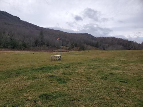

        Welllllll, as a matter of fact ... on hand launching and belly landing I had the same concern about those servo arms being unprotected under the wings. If I had a 3d printer I would print up some kind of fairing to go over them. I'm having an issue with one of the flap servos chattering like crazy on full flaps. I have to limit it to a little less than 50%. I think something happened on a landing to cause that. The plane glides like crazy and the flaps do help.

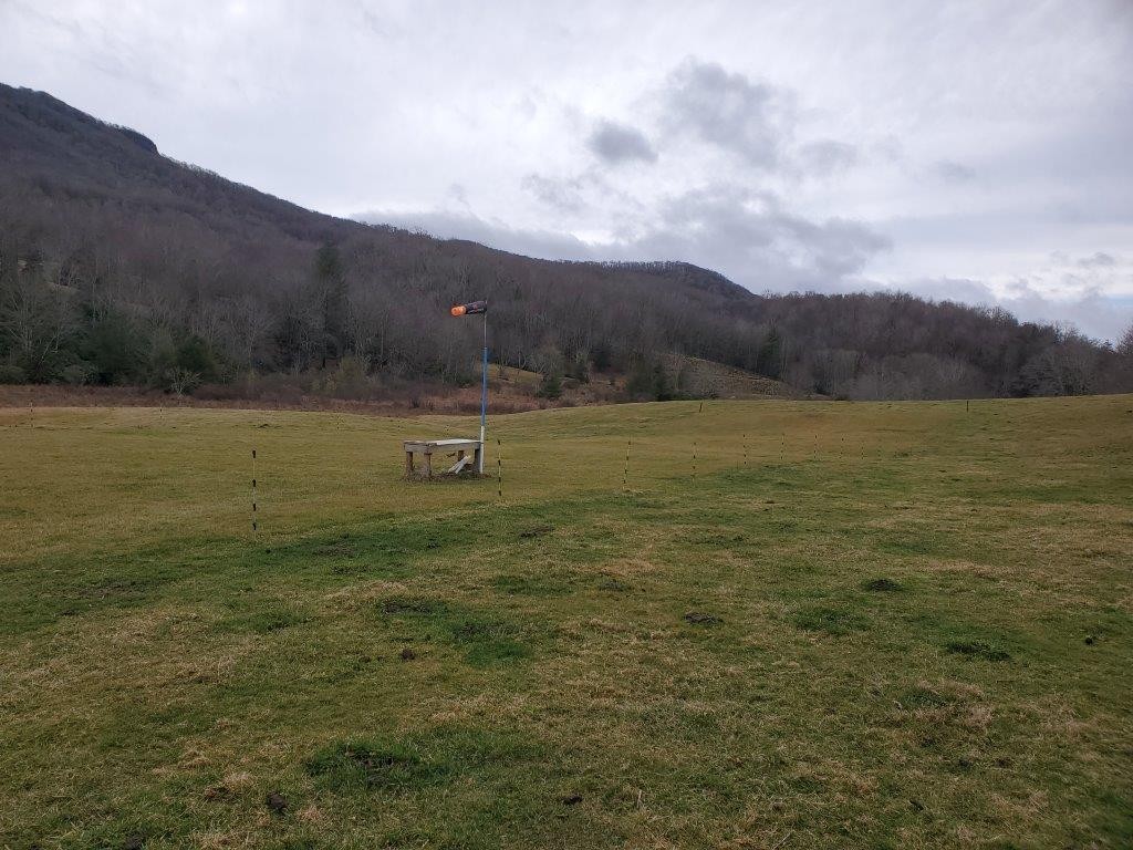

        • #84

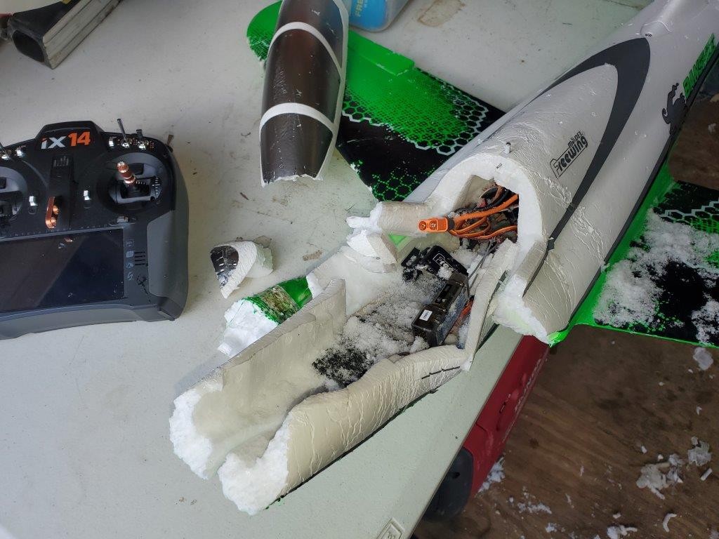

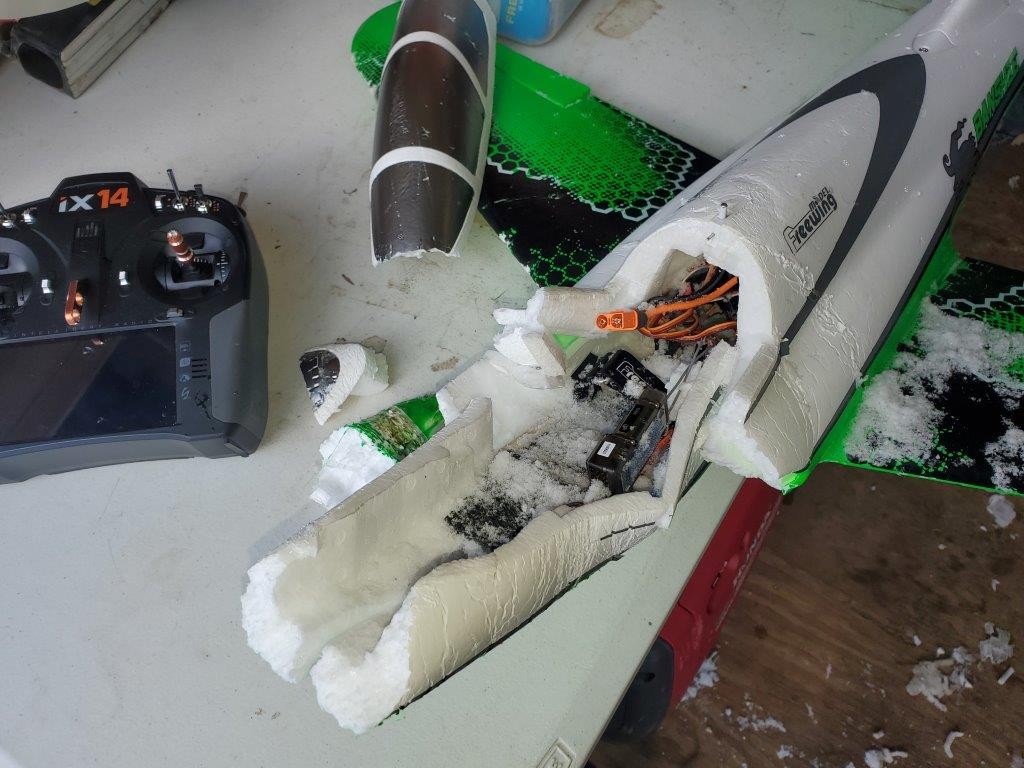

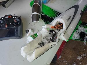

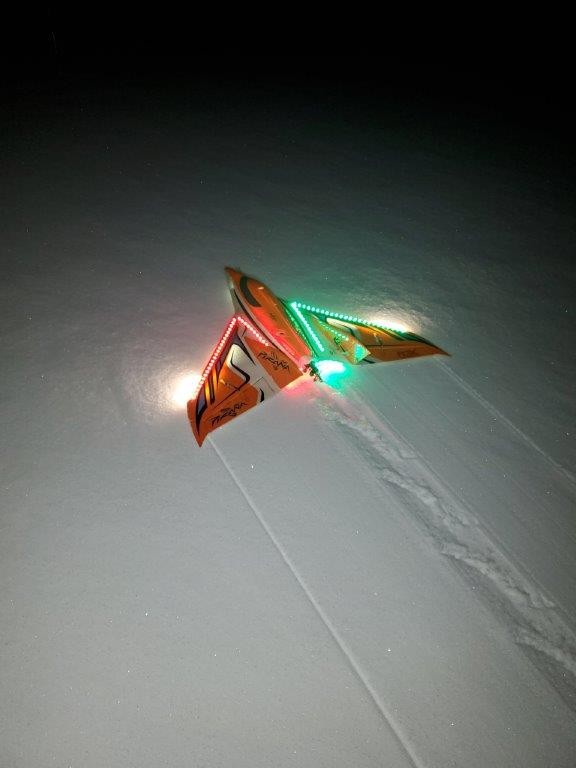

              My Banshee got a little booboo today. Winds weren't bad at ground level but 100' up they kept flipping me around until it had it's way with me. Crashed hard into the snow. But later on the winds were a bit less and the Pirana did just fine with a pretty landing in the snow. Banshee fuse is a lost cause, take a better man than me to fix it so ordered a new one but the battery and rx are ok so, all things considered ... this isn't too bad. Click image for larger version
ID:	367117Click image for larger version

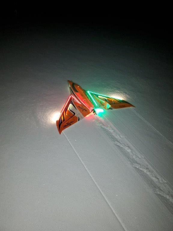

                  Just added an led light ring:

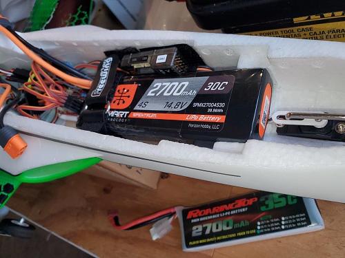

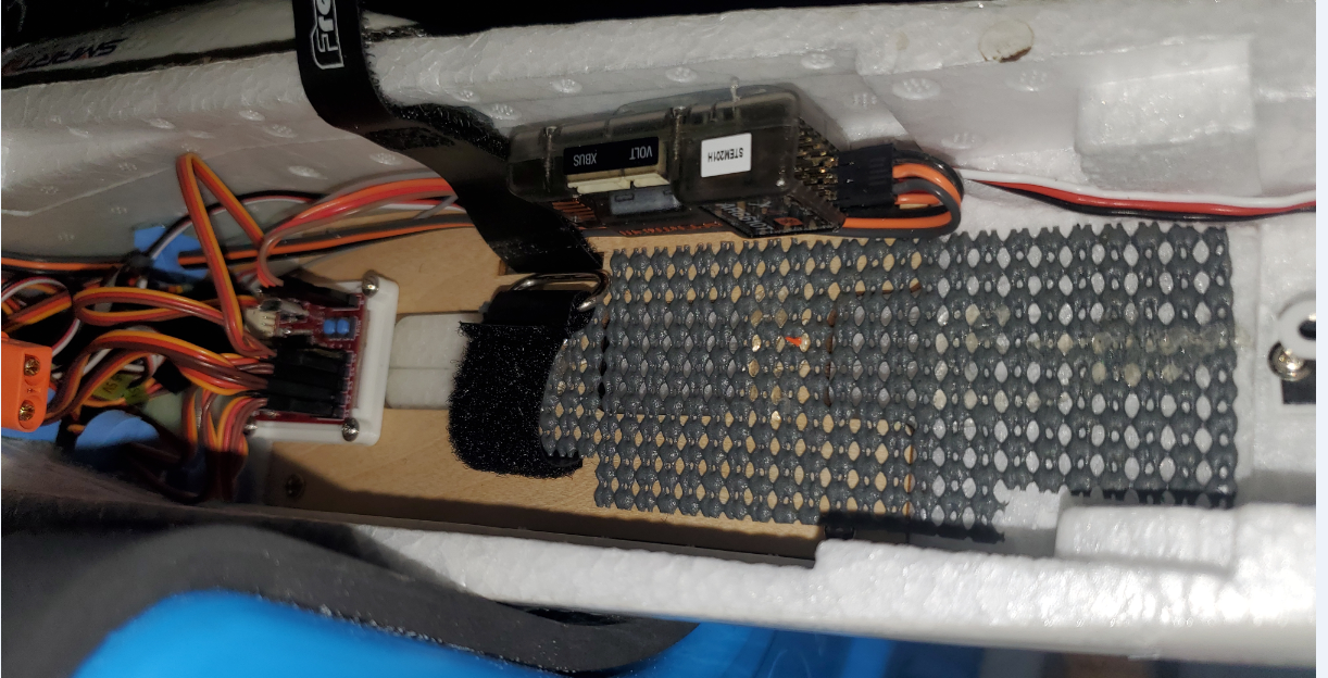

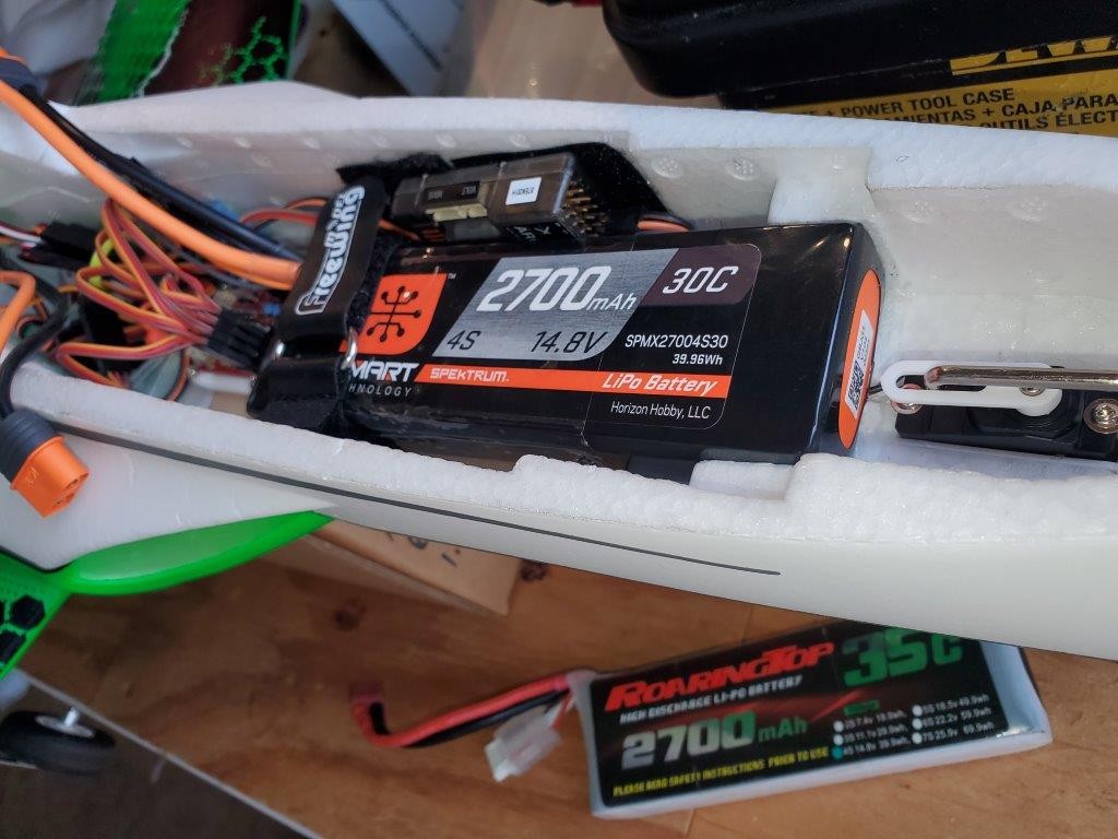

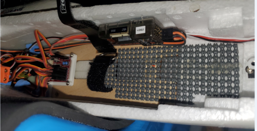

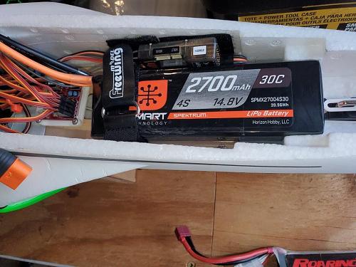

                        I thought others might appreciate a picture of my cockpit layout. That's an AR6610T receiver and the FT Aura Lite gyro. I've been flying 4S with 2700 mAh batteries and I easily get 4+ minute flights when hand launching. One battery is an HH Smart battery and the others are Roaring Top. They both weigh close to the same and have the same exact form factor. I've found that hand launching with the landing gear and steering servo removed seems to make the plane fly with a lot less throttle. But it really needs the Aura gyro with its launch assist to do a hand launch well. And you either need a decent head wind or a strong throw. I know. I've pancaked on takeoff a couple of times when there wasn't a head wind.
                        As soon as the motors are back in stock I'm going to upgrade one or both of my Banshee's to 6S. I'll probably use a Smart 1800 6S 50C battery (for the telemetry benefit) but I'd like to hear what other people are using for 6S.
                        ​​ Click image for larger version
