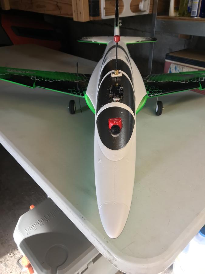

      Click image for larger version  Name:	image.jpg Views:	0 Size:	79.1 KB ID:	359305 ​Decided to FPV the Banchee !! DJIG0013

        Nice video. While you have the nose off take out that metal weight and rebalance the plane.

          #44
          Thanks Evan. That's what I did. weight was 21 grams. Did have to position the 2300 4S battery all the way forward to obtain correct balance. AUW is 1150 grams. Sound heavy ?

            #45
            Loving this Banshee with FPV. Had a 10-12 mph headwind this morning, but had to try out the Banshee again !!! Took out the 25 gm. nose weight, and had to place 2300 4S battery all the way forward. Practicing take offs and landings as i'm new to EDF. (126) Freewing Banshee FPV Cisne Il. 10-22-22 - YouTube​

              #46
              Good flying!
              I didn't see your post before about heavy, no not at all, mine is 1185g (on 6S).

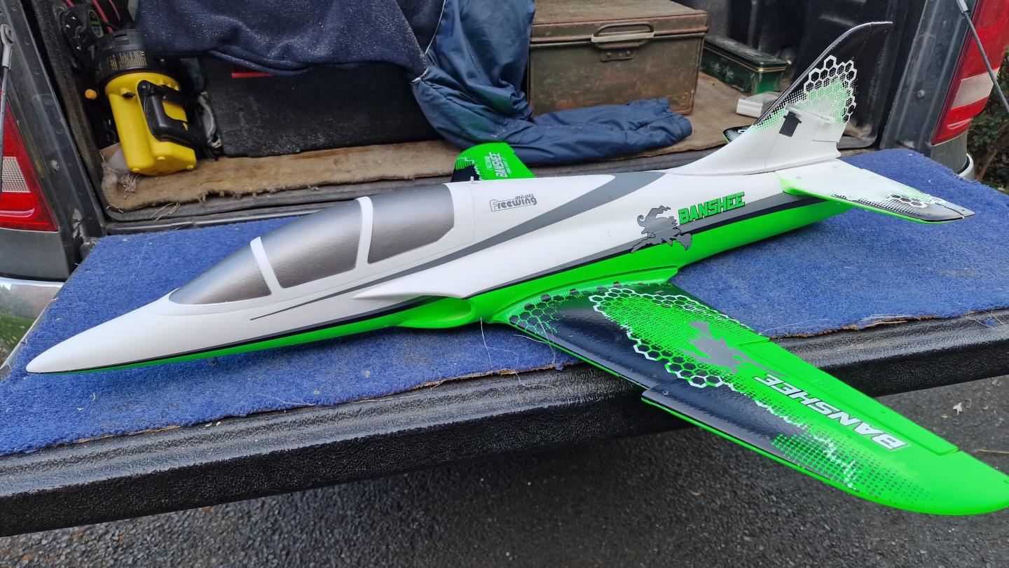

                                  #56
                                  Had a brief break in the UK weather yesterday and managed to maiden the Banshee.
                                  Started off with CG on the marks, but she wanted to nose down. Moved it back slightly and she flew very nicely, not super fast, but very steady in flight. It was perfectly calm.
                                  Here's a brief video, nothing fancy, just feeling her out. Flew around six packs in total.
