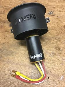

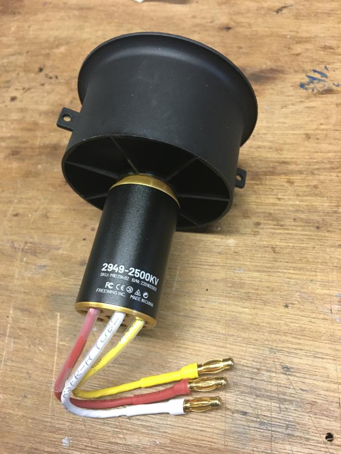

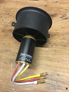

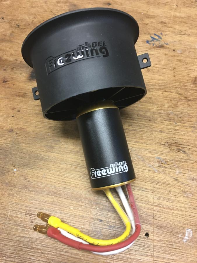

As some may know I put a Arrows 6S fan and a different ESC in mine when I first built it. Free Wing came out with a series of new fans and the Banshee got one, the lowest power on of the series. These are really 65mm where the older fans were 63mm (it makes a difference) Anyway the new series had a low and high power outrunner and a low and high power inrunner.
I ordered the new high power 2500kV inrunner and upgraded sprung gear from RC Castle and got them today.
Numbers… stock low power 4S out runner was 57A 870W 990g thrust
The Arrows 6S was 49A 1135W 1290g thrust
Now it's 75A 1670W 1590g thrust
70% increase over stock. 50+g heavier.
The new gear are very nice but add another 27g.

Caution to those going to the fans Tom just posted about. First they are 6S fans and the stock Banshee ESC is up to 4S. A 6S capable ESC is mandatory.
Second the 2300 draws a maximum 42A OUT of the aircraft. It will draw significantly more in the aircraft and a 50A 6S ESC should be fine but the 2500 in my Banshee is drawing just under 75A on a fresh charge so I suggest more than a 60A 6S ESC.
- Likes 1
