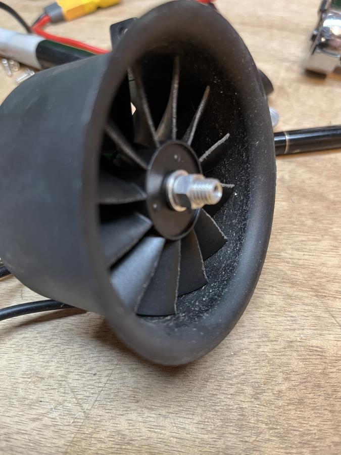

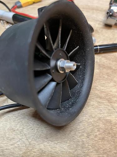

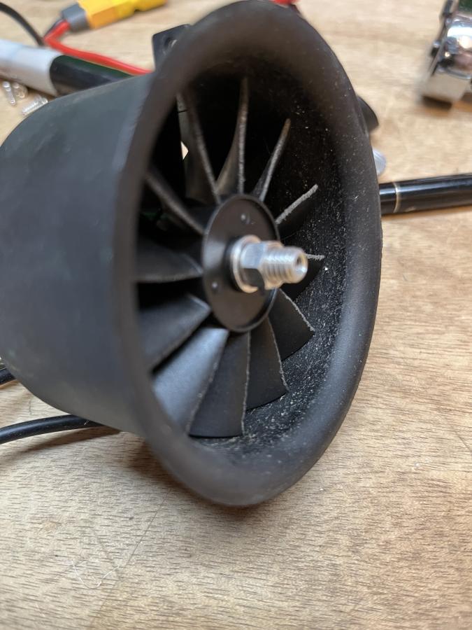

                                      • Click image for larger version  Name:	image.jpg Views:	0 Size:	82.9 KB ID:	378662 Having trouble getting my 3100 KV motor attached to the fan unit. The problem is that the shaft spins and I cannot get it tightened . How can I tighten the shaft? Thanks in advance Cary.​
                                        • This is the motor I’m having trouble getting the fan tight on. Anyone else have this motor-fan combo ? Click image for larger version  Name:	image.jpg Views:	0 Size:	109.0 KB ID:	378664​is
