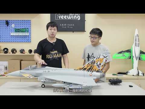

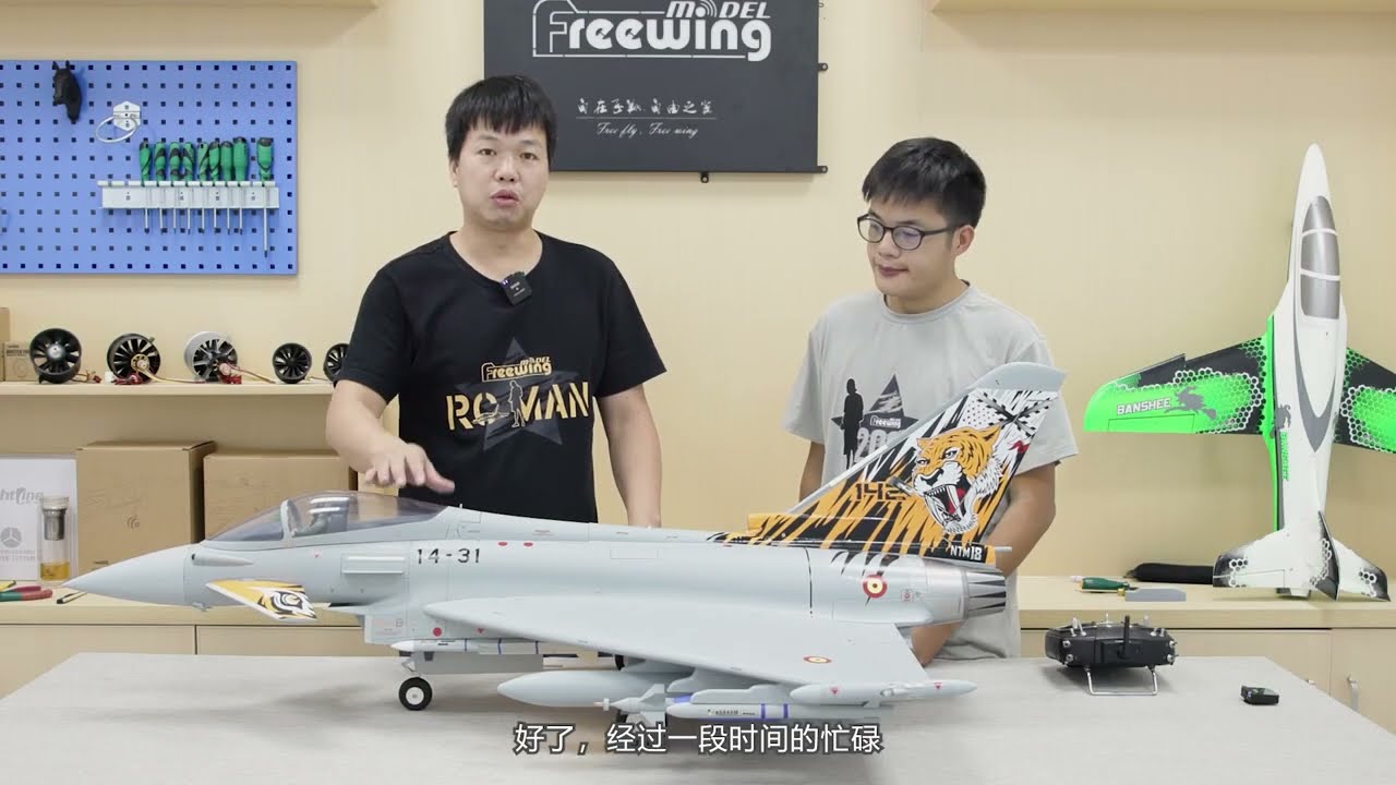

                  • WARNING: Avoid if you are averse to these.
                    Build video from FNRC. Can’t understand anything they say. Skip the first 2.5 minutes and the last 2 minutes. Not much talking in between. I saw a couple things that were interesting. Looks like the exhaust nozzles already have narrower inserts built in. Control surface demo ~2/3rds in. Shows what the switch does and airbrake function, reverse.
                      well looking through their U-tube channel (even though I don't speak a work of their language )
                      seems they get very early access to a lot of new kit. didn't even know Freewing had developed a Centreburner system. looks very swanky with universal mounts much more streamlined than other solutions and you don't have to stick cable ties into the motor case. Also in the promo stuff for it looks like the display model is the new Eurofighter, makes me wonder were these developed in conjunction?
                      • They did an excellent job of showing both assembly and set up along with alignment and how to reverse the surface directions if needed for your radio. I like that the now have allen headed screws. Note the control board is not the "blue box" MCBe. Interesting that they don't score the parts to be glued or touch the parts then separate them before putting them together.
                        The center burner came out last month and even Tom from Motion has mentioned them in threads. They are available now at RCC.

                                      To me this looks like it was shot at Freewing and posted by FNRC, set is different as are the people
