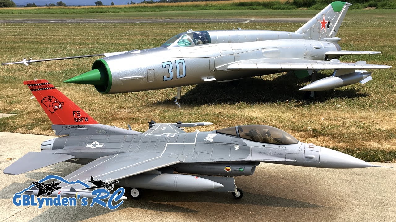

This is another fun flight with the MiG-21 and the F-16 doing some Formation Flying!This is a fun video of two Freewing EDF Jets flying in formation. They are the Freewing F-16 and Freewing MiG-21 EDF Jets flown expertly by a couple of my bu...Leave a comment:
This is a cool jet! I don't have one, but my buddy does and I caught some fun flights with it.

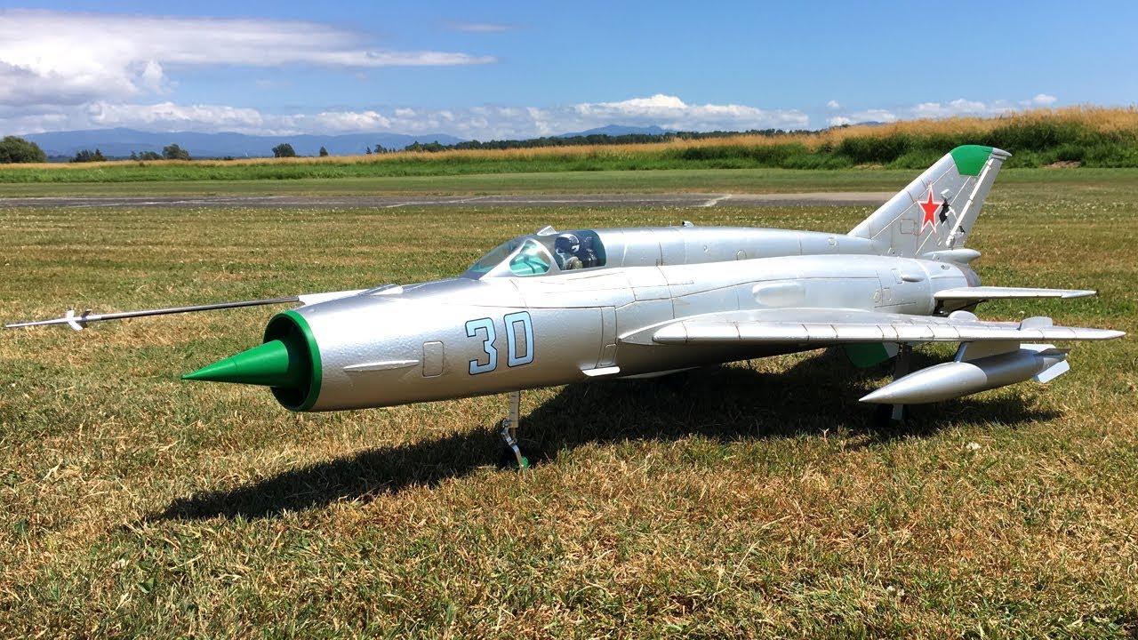

This was a flight from this Freewing MiG-21 80mm EDF Jet Fighter at Warbirds Over Whatcom this past summer.This is a video of a long-time RCGroups buddy flying his Freewing MiG-21 80mm EDF Jet Fighter at Warbirds Over Whatcom. It is quick but fun with lots of nice...Leave a comment:
