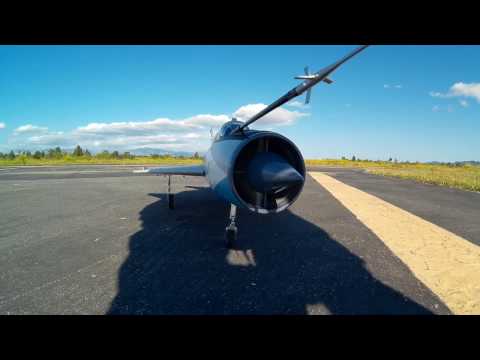

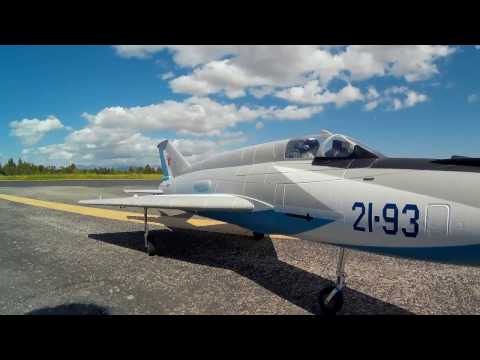

    Well my friend wanted to test some new settings on his camera by tracking my MiG, but for some reason the video quality isn't that great.
    Anywho, here is me throwing the MiG around for a DBF demo.
