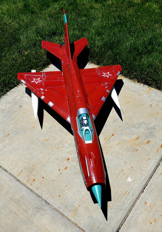

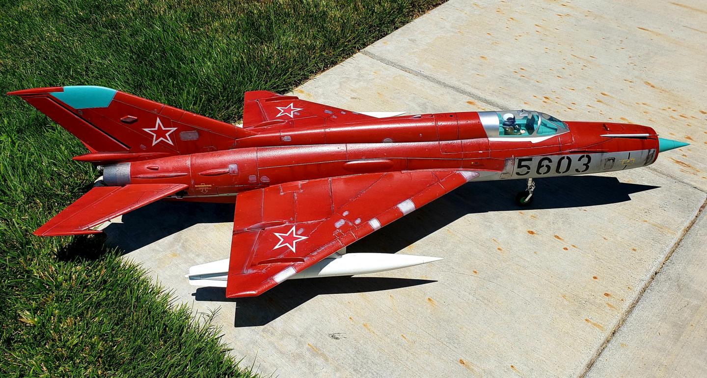

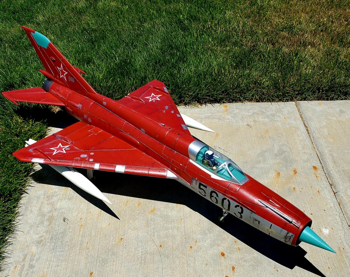

Sooo, I decided to put an Aura 8 in the jet, I bought it for $50 from a club member who complained he couldn't figure it out and now I know why! But after a little "hand holding" from a friend who has several I got it sorted. I used the manual rates except less aileron, and the factory CG. I got the maiden and 5 flights on it today. I really like it! It looks way cool in flight and was quite easy to spot the landings. As you guys told me the gyro is not necessary but here in California right now the smoke haze is a big problem if you are flying a Mig-21 for the first time! Vis was a little poor. So when i started using the gyro on the second flight I was relieved to have it lock in like it was on rails. No wing rock or over rolling. There's not a whole lot of wing to look at and the Aura 8 really impressed me as there was basically no dialing in, just flip the switch and enjoy the ride. I think it is a quality product.
I found the Mig to be a little "old school" in its performance. That is not a bad thing but it is not the fastest or most powerful or efficient Freewing jet I own. But it is a little more "pilot friendly" than my 90mm F-104 and similar to my F-5 if not as fast. Where it stands out is it looks cool! Three minutes is definitely appropriate, all my flights were right around 30% battery remaining after three. I'm a bit bummed about that (considering it's an 80mm and I'm using 6s 5000 mAh packs) but you can really see it in flight, going to idle it slows right down, not much of a glider, must be a lot of aerodynamic drag. But on the gas it rocks! Love the tight turns and axial rolls too. Bottom line I am glad I got it, very cool airplane, fun to fly (no drop tanks BTW), and looks like nothing else on earth. This is why I love FW foam jets, I wouldn't really want a turbine with this limited a flight envelope, but you can enjoy flying and owning a Mig-21 without having to take out a second mortgage!
