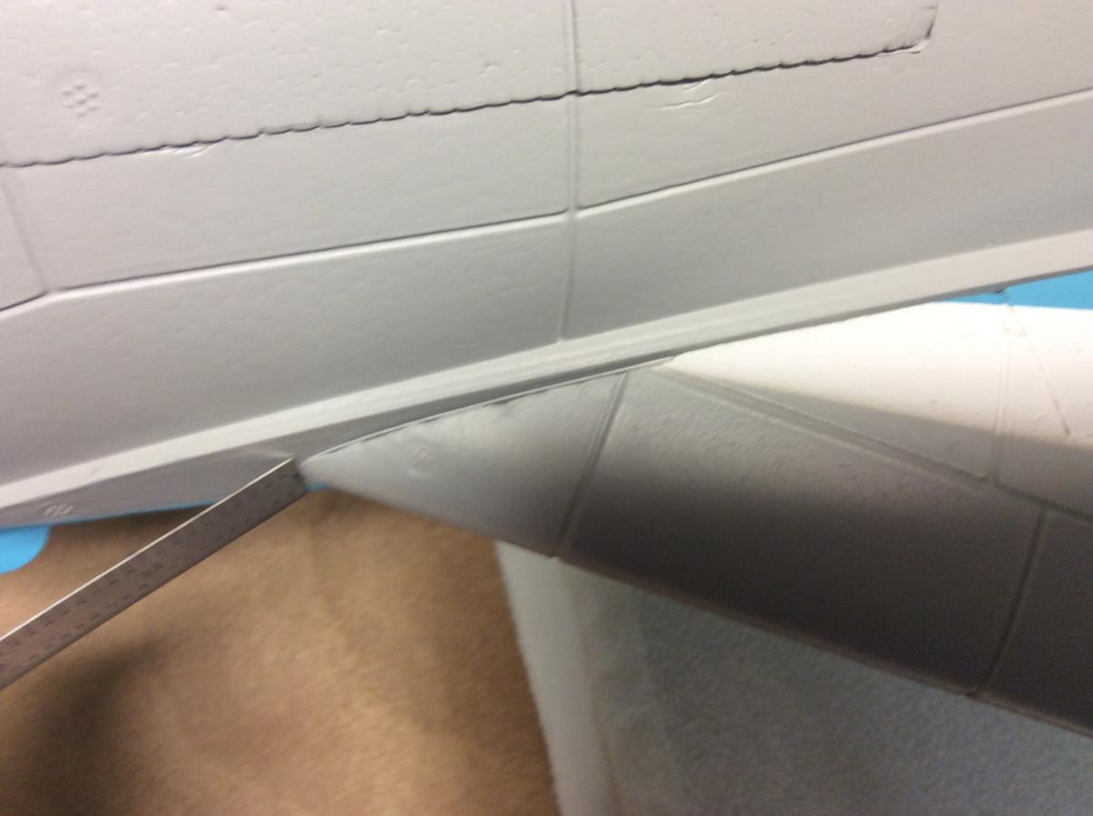

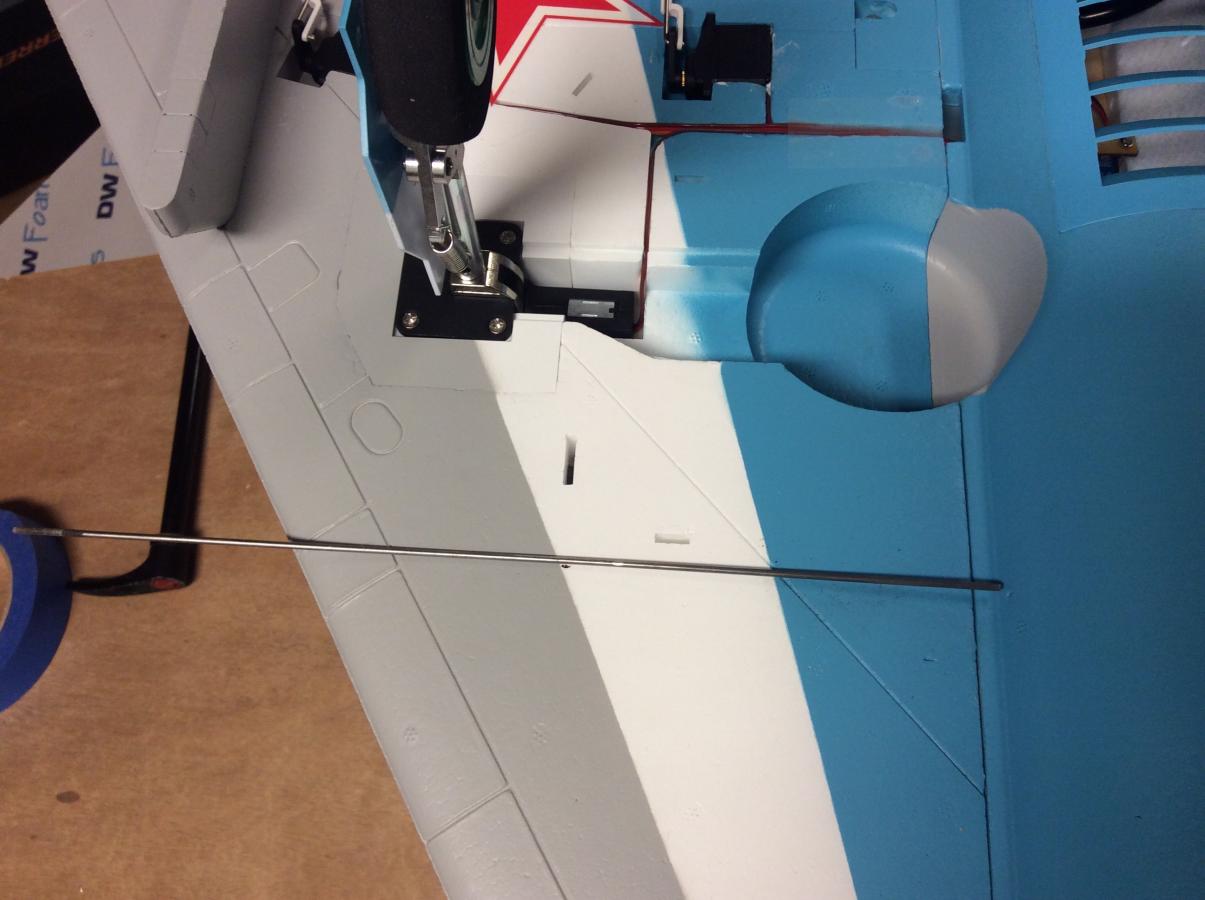

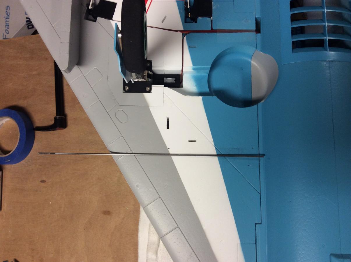

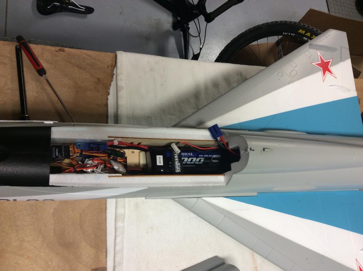

          #544
          Thanks for the reply’s. I want to say I know the issue is just a set up error on my part. I just want to get to the bottom of it before attempting flight #2. The maiden flights on my L-39 and F-15 went so well, it could be I was a little complacent setting this one up.
          Alpha: I measured from the point where the wing leading edge meets the fuselage. After the first flight I re-checked the CG position and found it to be slightly forward of the recommended range, about 10.2”. I have now moved the battery aft to achieve the 10.5” specified in the manual. But it sounds to me like I can move it slightly aft from there given previous comments. I took a pic of my battery (Admiral 6s 5000) position at 10.5”. It’s well back in the battery compartment.
          TiredIron: I set the control throws both high and low per the manual. -35% expo high, -25% expo low. (Futaba) First flight was on high rates the whole time.
          DCorsair: I fly off paved runways. It was in fact a long roll. At least compared to the MiG-21 videos I have watched. The ESC, fan and motor were “borrowed” from my L-39. The combo has been previously calibrated and been a great performer.
          Pic 1 - CG measure point
          Pic 2 - CG location, 10.5”
          Pic 3 - Battery location, 10.5” CG
          Pic 4 - CG location, maiden flight 10.2”

              #546
              Pic 2 - CG location, maiden flight 10.2”
              Pic 4 - CG location, 10.5”
              Looks like your CG is not the issue.
              I think its your dual rate settings because if you followed the manual it calls out for 80% dual rates on the Ailerons
              and 100% dual rates for the elevator. This is way too high with the stock servos which i assume you are operating with.
              I dont use stabilizers or gyro on my mig as it doesn't need it at all.
              i have my aileron rates set to 40% dual rates, high expo 40% medium expo 45% low expo 55%
              for the elevator dual rates i have mine set to 50% with the same high to low expo settings.
              This will fix your problem.
              good luck on your second flight
