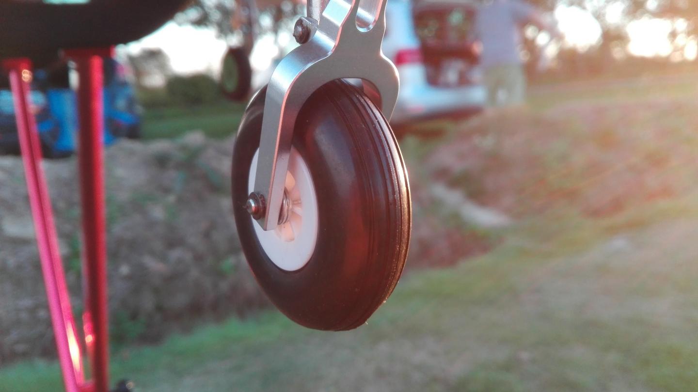

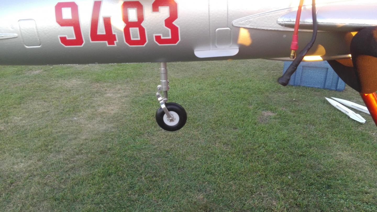

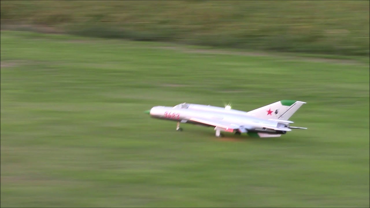

                                Hi Ray thanks for your good information. As I can't move my lipos futher to the back (battery tray is moved aft as far as possible already and my lipos are touching the back the of the compartiment) I tried with a slightly bigger front wheel.
                                50mm diameter instead of the stock 45mm. That's a few mm already and I had shimmed the front retract with 2mm spacers already, so I ended up with the same 5mm more AoA
                                all could be done without foam surgery, wheel fitted the strut without any problem
                                happy to report back that those 5mm made a big difference, I can take-of now after 2/3 or 3/4 of our 80metres grass runway now :Cool:
                                here's a few pictures
                                • Originally posted by Icarus the 2nd View Post
                                  Glad it worked out!
