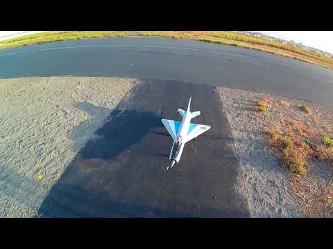

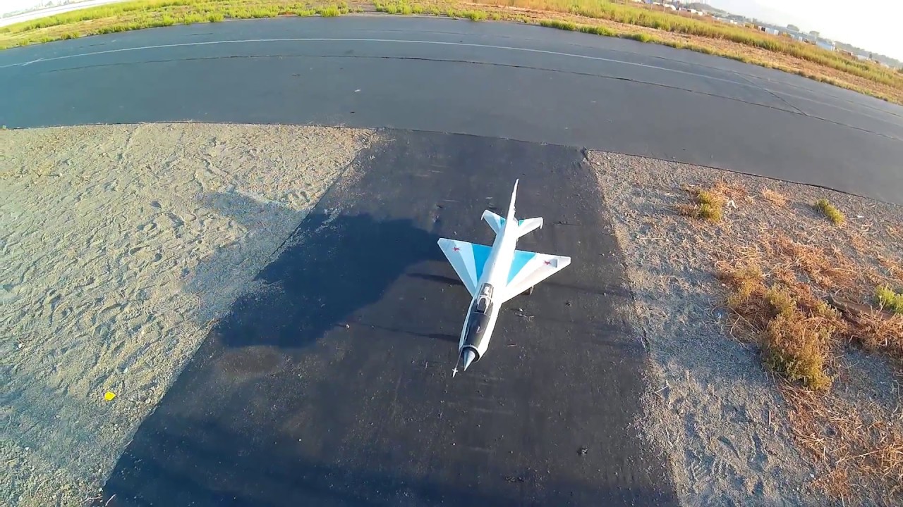

                        I fly mine with the FMS 80mm 12 blade with 2000kv inrunner. I get about 5 mins flight time with my Turnigy Heavy duty 5000 packs. The FMS set up is quite a bit lighter than the stock unit, makes more thrust with less amps at half throttle and makes a lil more thrust at full throttle. It sounds good too! Here is a video of me flying mine if you have missed them from earlier.
