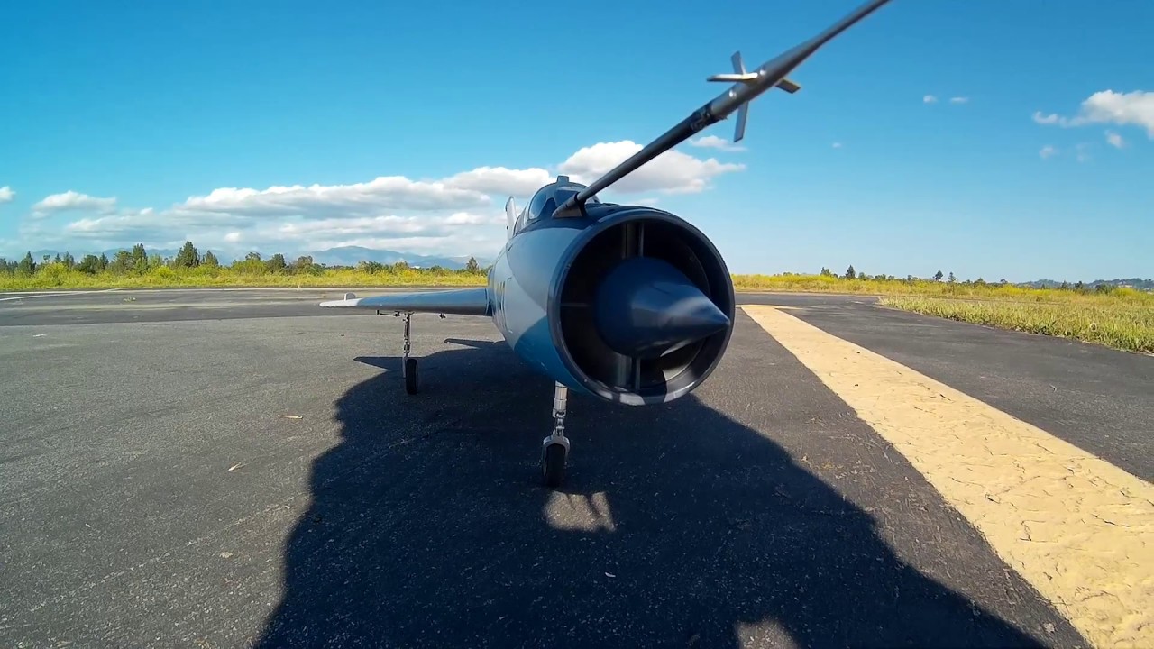

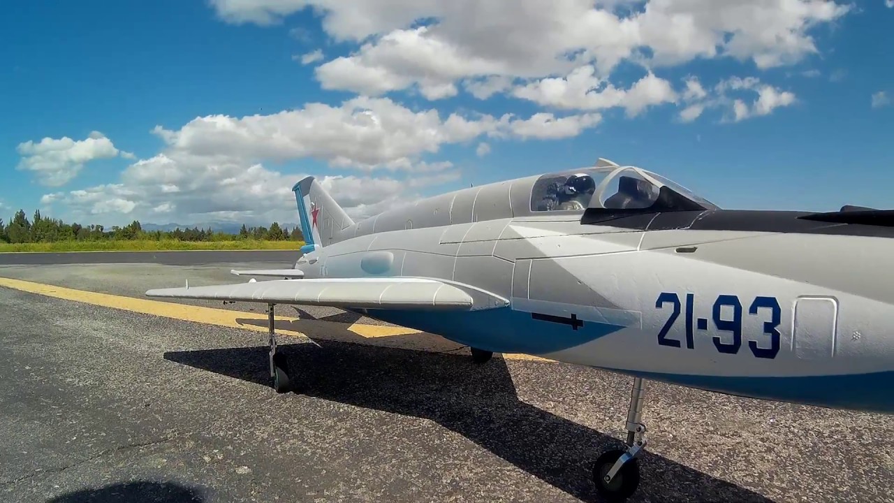

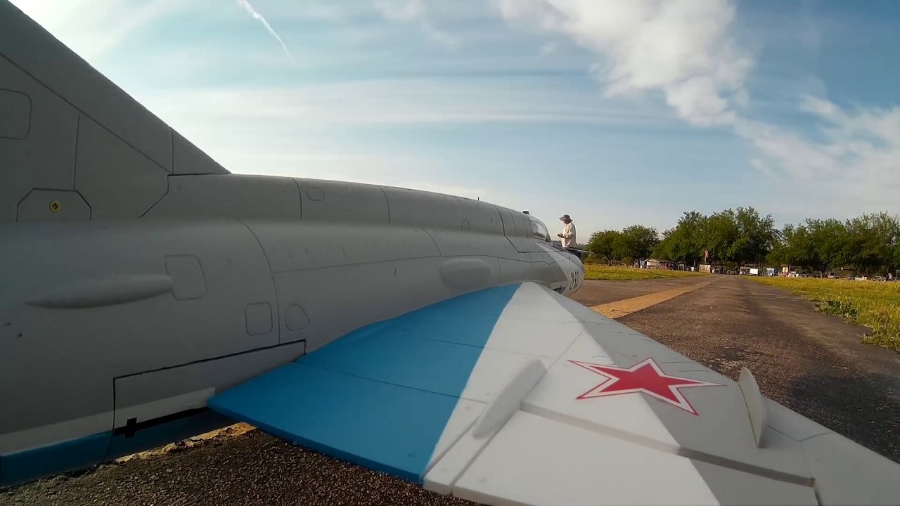

                  • Lots of good flights with the mig at Apollo this past weekend...
                    • Well my friend wanted to test some new settings on his camera by tracking my MiG, but for some reason the video quality isn't that great.
                      Anywho, here is me throwing the MiG around for a DBF demo.
                      • Are you running the stock power in that MIG?
                        I'm impressed with the performance, and you fly it very scale like. That vertical!
                        • She's totally stock with an Admiral 5000 mAh and an AR8000 on a DX9.
                          She's a totally fun flyer and I'm glad I got it to replace my LX MiG-29. I can actually fly it hard without worry of shedding a wing or blowing something apart now :)
