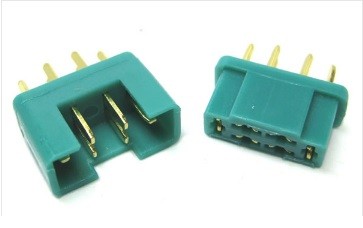

                      • Good morning to all,
                        I order my Mig21 today (will take some time to arrive) and it´s seems dificult to disassemble the wings for a easier transportation (it´s really very dificult to disassemble?); so i´m planning to use a MPX conector (cutting the servo wires) and conect both sides inside the fuselage (opening the window below the plane , where is possible to acess the ESC, conect the wires and close everytime)...my question is if it´s possible to pass the conector throug the fuselage hole normally where the servos wire are inserted?
                        I can also glue the MPX conector on the fuselage and on the wing but specially the wing servos, will need to be cut very short and honestly i don´t want in case something wron i´ll need to change the servos.
                        Thank you guys!
                        • unless you are carrying it on a motor bike the wings will be the least of your problems its not very wide at all, the length will be the problem(never thought I would ever say that in public:)
                          • Originally posted by jay bennett View Post
                            It´s not a motor bike but my car is so small that is almost a Harley ....
                            Regarding the length , no big deal actually, the jet will go in the passanger seat as usual..
                            Wings still a concern.
                            Thanks
