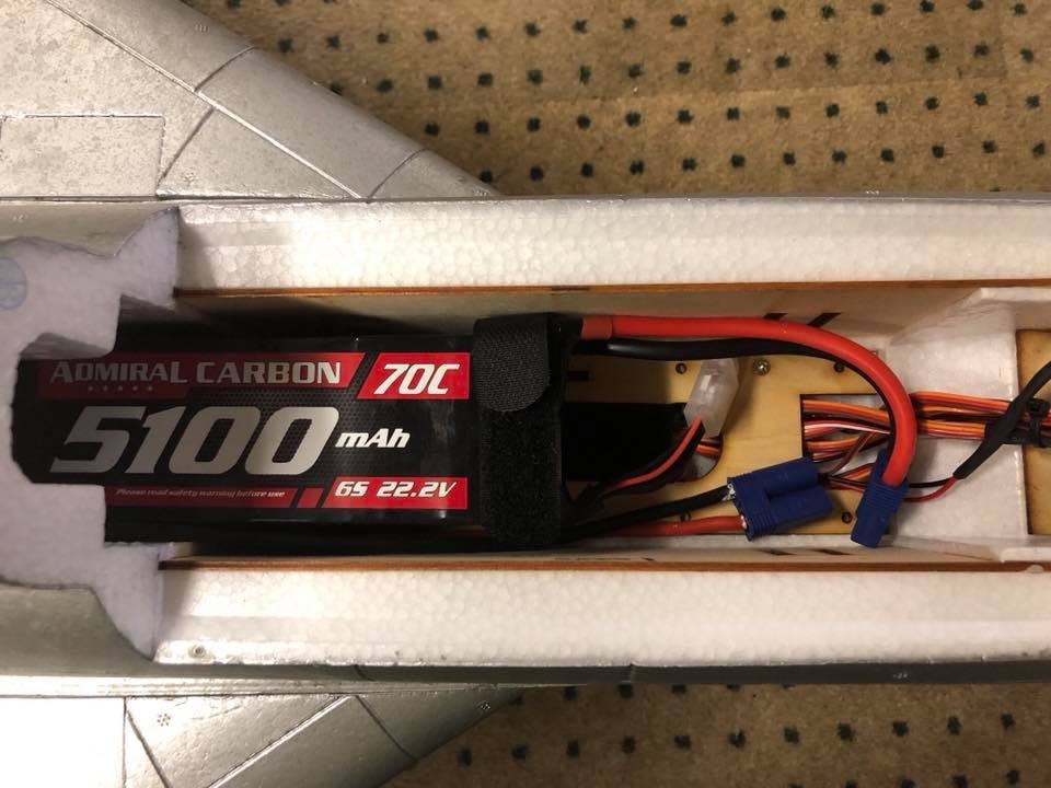

          • Does anyone know if the Admiral Carbon 5100mah 70C 6S will fit in this jet and will it balance out?

              Yes, it will...I posted pictures in the Admiral Carbon 5100 thread.

                  Found it...
                  On the Freewing Mig-21 a new Admiral Carbon 6S 5100mAh battery will CG at 265mm from the wing root if the battery is 210mm from the point where I measured from.

                        Back from my trip from the Father Land just yesterday, and therefore just saw your question posted.
                        Yes as George has already mentioned these fit great and had no differences in making efforts to re-trim the aircraft "no stabilizers" with the china hobbyline 55C Gplus series 5000mah and and admiral 70C 6s 5100mah.
