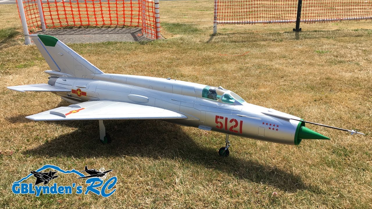

                                          #660
                                          This Freewing MiG-21 80mm EDF Jet Fighter Performed High Alpha Maneuvers at Warbirds Over Whatcom and was piloted by a Canadian Airline Pilot named Sebastian.
