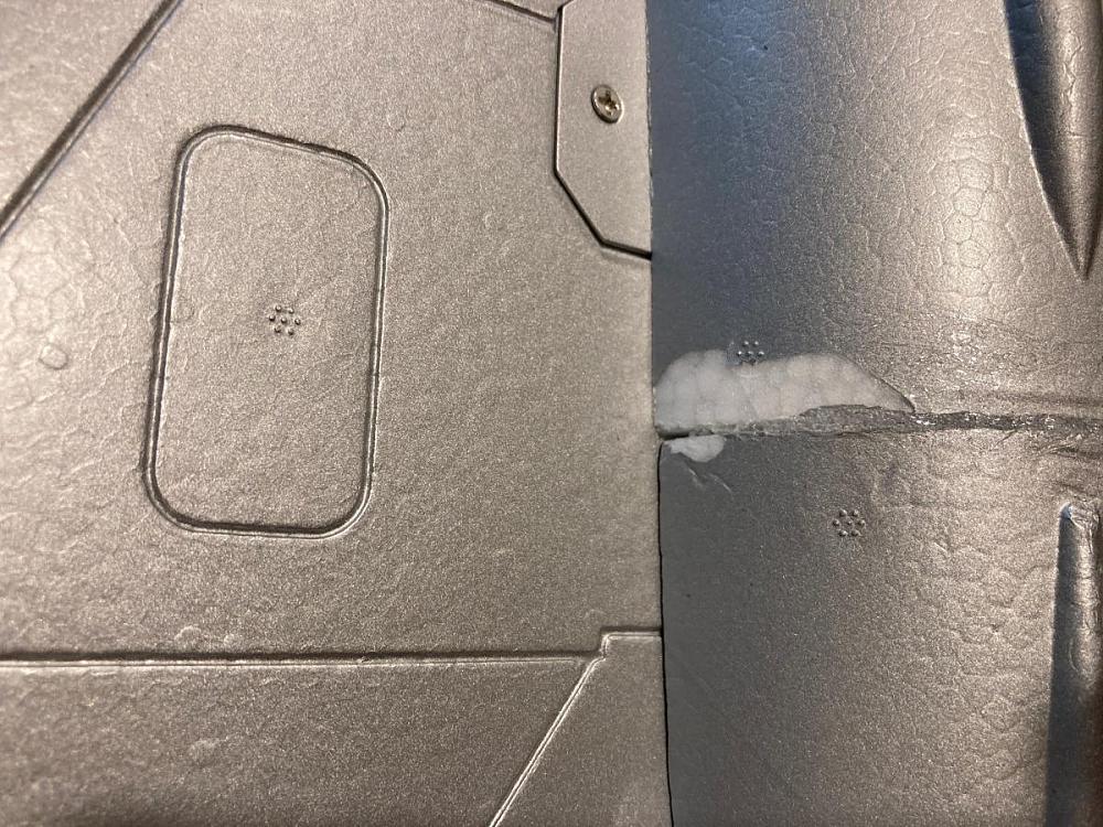

                      • I just glued the rear fuselage on mine and have a bit of an issue. I used BSI foam-cure, but did not realize that it bubbles a bit as it cures. Given the large surface area being glued, it pushed the two parts apart as the glue cured. I have a gap of about 1.2mm at the top and .8mm at the bottom. It was out enough that it cause the holes for the rudder mount screws to be mis-aligned by about 1/8 th inch.
                        Did anybody else run into this before? Did it create trim issues?
                        I would normally just run with it , but I am doing a turbine conversion, so the stakes are higher. A new fuselage is $100 plus a couple days of work lost.
                        I am not worried about the strength of the joint, but the mis-alignment of the tail assembly creating a control problem.
                        Any thoughts?

                          Is the gap just top to bottom or top to bottom and a bit of left to right/right to left. Wider at the top means you are about 1mm down at the back of the thrust tube which is not a lot but might lead to a small amount of nose down thrust as you throttle on. If this is the case you may be able to correct with throttle to elevator trim mix so that the elevator trim goes up in proportion to the thrust if it becomes critical. Also a touch of normal elevator up trim might be required on maiden flight as wing to horizontal tail incidences may have changed a fraction also inducing a touch of down into the calculation affecting normal angle of attack/stance of the model in the air. Difficult to judge without setting the model up on the bench and taking offset measurements from parallel lines both side of the fuselage for left to right but again this could be trimmed out. When you consider that the Dynam ME262 had a thrust line way below the wings and I got that to work with some throttle/elevator trim ( around 10percent ) and resetting the horizontal tail incidence to a better position then I would have thought that the amount of difference in thrust line you have could be trimmed out. I do not know anything about turbines but if you are using a thrust tube liner perhaps you might look at fitting and re aligning a suitable thrust tube to bring the trust line back on course so to speak depending on the thrust tube dia calcs. Well, right or wrong those those are my thoughts and no doubt others will give you more. Good luck..

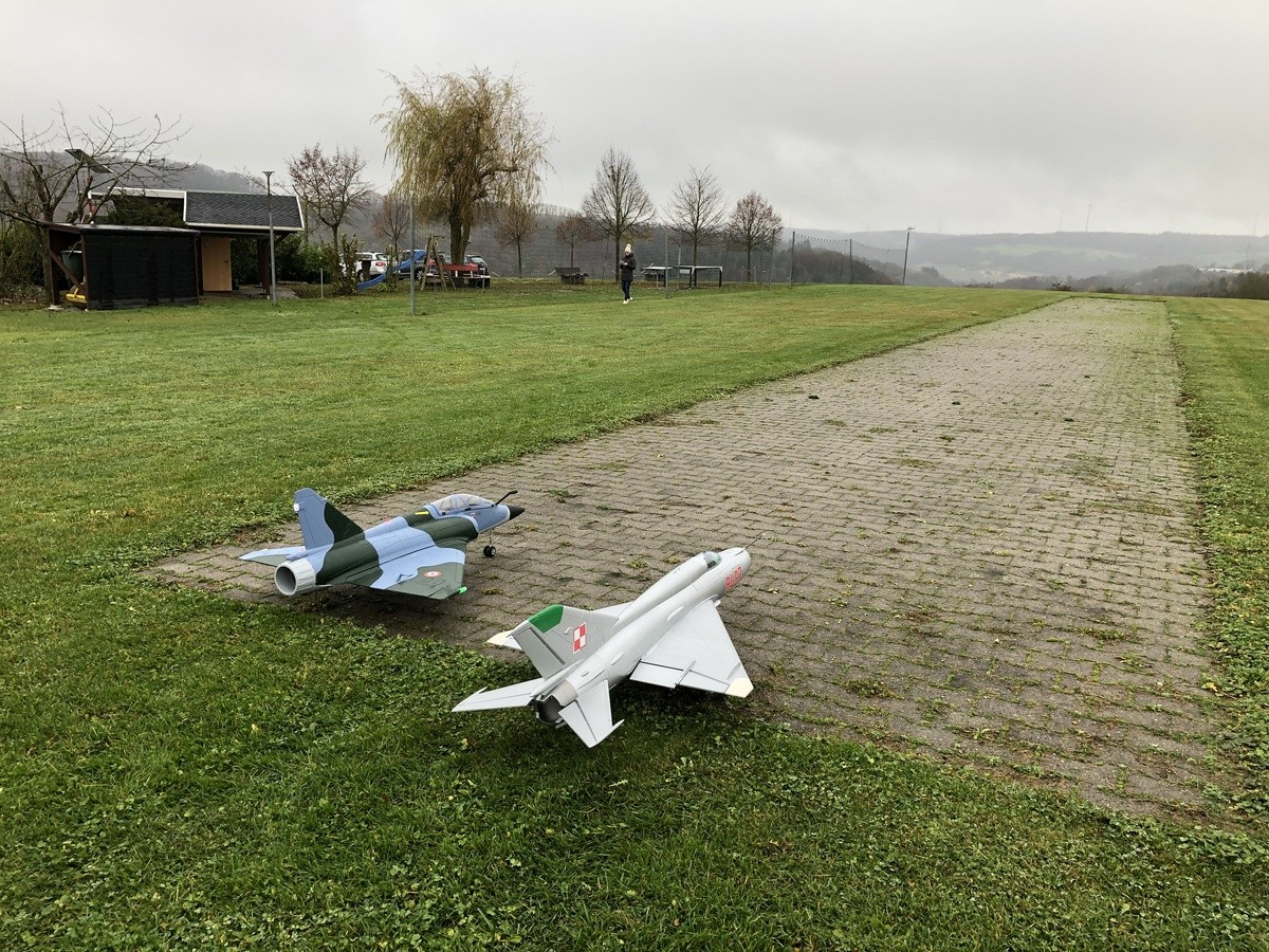

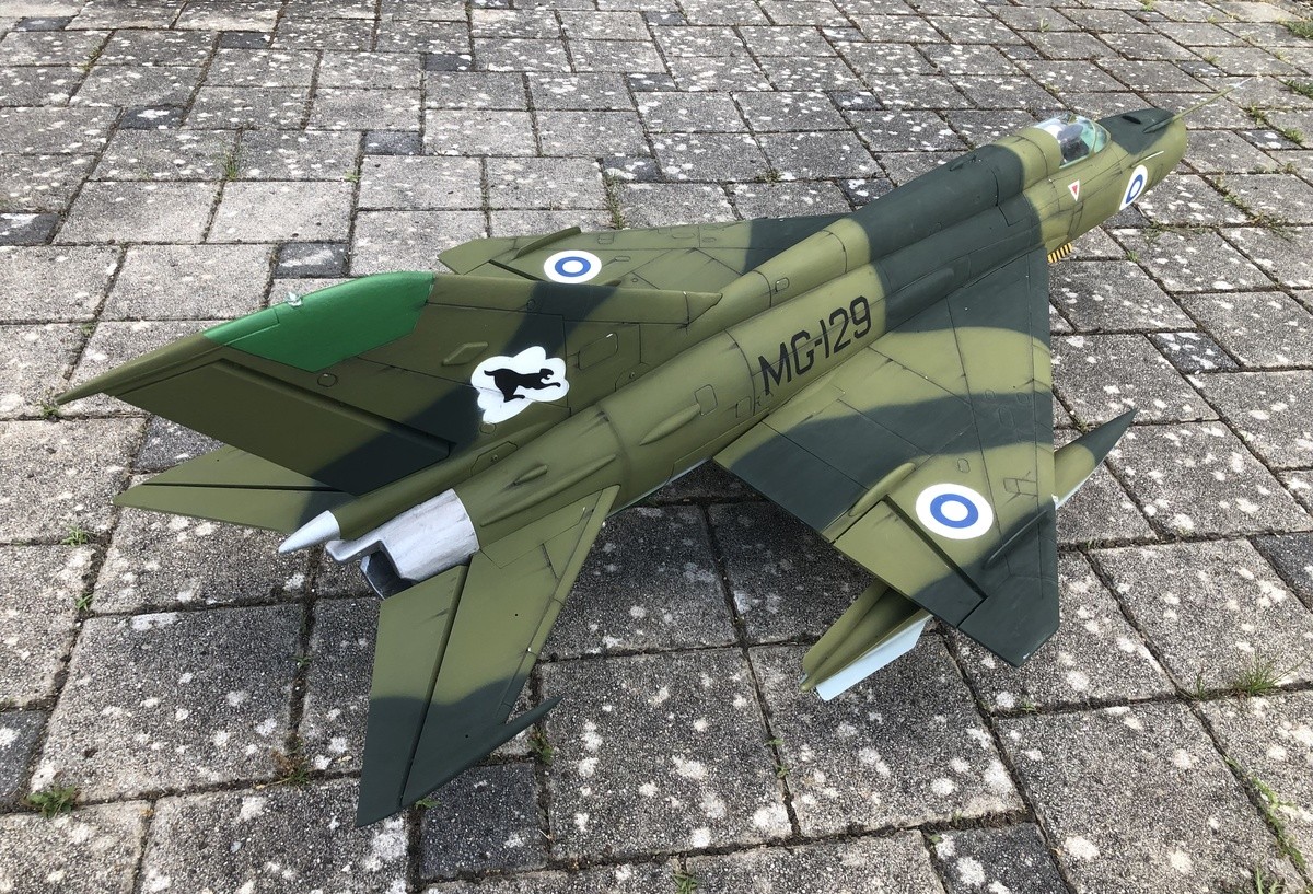

                                      • Hello everybody!
                                        The MiG-21 is my first edf jet and the threads here and on rcgroups have been very helpful in preparing my MiG-21 for the first flights. It's a great model, much fun and thrill to fly, especially with other jets in the air. My brother has built a FlyFly Mirage last summer and persuaded me to buy an edf model, too. I like the classic jets and the MiG has always been one of my favourites. Since October last year I count 60 flights. No need to be nervous anymore but I'm still improving my landings on our narrow landing strip.
                                        First flights have been in silver with a bad visibility in winter weather but silver is a good basis to apply a different colour scheme. I installed the Multiplex lights which are great for sunset flights. Landing lights are installed in the wheel bay in a slight downward angle and I can switch them on/off via the transmitter.
                                        When doing research on the internet I found a huge variety of colours and the decision what to choose was difficult. In the end I came up with the rather simple but rare Finnish version. The advantage is a simple pattern (easy to apply) and huge markings so it's possible to recognise details in a low flyby, even reading the aircraft number on the fuselage.

                                        • Nicely done Timo. One of the more aggressive color schemes for what is anyway, an aggressive design shape. Should be a very good scheme for orientation purposes.
                                          Almost makes me go out and buy another silver version before they stop production .
