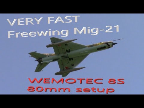

      #822

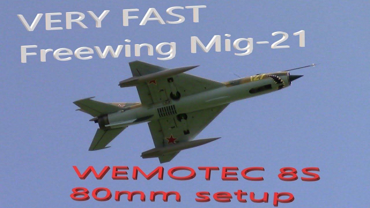

      One week ago I attended a very nice EDF meeting in Germany with my Freewing Mig-21 and I recorded this cool flightvid from another pilot who uses the same 8S Wemotec setup as I have in his Mig-21.
      Enjoy the vid!

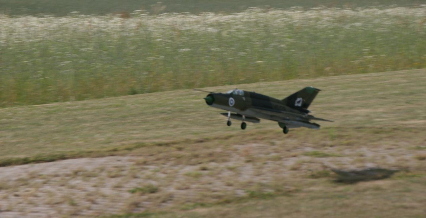

        #823
        Nice video, thanks :-)

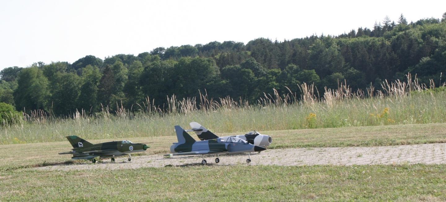

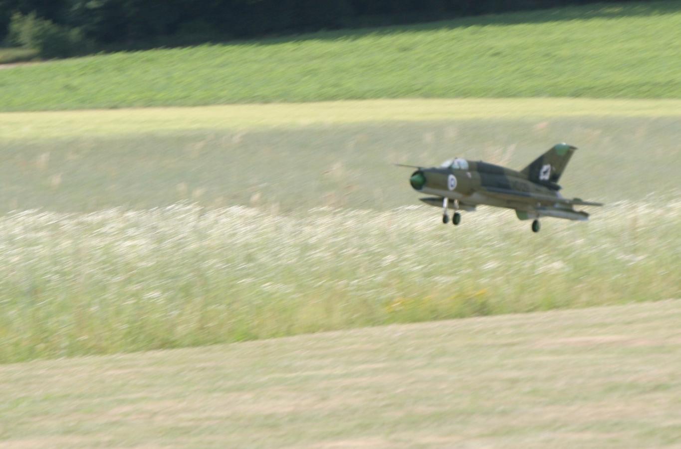

        I have some new pictures of my Finnish MiG from the recent days of flying, several times in a nice 3 and 4 ship formation. Mock dogfight is impressive with these models.

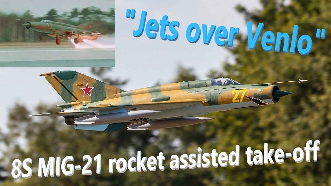

              M U S T S E E
              Probably one of the coolest FW Mig-21 vids :):):)
              At the Venlo (NL) EDF meeting 2 weeks ago pilot Hans-Gerd demonstrated his rocket assisted take-off thanks to a booster mod.
              Enjoy the vid!!!

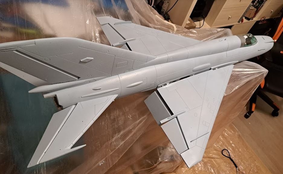

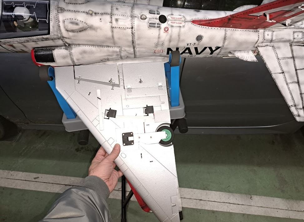

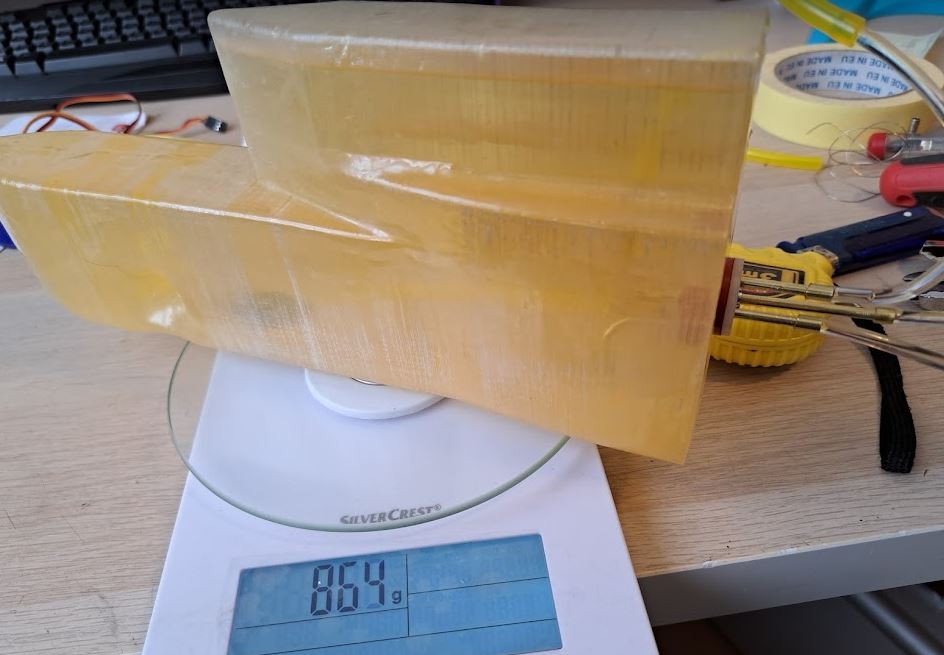

                    #829

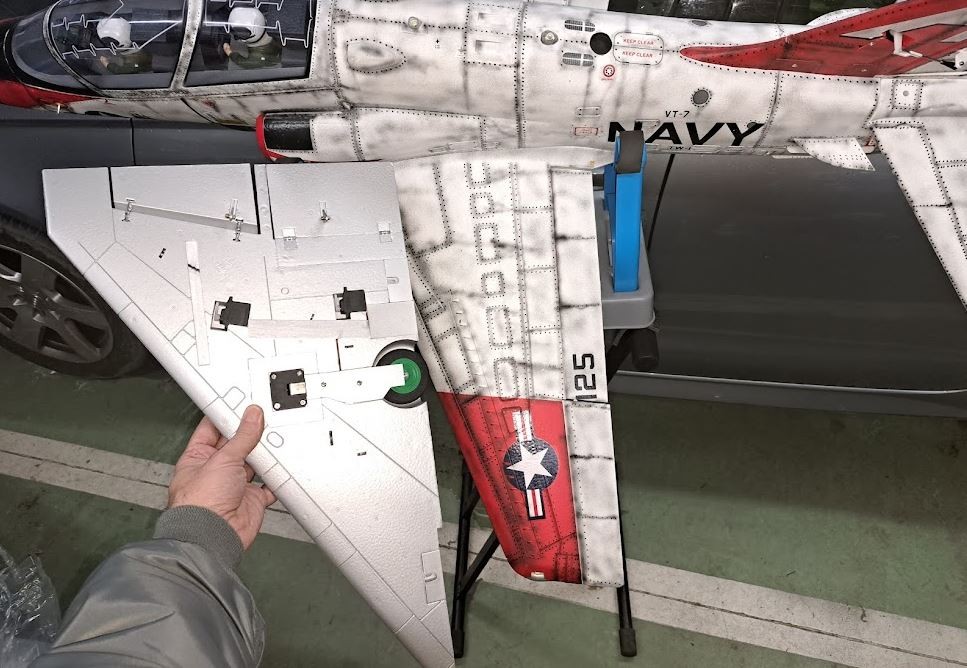

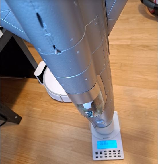

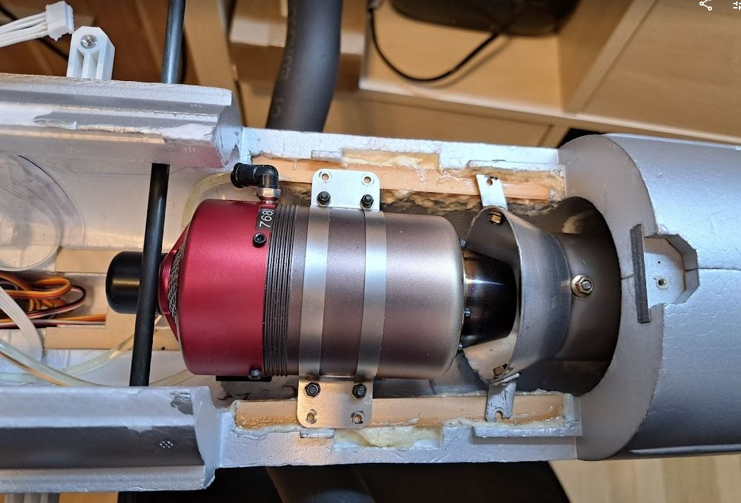

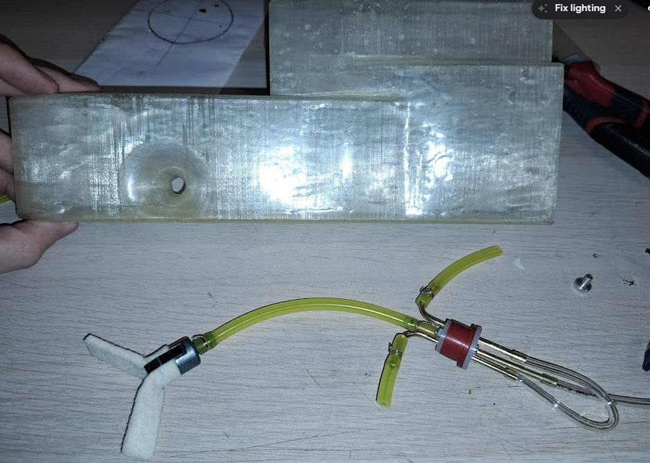

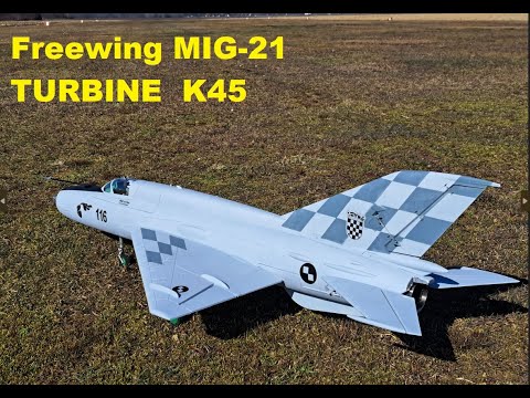

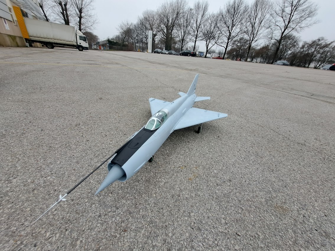

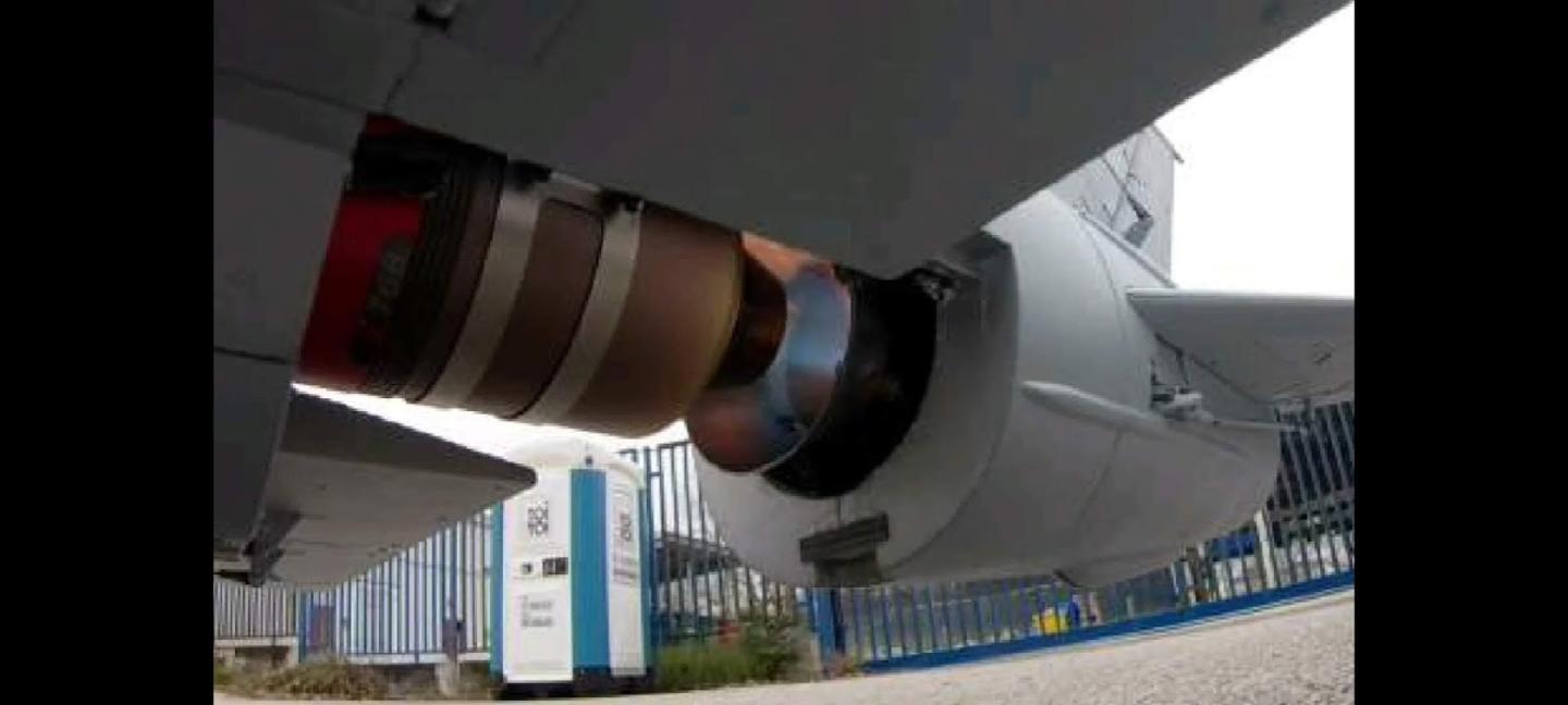

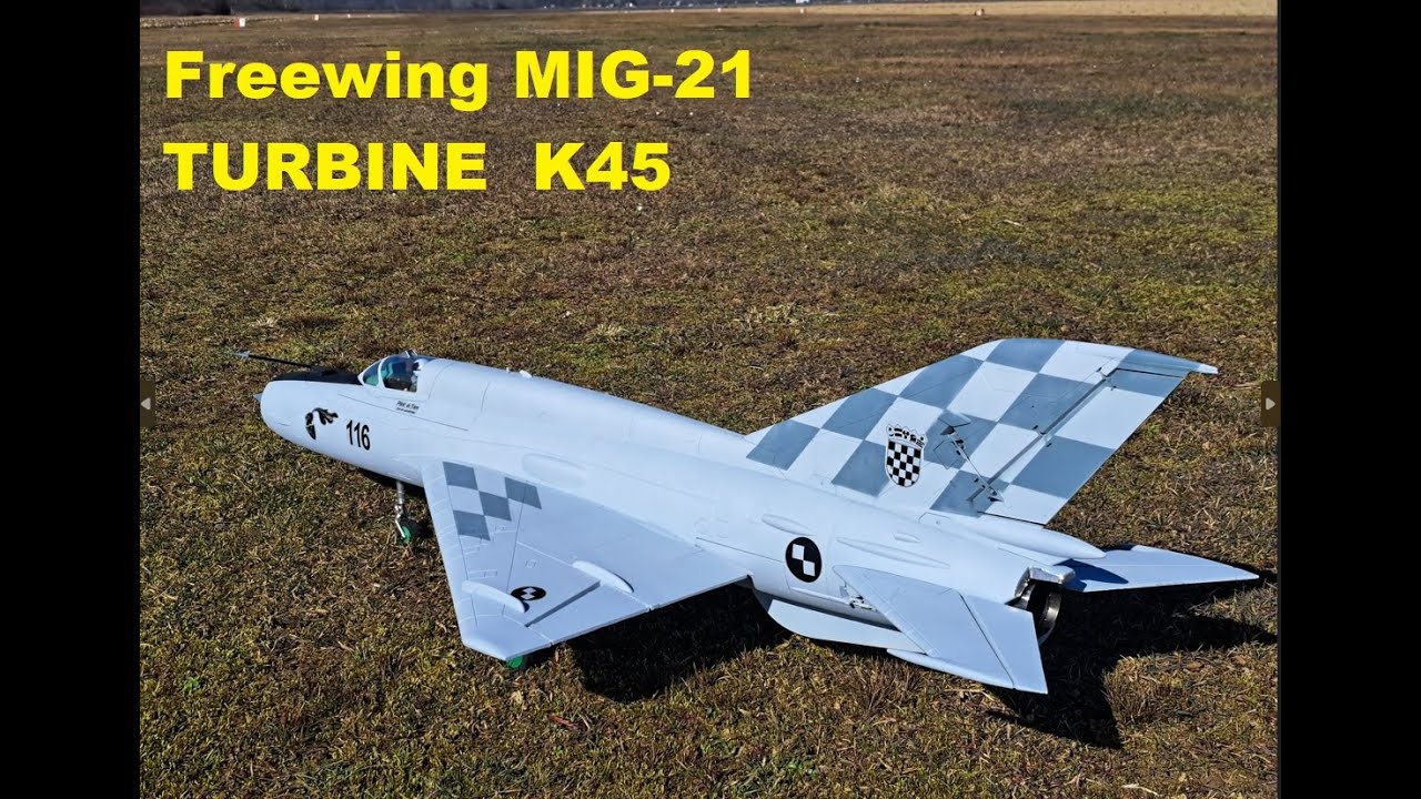

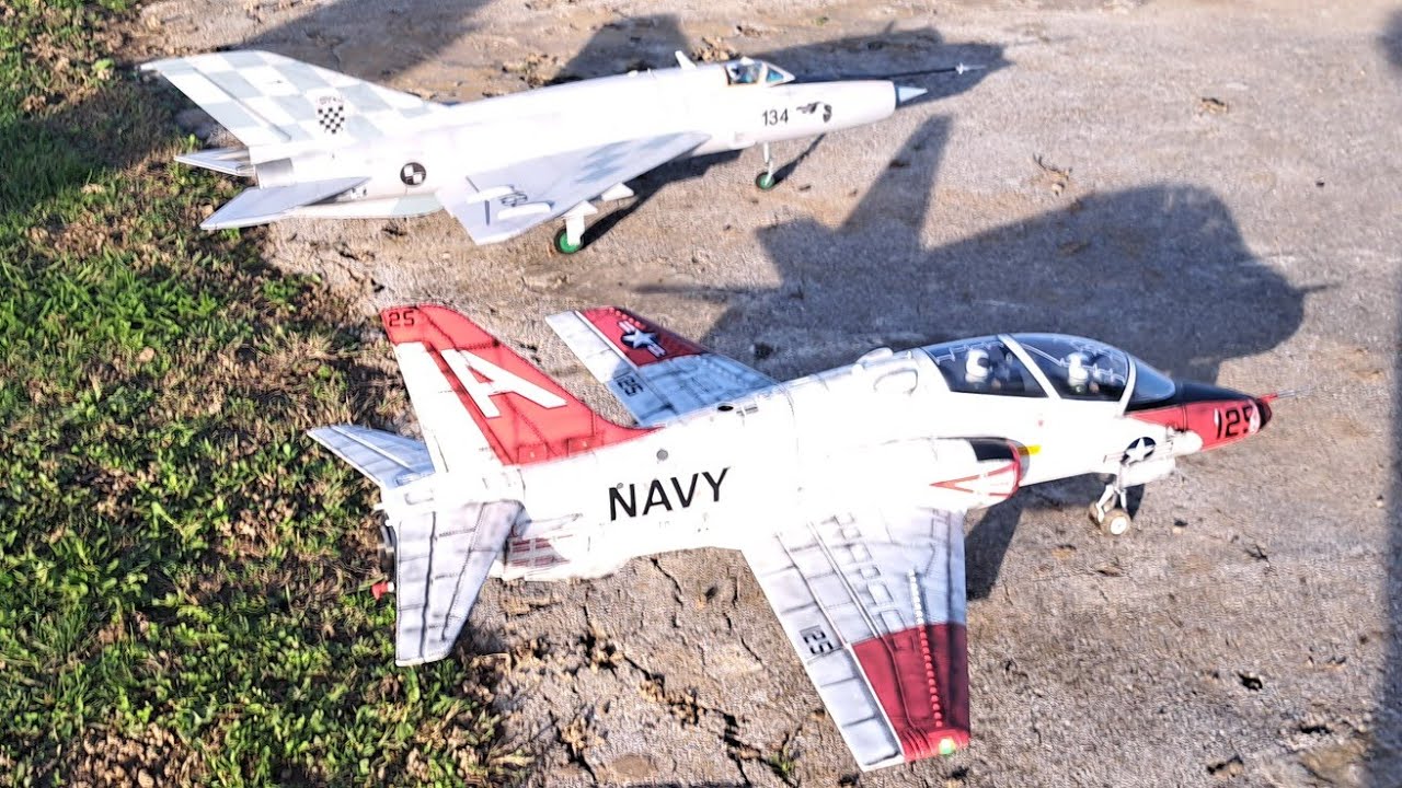

                    same wing area as much heavier freewing T45 (5200g) vs Mig21 3600 g !
                    should be fun with more thrust than weight (4.5kg turbine)
                    CG 28cm, if 30% of left fuel sloshes back on approach with nose up it even reaches 29cm,
                    and when it is full CG is 27.5 cm.
                    landing and rollout on asphalt will be fun since idle speed thrust is somewhere near 1/3 of an EDF unit,
                    will need JP brakes for a complete stop.​

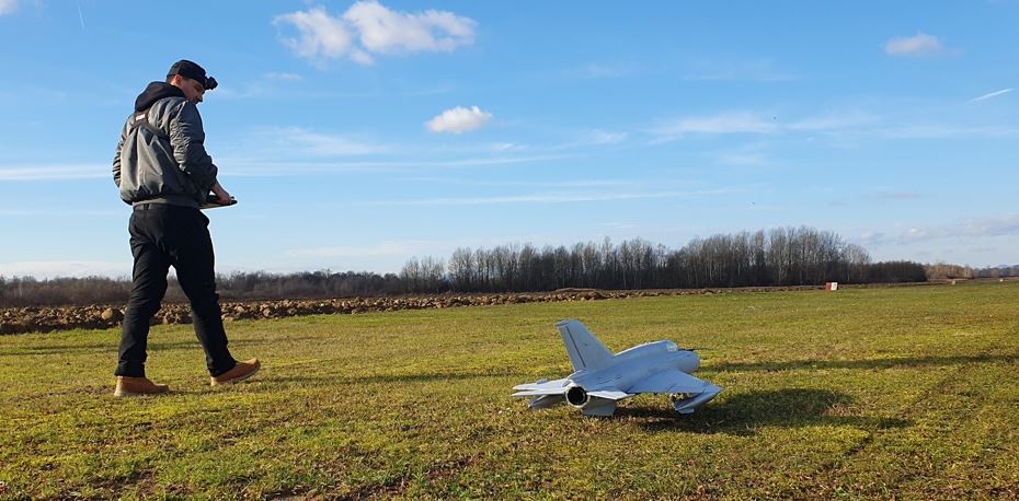

                      #830
                      centerburner test passed :)

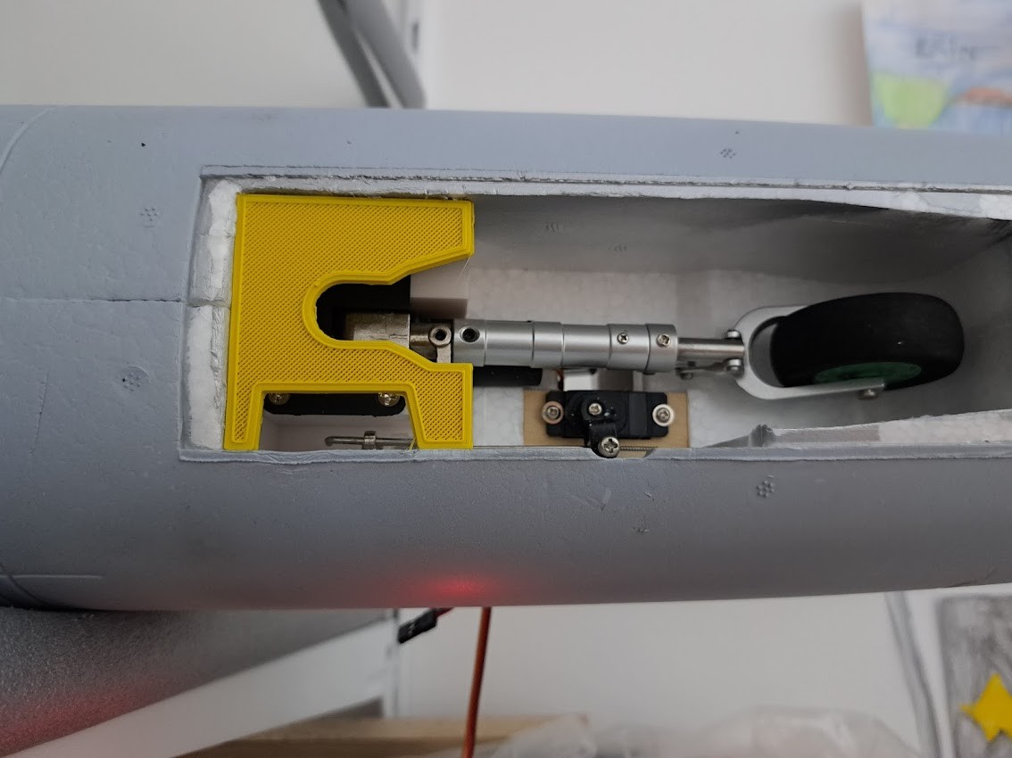

                        #831

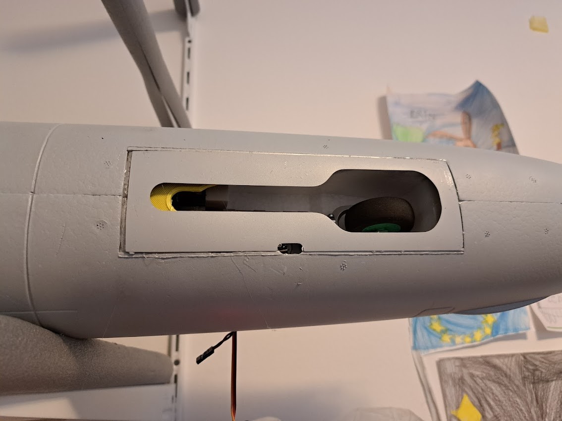

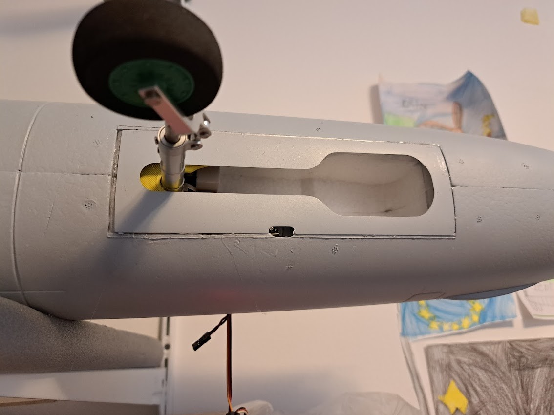

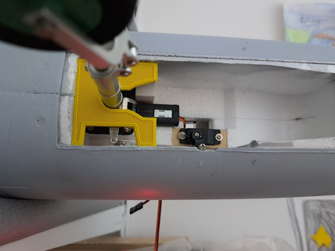

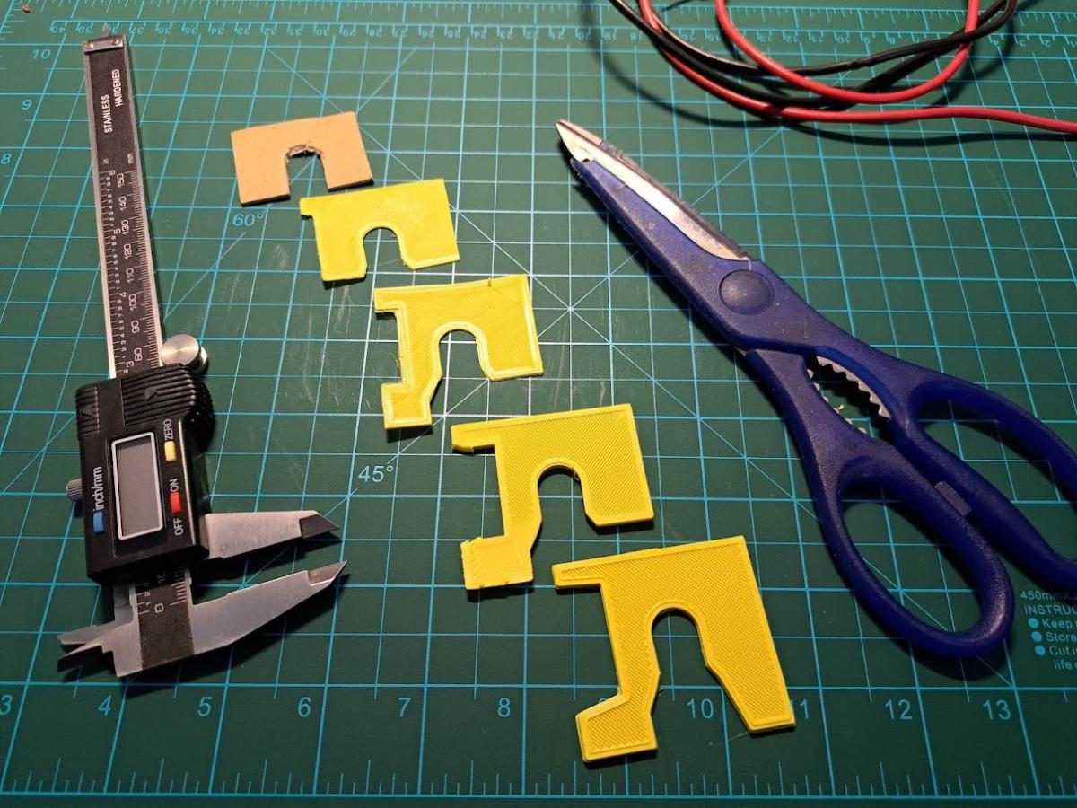

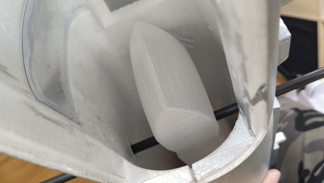

                        could not find a free nose gear brace, only some that required paying for it??!?
                        LOL
                        so sketched mine and during few prototypes I got it to fit snugly and not interfere with steering.
                        enjoy if you need it
                        https://www.thingiverse.com/thing:5749757​

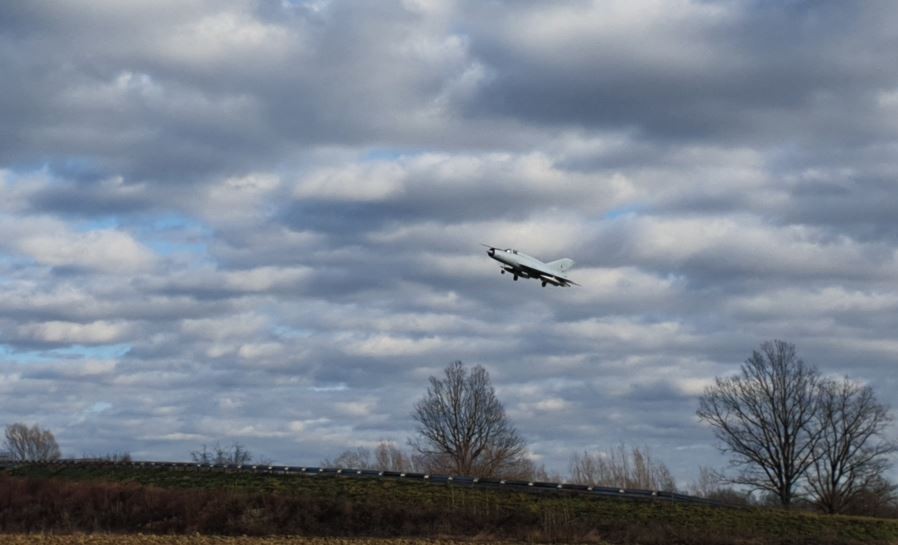

                          #832

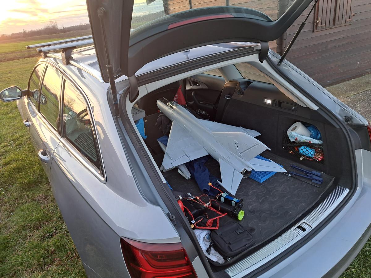

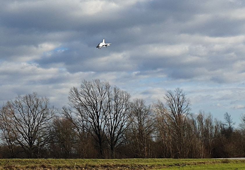

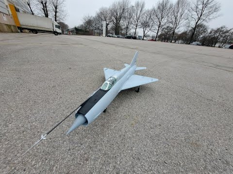

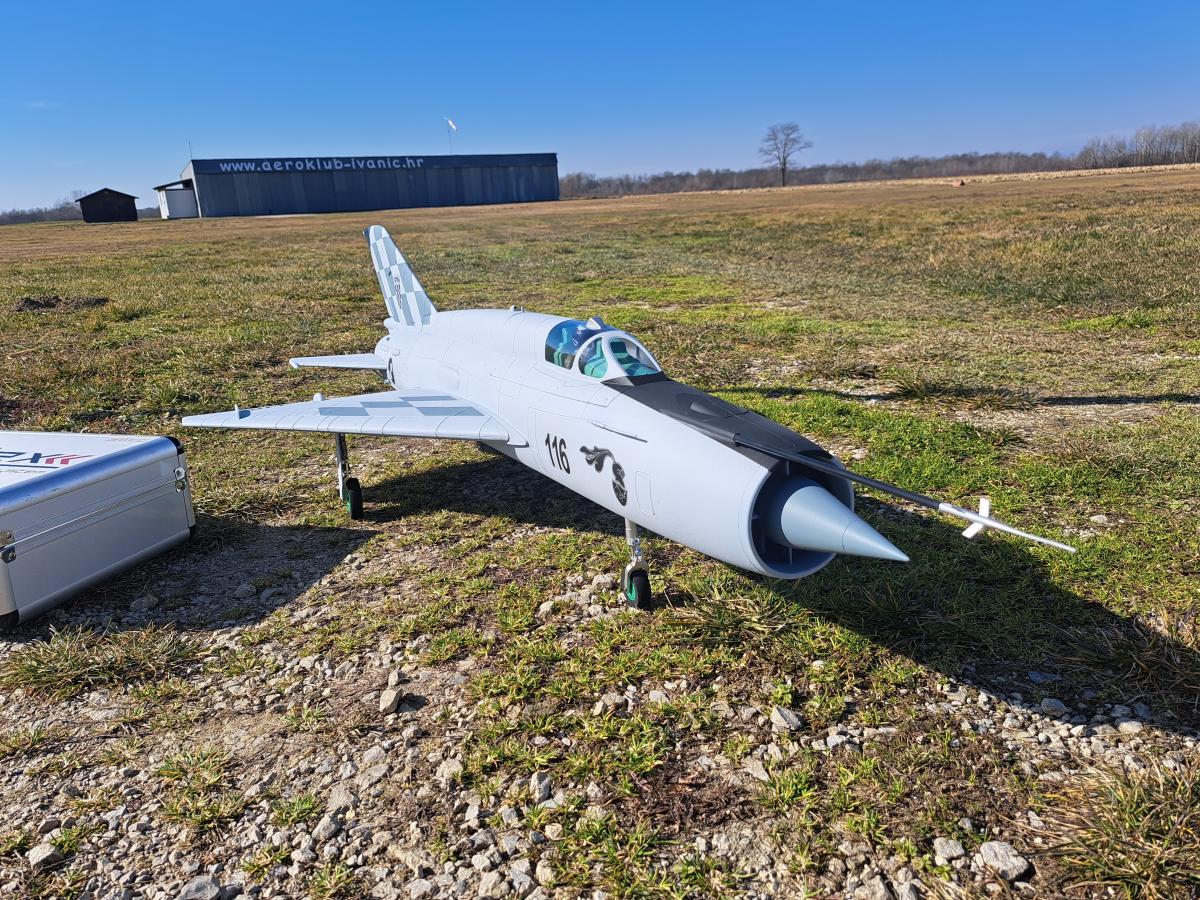

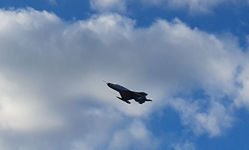

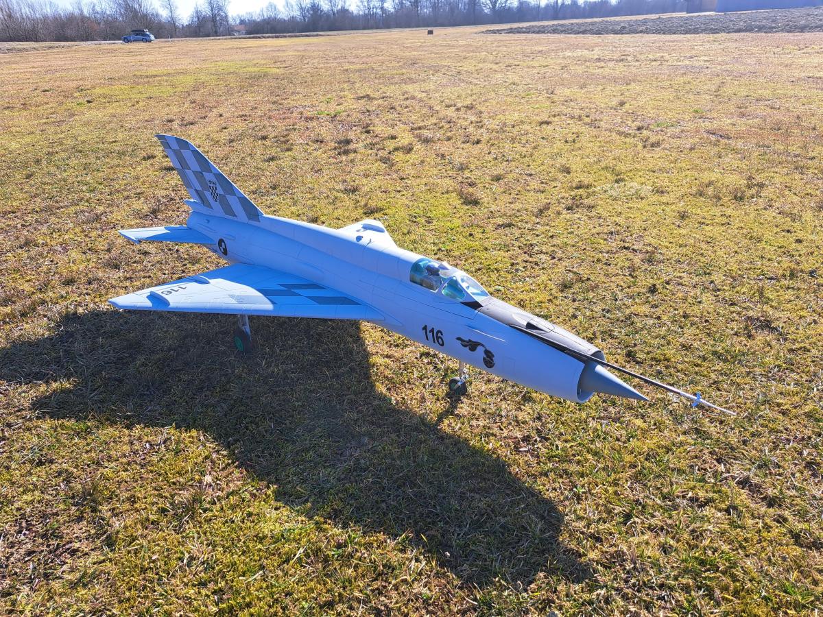

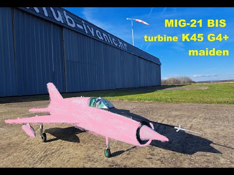

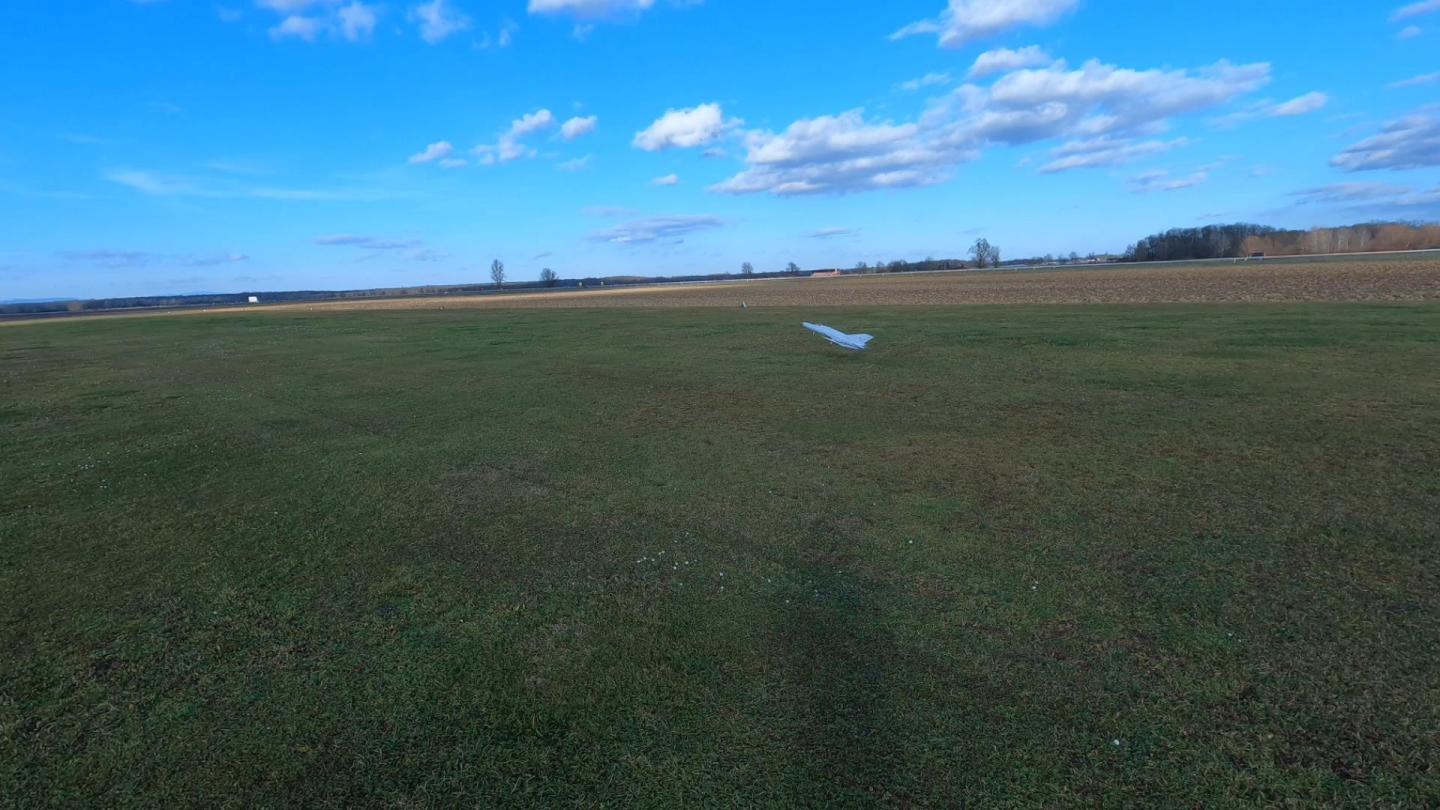

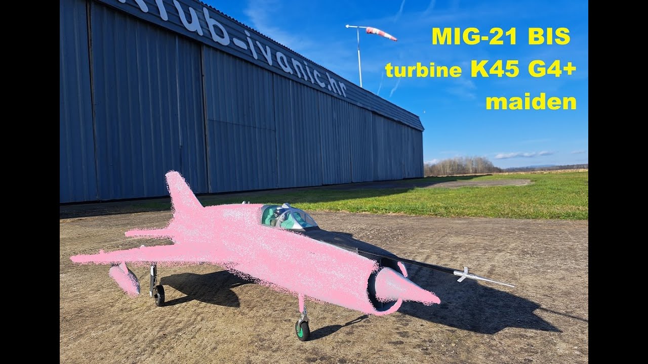

                          maiden done today on really strong(40-50kmh) 90° crosswind .
                          it was a handfull flight but all ended perfectly, landed on 3 wheels after 45° high alpha approach.
                          cant wait to fly it on calmer day or when wind is not 90° to the strip​
                          • dr.Tom
                            • Feb 2022
                            • 68
                            • Croatia
                            #833
                            https://youtu.be/NPNtAyuMhIw

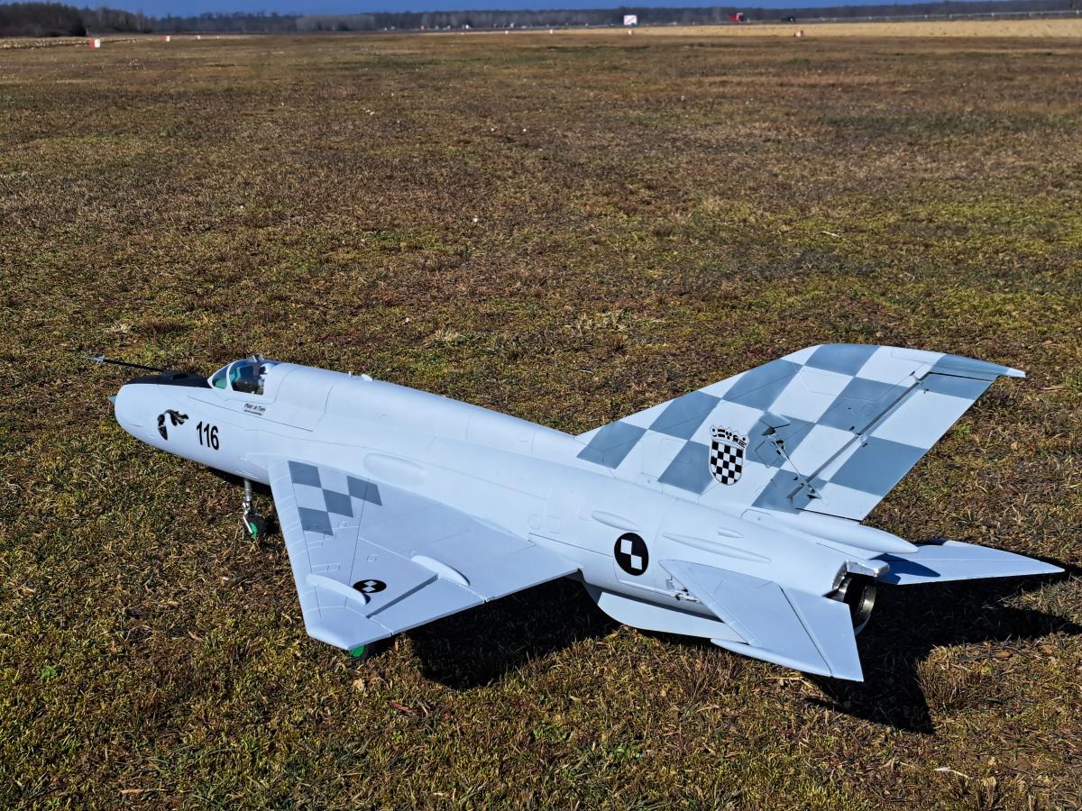

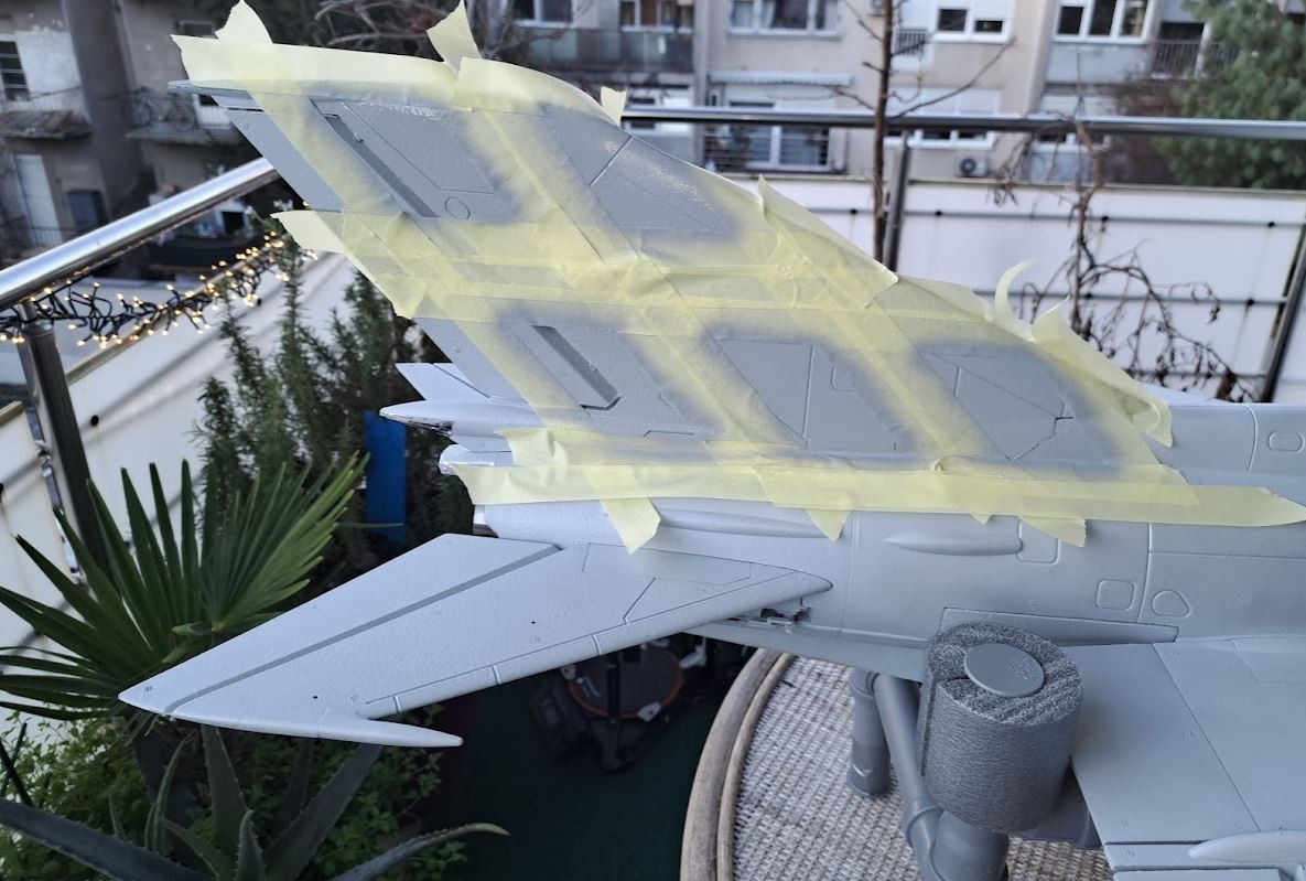

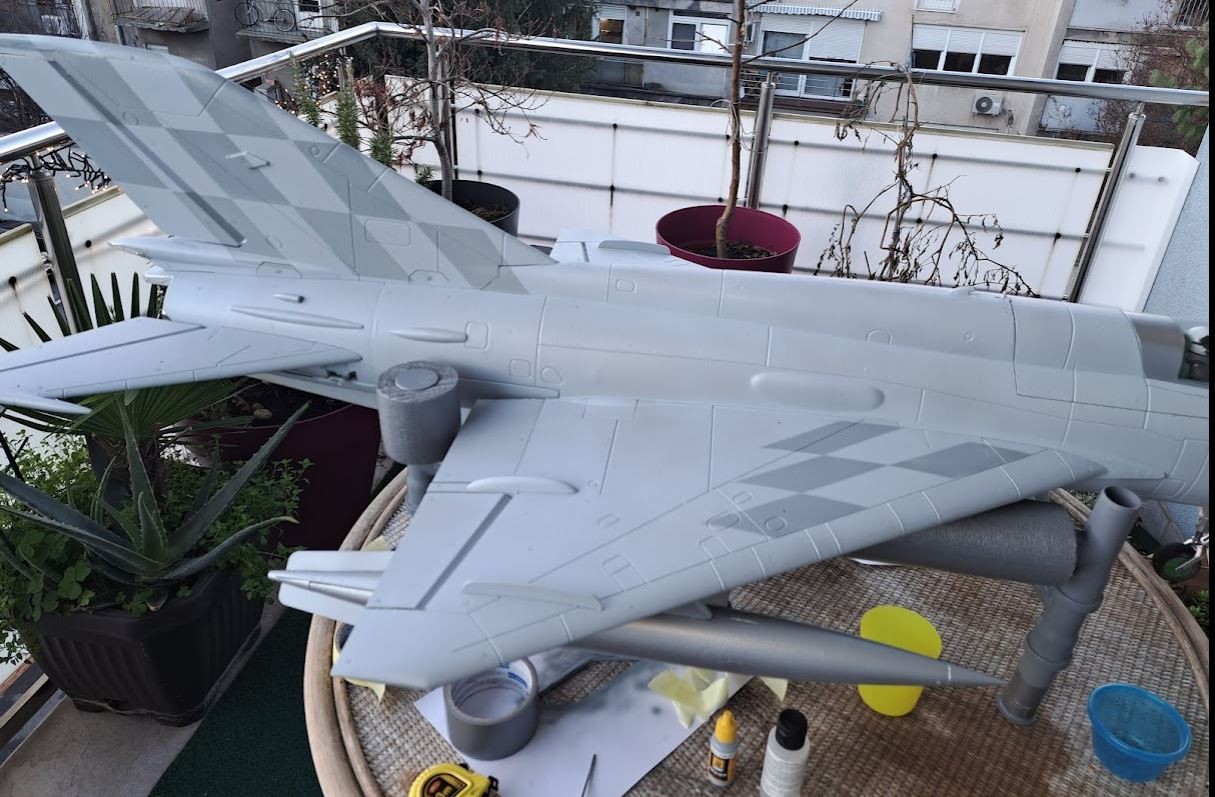

                              #834

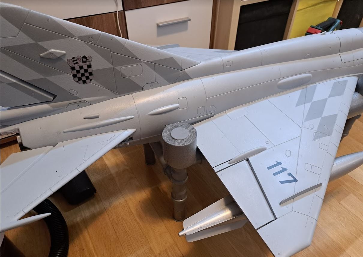

                              NATO livery...
                              • dr.Tom
                                • Feb 2022
                                • 68
                                • Croatia
                                #835
                                • SanExup
                                  • 912
                                  • Western Wy.
                                  #836
                                  Nice work! It looks good. I'm actually excited to have seen a few full scale Mig 21s in museums. I don't know if it's like the AK of old fighter jets in terms of ease of museum procurement. But I've seen 3 different ones in the 3 different museums that I've been to recently. None of them look as good as your model.

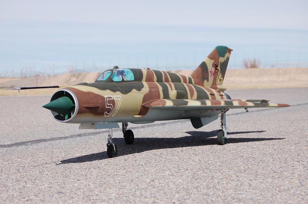

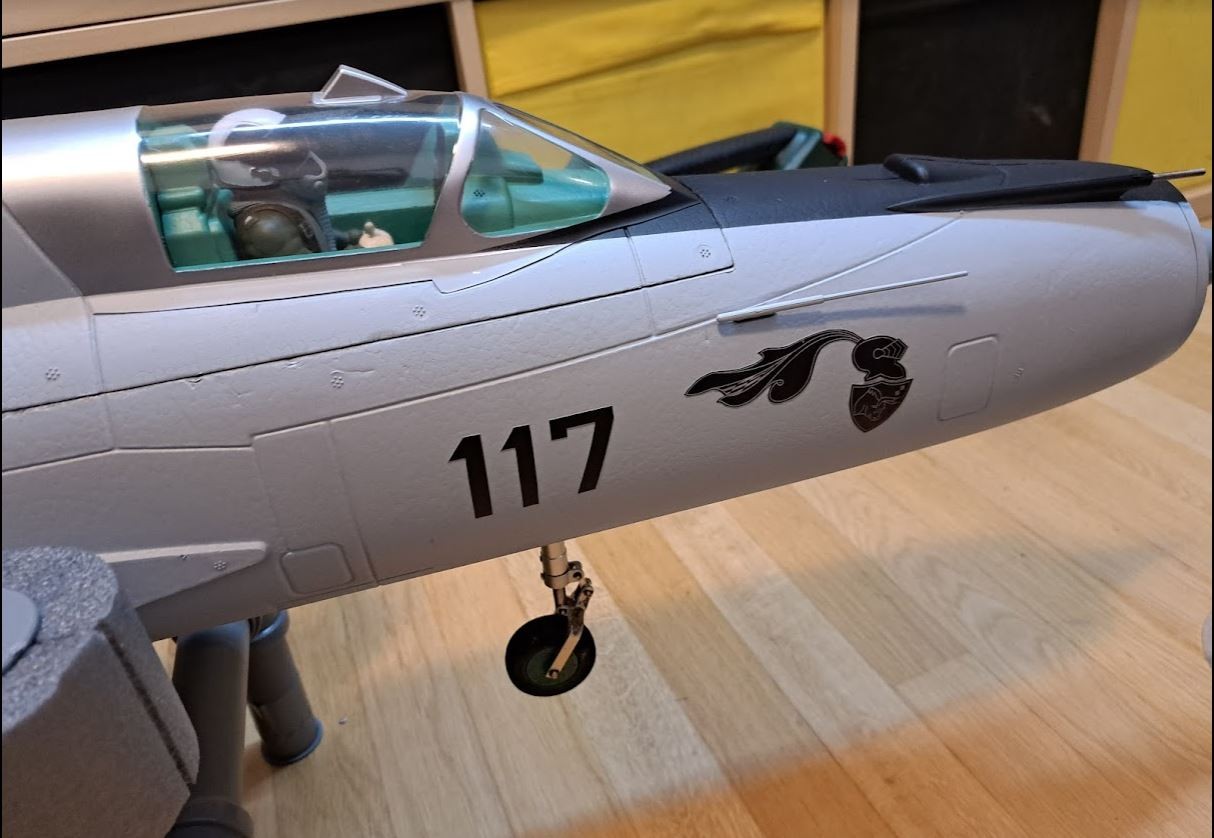

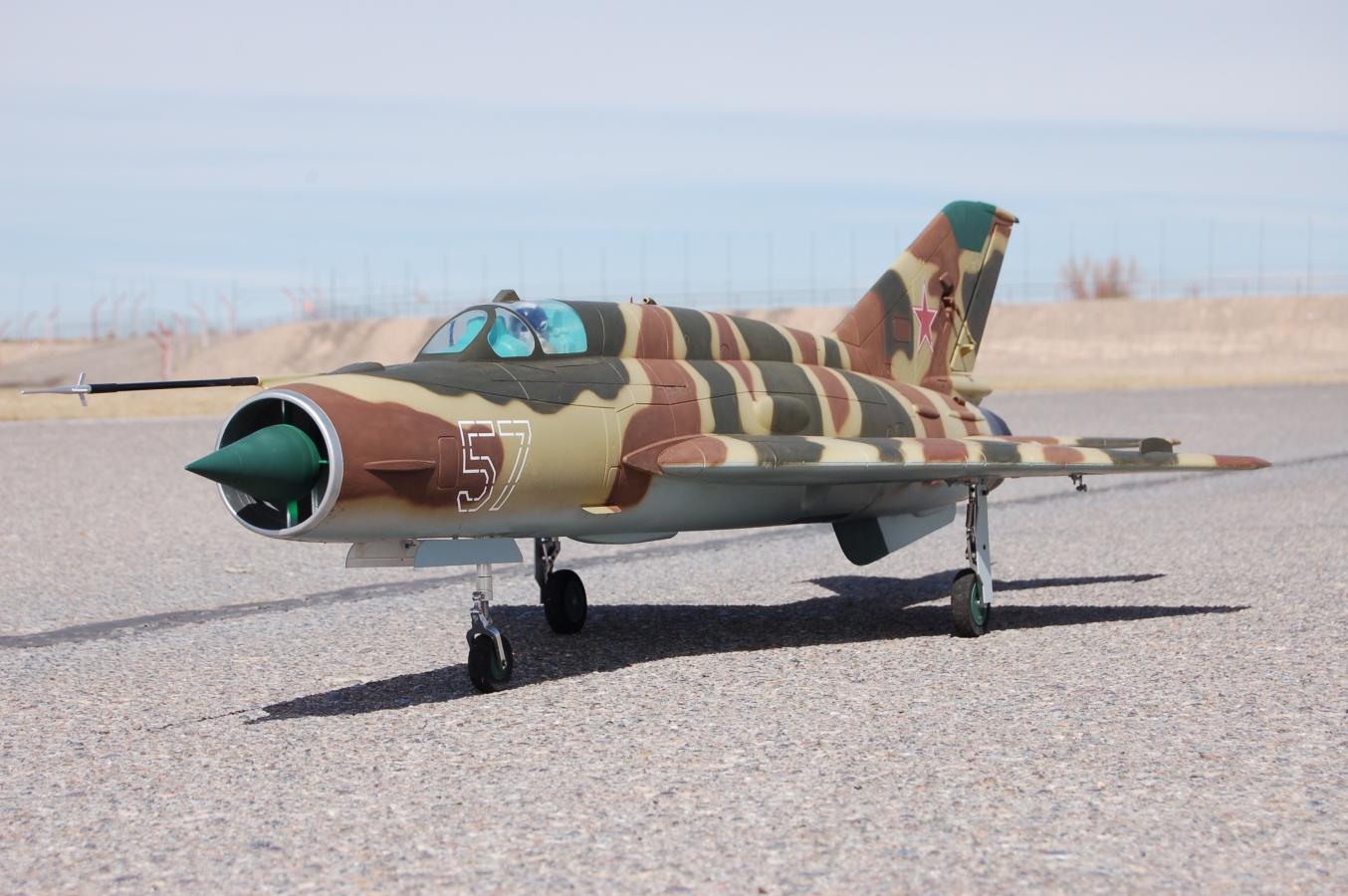

                                    I have a new silver one coming from RCCastle. When I didn't see them anymore at Motion, I emailed them to confirm that they were gone. The feed back bummed me so bad, I went to Castle and they showed backordered. So when they came back up just recently, I bit the bullet and pressed the button. Got some parts and the new Assan Brakes/Gyro coming too. My last one had a modded burner in the tail and the front nose gear doors. This new one I plan on doing those mods and making the stab full flying as well. Here's the last one... Click image for larger version

                                      Wow, you did a nice job on it, looks great sitting there too, I had two of them myself, great flyers and love the high alpha landings they can do.

                                        DCORSAIR You don't have them anymore?
                                        nuts-n-volts Yours does look good! Do they make assan brakes small enough for the Mig21??

                                          Thanks guys, she's definitely a favorite.
                                          SanExup, I just ordered them a few days ago as that was the first time I had seen them listed. Yes, there are different sizes with different axle sizes. For the -21 I ordered the "Assan 60mm V2 Anti-sideslip Electric Brake System With 4.0 Wheel Axial with AG63 Gyro" from RC-Castle. I'm on hold with that as they are back-ordered. In fact, I just checked, I don't see them listed right now on the site at all. But, Raymond told me he'd get them to me later this month. I already use the little Assan AG61 nose gear steering gyro in a bunch of my jets and it works flawlessly. I'm hoping these brakes/gyro fit the MiG and give great results.
