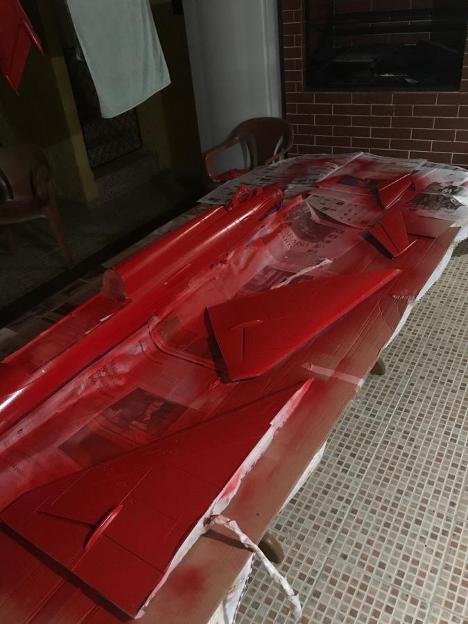

        This weekend i painted and build my Mig.
        For the paintaing, i choosed a simple version just to have a better reference in the sky...red, Russian version.
        Everything runned just fine during all the processes, and the plane is almost RTF/Maiden (3 position D/R+Expo and CG and etc)...unfortunately i noted that some times the servos present a very small/fast moviment (like some micro glitches) :-( .... they don't freeze/stop and neither desarm the RX (maybe some "noise" due the several long wires)...but i'm concerned...maybe due the long wires of this plane, this can happend (i don't think is a servo problem...i cycled all with a servo tester in the automatic for about 10 minutes before the assemble)...i dont think the paint job can affect.

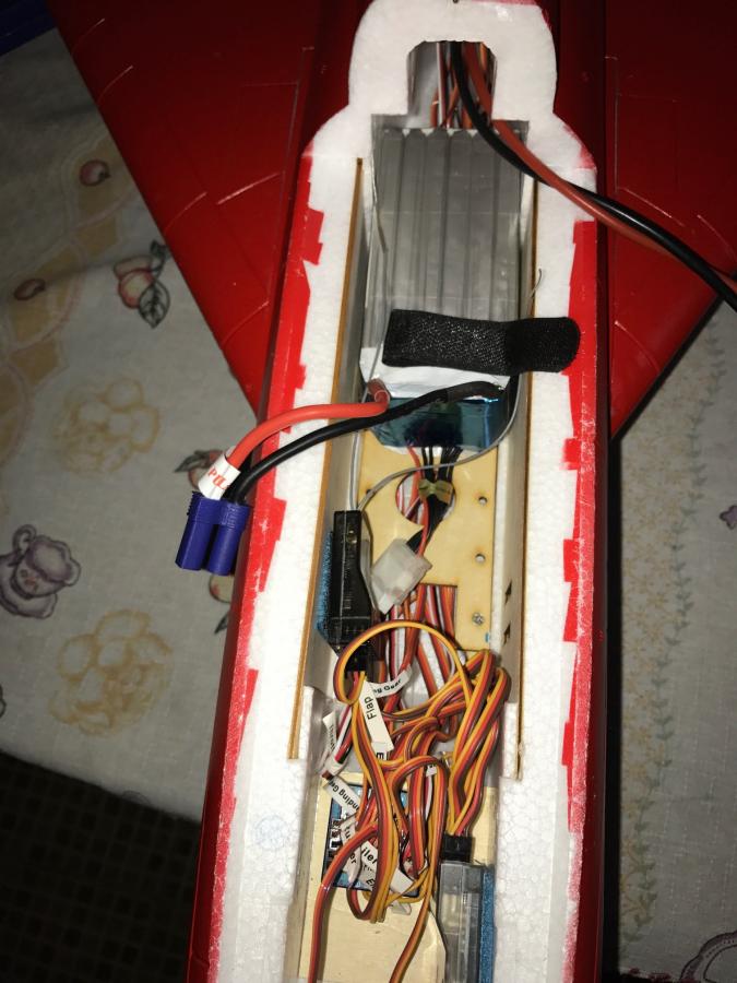

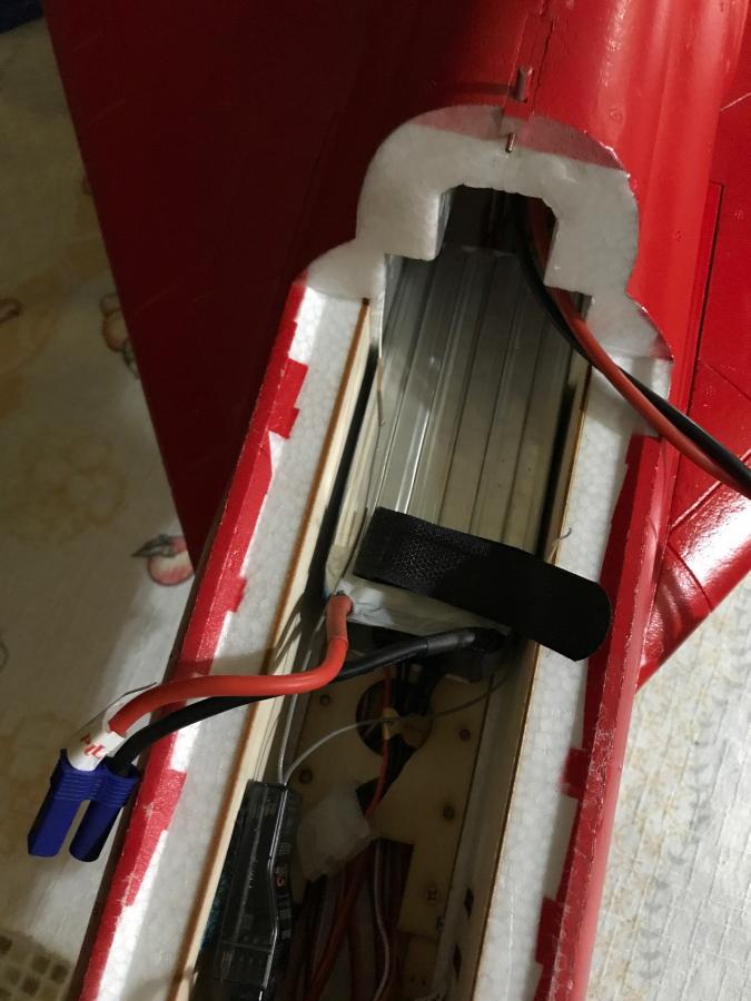

            • Good day all,
              Yesterday i made the test and, yes, the servos twitches come from the HobbyEagle gyro (in my case A3-L), no matter ON or OFF...if the connection passes through the gyro, there's the twitch...nothing related to the blue box, at all...when i connected directly from BB -> RX no twitch...anyway i'll maintain the gyro.

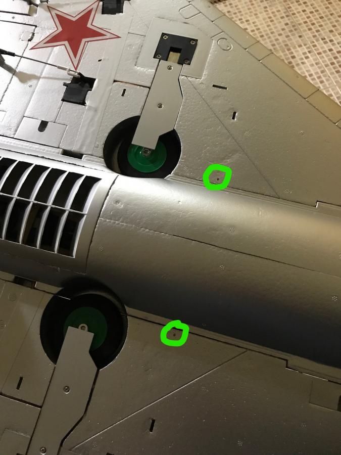

              My attention now is within the CG. I measured 275mm (as per image, green circles...comparing with other pilots images it's seems to be right) and i'm using the GensAce 5500 45C (755gr)...i'm seeking the "sweet spot" but must confess that i'm strugling more with this model than other ones wich i presume is because of the delta wing) to keep it perfect leveld...i attached some pictures for our collegues to comment if i'm doing in the right way...i know this plane can handle CG differences but i want to avoid any risk or big mistake.
              I'll be thankful to receive some comments about the battery placement, if possible.
              Thank you all and safe flights

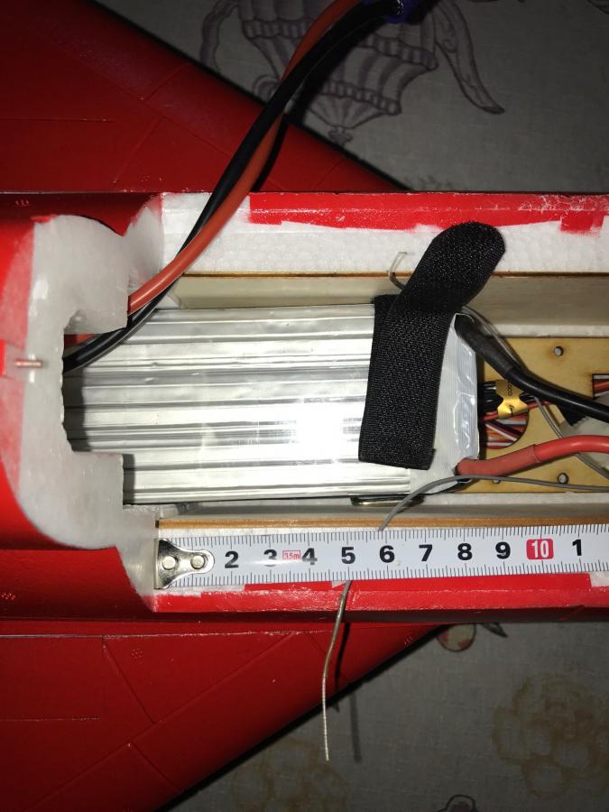

              • The Mig is a lot easier to balance inverted since in essence, it is a low wing model. I'm really amazed that you managed to get your Gens Ace 5500 pack to go in flat. I run the same packs in mine but have to stand them on their sides.
                I can check after I get home and see where my location is.

                  • Originally posted by bill34207 View Post
                    Hey there Bill,
                    Thank you very much for your reply.
                    Honestly i was planning to use the battery "upright", probably like you use yours...is more confortable to move around for sure. Anyway as you can see it fits like these, but very tight. Maybe i´ll use upright in the end.
                    Yes please, if you can send me images (with some measure) about your placement it´ll help me a lot! Considering that you use the same battery (gensace 5500 45c) i´ll follow the same place you´re using and will test inverted like you do (retracts extended?).
                    Cheers and safe flights

                              Got home from work and shot some quick pix of battery location and my CG point. More information shows when photos are opened.
                                Thank you very much Bill! You really helped me a lot with the images and complete explanation.
                                As i can see on your image 2, your battery is ending around 4'1/4" (~ 110mm) from the "canopy behind wall" right? Also based on the velcro strap, is clear that your battery is ahead of mine ( mine 3' 3/8" or ~ 85mm).
                                Your CG dot (your image 1) is 275mm from the wing leading edge?
                                I'll update my CG dot after your reply, reposition my battery like you showed and return with the results.
                                Cheers
                                • My digital caliper doesn't go big enough to measure that far. It's 10-5/8" from wing leading edge at the root to the mark. Running that through the calculator it's around 270 mm. This model is pretty forgiving on CG.

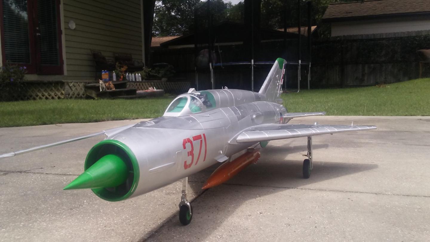

                                    • Got my Mig 21 ordered, it will be here next Thurs. Wasn't going to do another 80mm but it looks like fun so I had to try one. Will be asking questions I'm sure......:Cool:
                                        I wish I could watch these videos from where I'm at right now.
                                        Cashmoneybrother, I really like your centerline tank. It's a good look on this aircraft, and aids visibility, too. I did the same with one of my Freewing 80mm Mirage models.
                                        Thanks, I painted it orange to give it some contrast when it's up in the air........I'll find out tomorrow!!!
