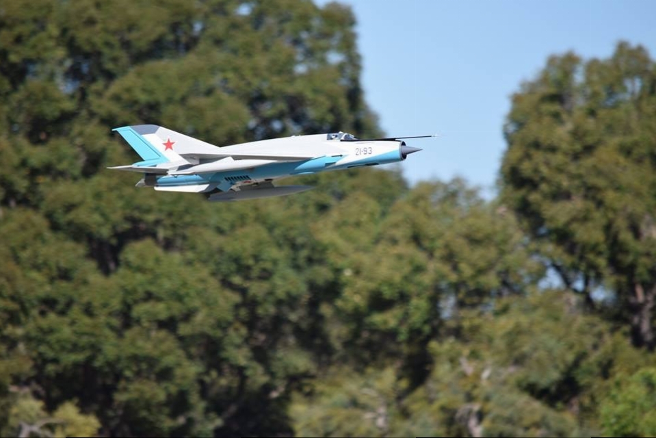

  • Shirty

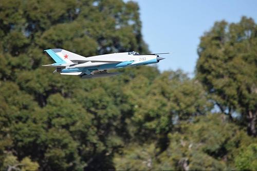

    Pic from the weekend. ::) agreed, check your esc settings as well jay. As an example, having brake on, will reduce your watts by at least 20%. The esc should be set up fine, I've never read of a freewing one needing changes but in other models it's got to me with brake set as on.
    Click image for larger version  Name:	IMG_1090.JPG Views:	2 Size:	313.4 KB ID:	73733
