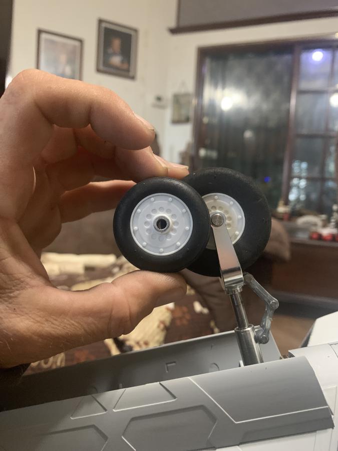

    Already have my preorder in will fit right in with my 64 and 90. One question is what pin size are the retracts the 3.1 or 4.1? Hopefully the later of the 2
    • 3D-Seth
      • Mar 2023
      • 34
      Both mains and nose gear are 4.1mm pins.

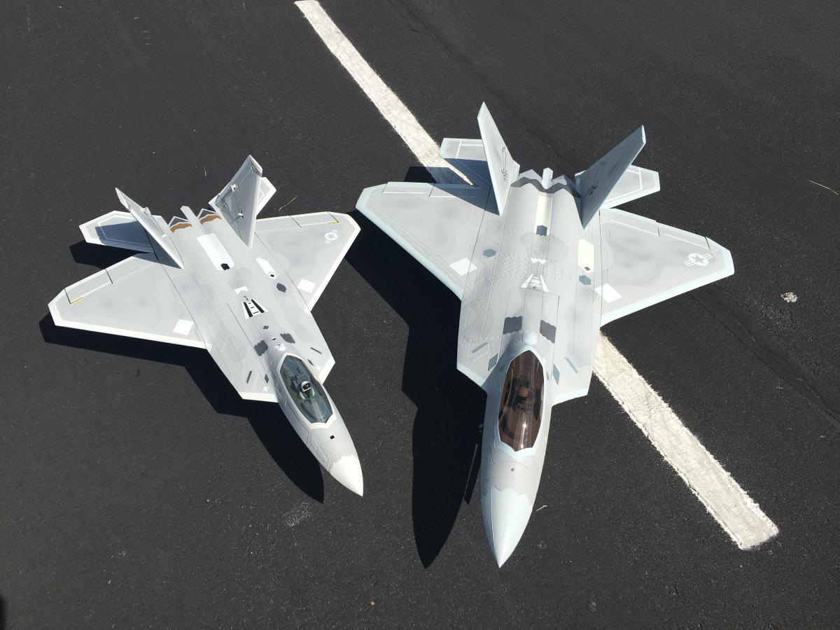

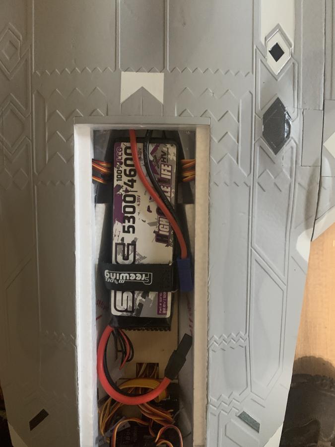

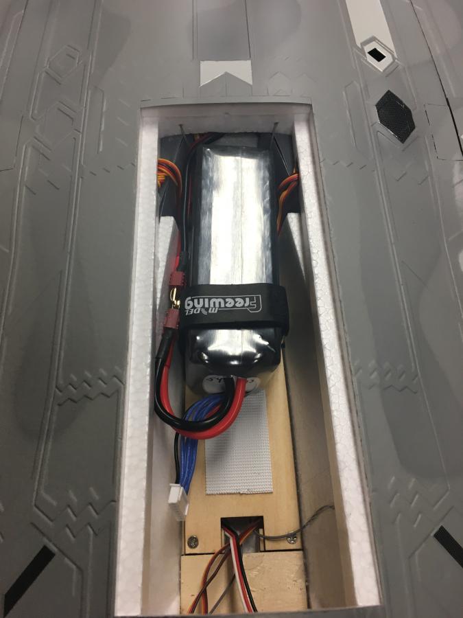

          Done, wire management, receiver and satellite under the battery tray and painted the rudder servos. Balanced with 5000 at 115. 10ch rcvr so I have reverse, tailerons and separate steering. I removed the box and did Y's.
          May do TV.
          The flaps are hinged on the bottom with flat plastic hinges. I thought of cutting a bevel in the top to permit upward travel for full span ailerons but want to see how it flies first.
          There is a ton of extra wires in this for the little black box it the front of the battery area, crazy amount.​​

            Four flights today, balanced 5mm aft of marks with 545g battery as far back as I can. One click of elevator trim and one of aileron. 150% on ailerons and 120% on elevators. Added a small down trim with ailerons to have a more linear roll. Flies great. Great flat spin with tailerons.

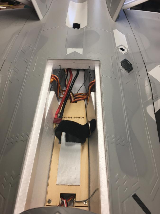

                  How did you get your wiring to get that battery back further one thing I’d like to do with mine to get CG back a little further
                    • 5385
                    Most is under the battery tray but the wing wiring I double backed it into the hole in the wing so less comes out. I took a dremel and cut the floor under the battery tray 1/4" deeper for more room for the wiring under there and to add room for the receiver and satellite under the battery tray.

                      Awesome thank you I have a couple satellites sounds like a good idea

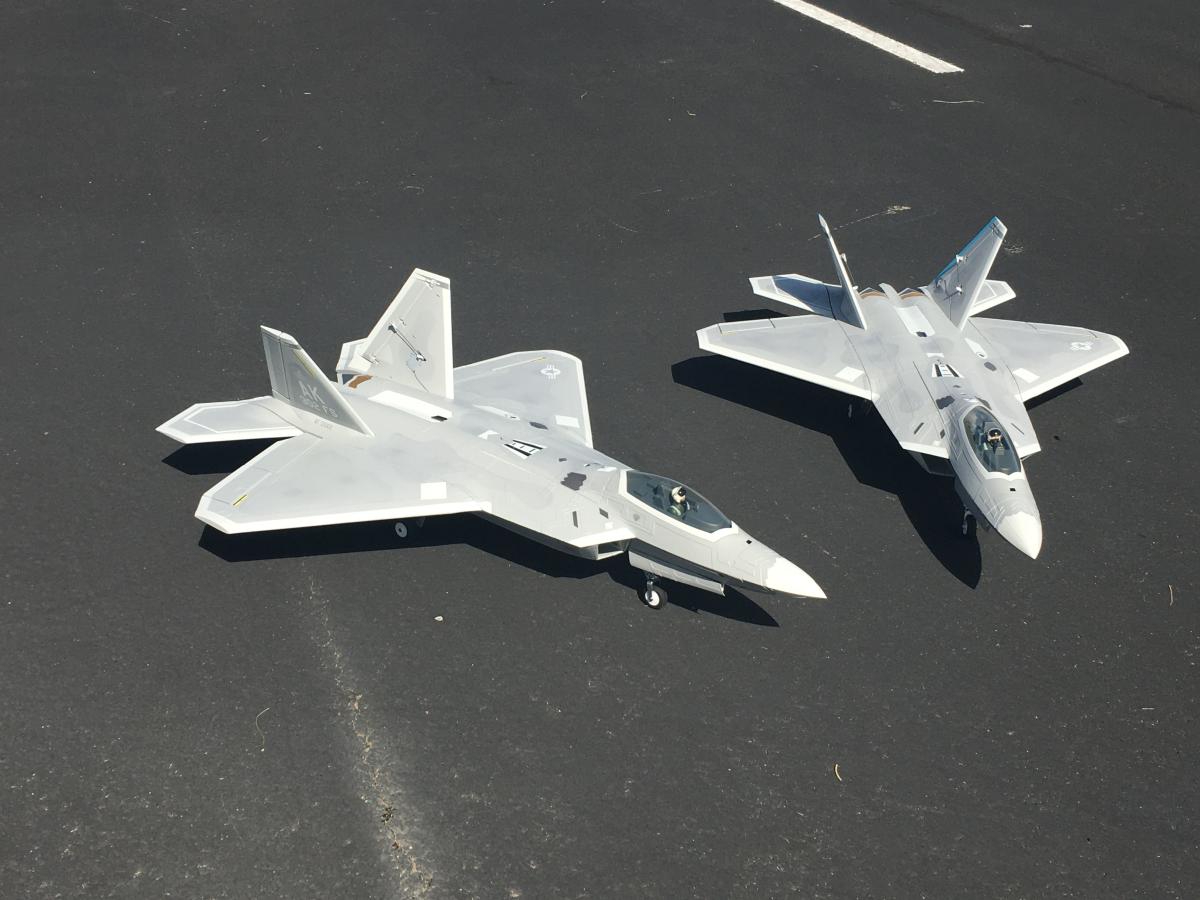

                            I’m liking it but the 90 is still my fav. Maybe with TV?

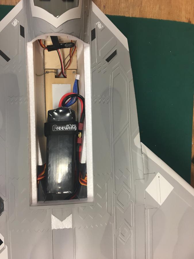

                            Click image for larger version  Name:	9A1E83FF-5EDB-46B6-A86B-7E5301043ED9.jpg Views:	0 Size:	142.2 KB ID:	411270 Click image for larger version  Name:	C2F9EB25-BD7C-467D-B86C-880048483C85.jpg Views:	0 Size:	127.8 KB ID:	411271 Click image for larger version  Name:	427D1334-AD10-4ABC-AC16-E4B747F3EC1A.jpg Views:	0 Size:	102.2 KB ID:	411269

                              I got mine to balance right on the CG marks with a SMC 4400. I made a small platform just above the servo box for the LemonRX 7ch rx. I have the satellite rx at the other end of the battery bay.

                                I did the battery tray mod now I fly tail heavy just me can now get packs way back. I flew 20 flights yesterday went from SMC 59/5100 53/4600 4400lipo strd 44/3800 to an admiral 4,000 pro pack. I’ll post a pic of my batt placement, the second mod I have done is to replace the tiny front wheel 🛞 probably fine on pavement not so hot on grass for me anyways. I used the FW F16 main wheel opened the axle up works great rotation not an issue anymore. I can say the Raptor is wicked fast wasn't doing speed passes but here’s the speed from what I consider reg flight. I still like my 90 better but wow is the 70 a work of art in this size, retracts holding up great, I do a rubber support to help save the retract mount. KMRC blue burner came in yesterday about to install charge some packs and take her back out today. Cheers FW Motion on another excellent plane

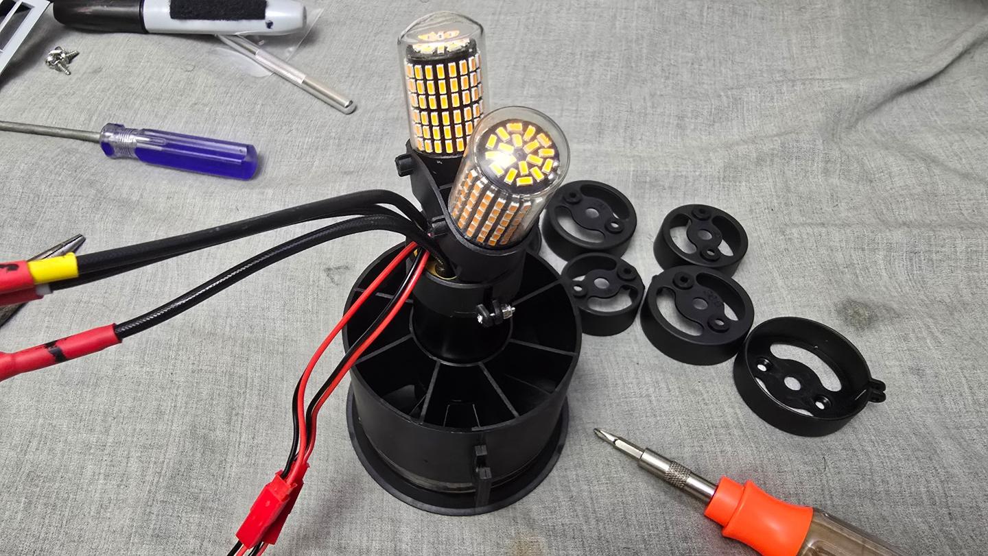

                                  Just installed the dual afterburner. the 29mm adapter is the best fit. Hope to maiden soon, maybe tomorrow with video.
                                  Here is a short demo video:
