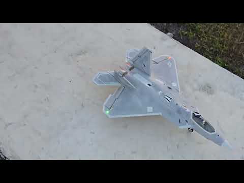

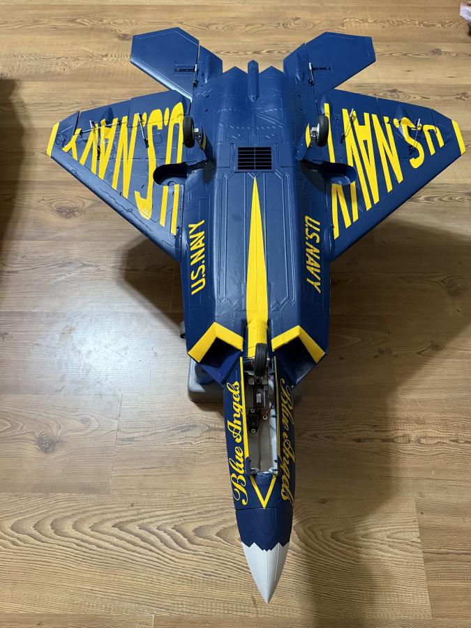

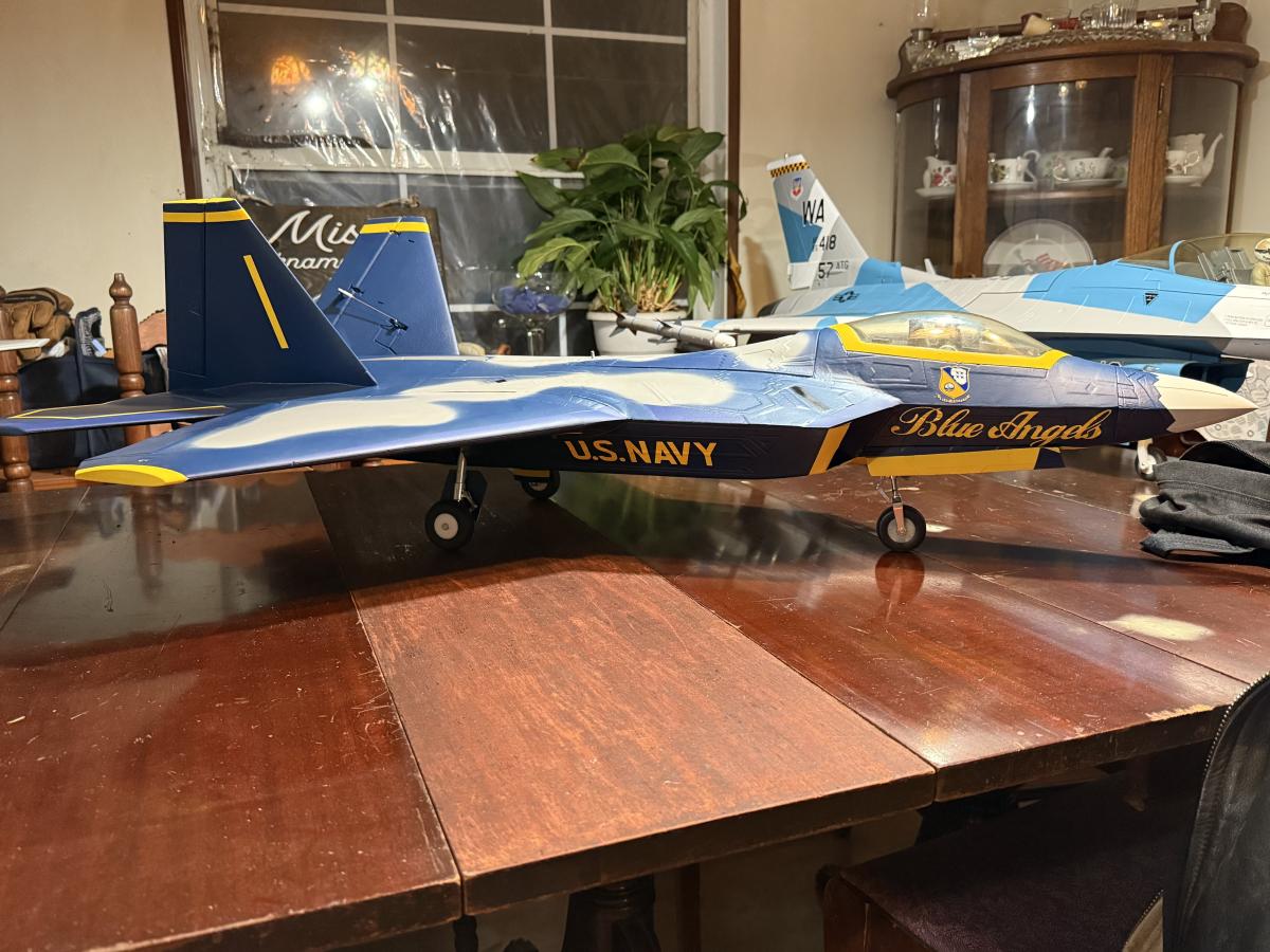

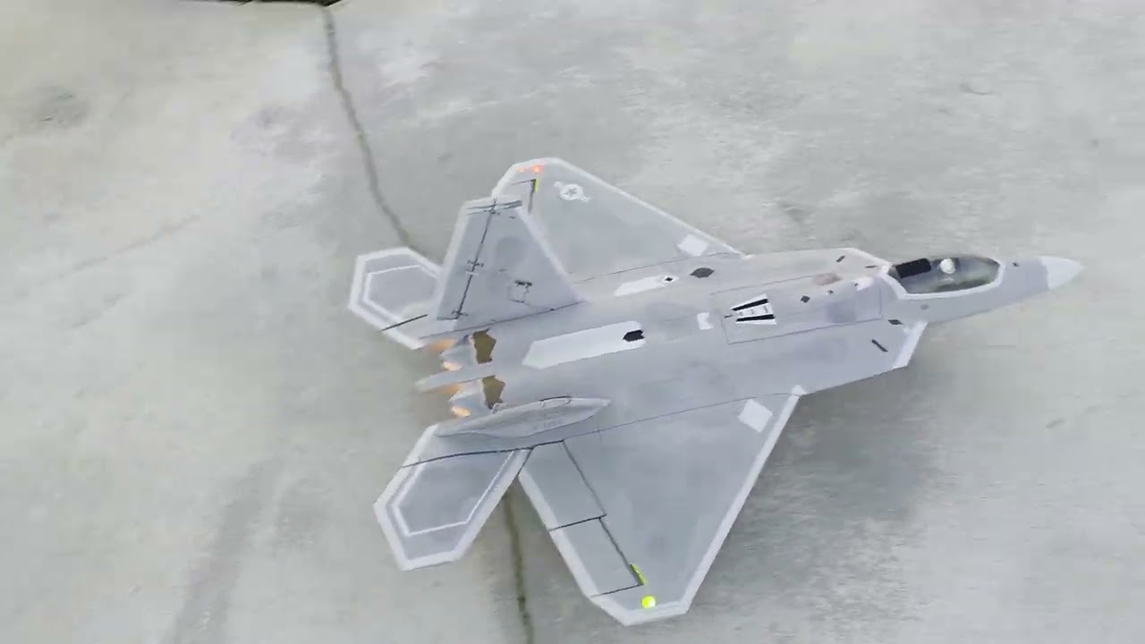

          Very nice glad to see I’m not the only one who’s done wing and landing gear lights. I also did Navigation with the KMRC blue burner, there a sweet flying plane
            Thanks, I'd like to get that Blue burner for my jets one day. Hope you post a video.

              I just finished up the last touches on one of my 70’s videos in coming if this weather ever decides to straighten up. She was a crashed plane repairs turned out really nice I think

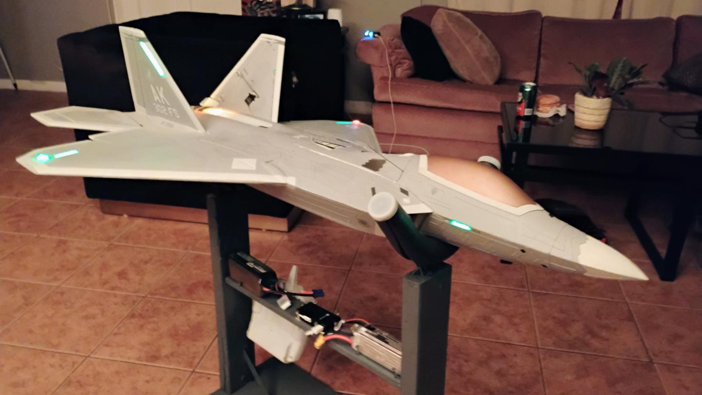

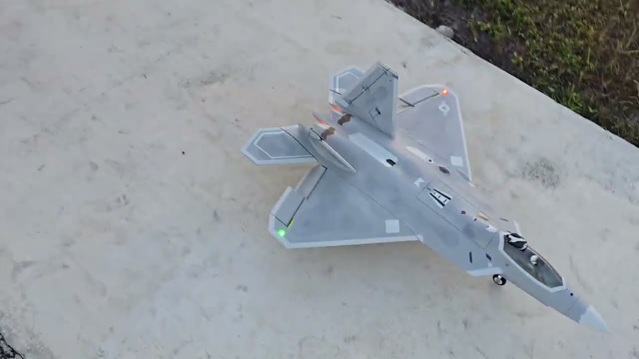

                        Got mine Apr 27th... Still haven't flown it but have been working... Added the Stemwings Formation Lights, Light added to the Nose Gear, Dual Afterburner light, painted the glass with a mixture of 2 colors so it has an irridescent look to it and hit it with a frosted clear after, Added the Freewing EG-01 Gyro and programmed with Bluebridge, just need to add the nav lights on the wingtips and i think I'm good... Biggest reasons for not flying yet...
                        1st Reason... I have a Radiolink T12D and a R12F Receiver and the Receiver to me seems like garbage... Signal not strong enough and while testing it during a long distance taxiing run the signal cut out and i had no control of the throttle for a few seconds... Thinking about getting the R16F Receiver cause it has dual antennas a farther range listed but also not sure if i should just scrap the Radiolink TX and RX and just save a few bucks for a Spektrum TX/RX or something else off FB Marketplace and play it safe...
                        2nd Reason... The only 6S batteries I have are all HRB 3300 60C batteries and from what i see is recommended and what everyone here is using, i need at least a 4000-6000 battery...
                        Any advice or recommendations would be helpful, it's only my 2nd EDF the 1st being the Freewing 64mm F-22... I love the way this plane looks and everything about it... Last thing i want is to rush the maiden with the wrong battery or TX/RX and end up destroying it...

                          I've been using HRB 3300 batteries no problem and I have the dual afterburner. Try setting the timer for 2.5 minutes and see how it goes. I think my timer is actually set at set for 3.5 minutes but I fly less aggressively with the 3300's and land early.

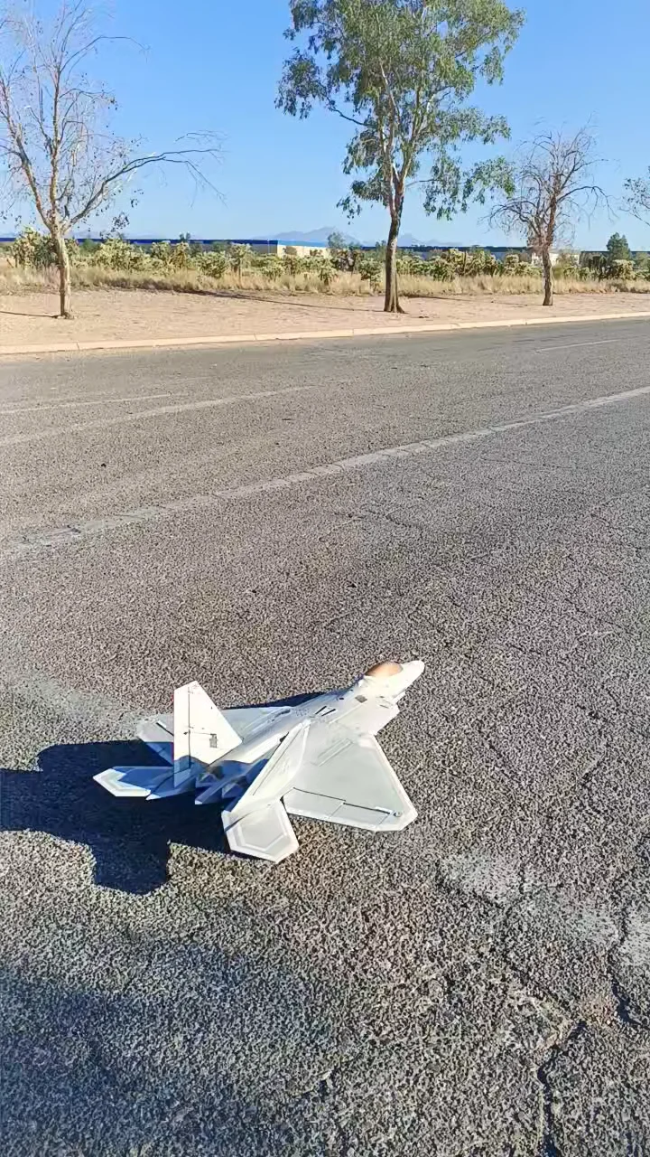

                            Successful maiden flight... A little bumpy on takeoff but successful... This plane is fast!!! Was so nervous at first my hands were shaking but after a min or 2 it was all good... Now to start with some more advanced stuff... Question tho... What % do you keep the throttle at for most of the flight? I noticed i was flying it almost 100% Click image for larger version  Name:	IMG_20250602_005757620_AE.jpg Views:	0 Size:	96.5 KB ID:	427124
