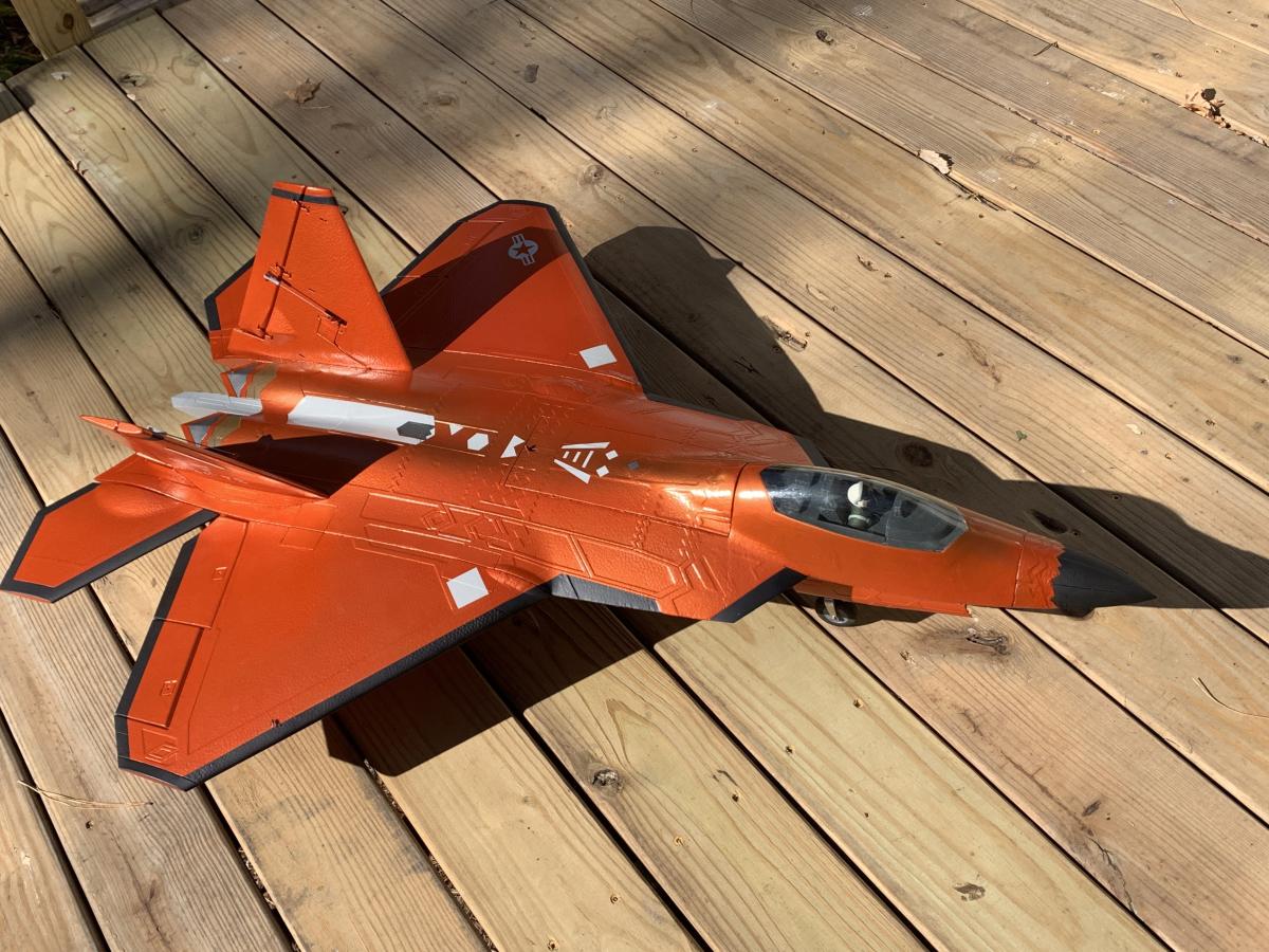

              Finished up, now for the weather to cooperate

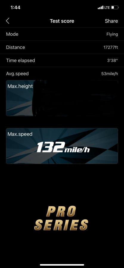

                    Got another great high speed slight dive test in Monday, the Raptor doesn’t disappoint one bit

                      Thats one fast little jet
