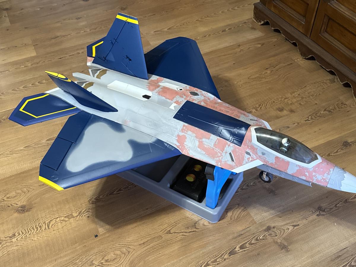

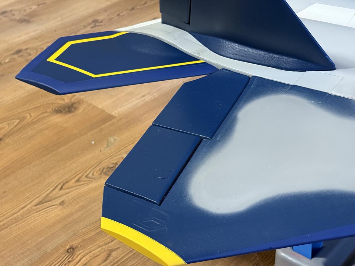

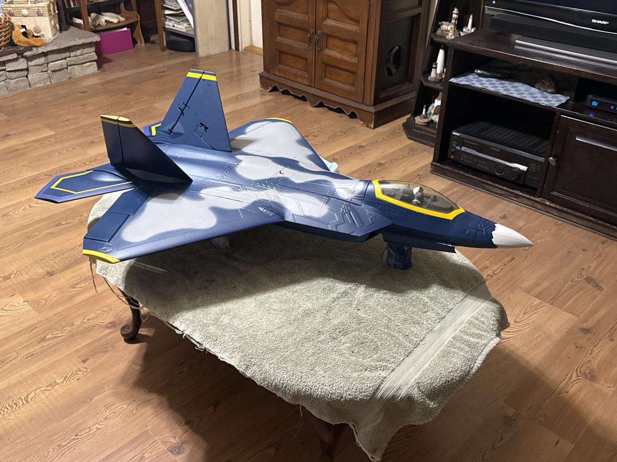

I’m running a SMC 59/5100 in mine I modified the fuse to allow me push the pack a little further than stock allows. CG wise I’m exactly 2 full fingers past the wing CG marks with 150/125 servo rates. She’s finally coming together paint wise some more work on the bottom and trim on the fuse top side
