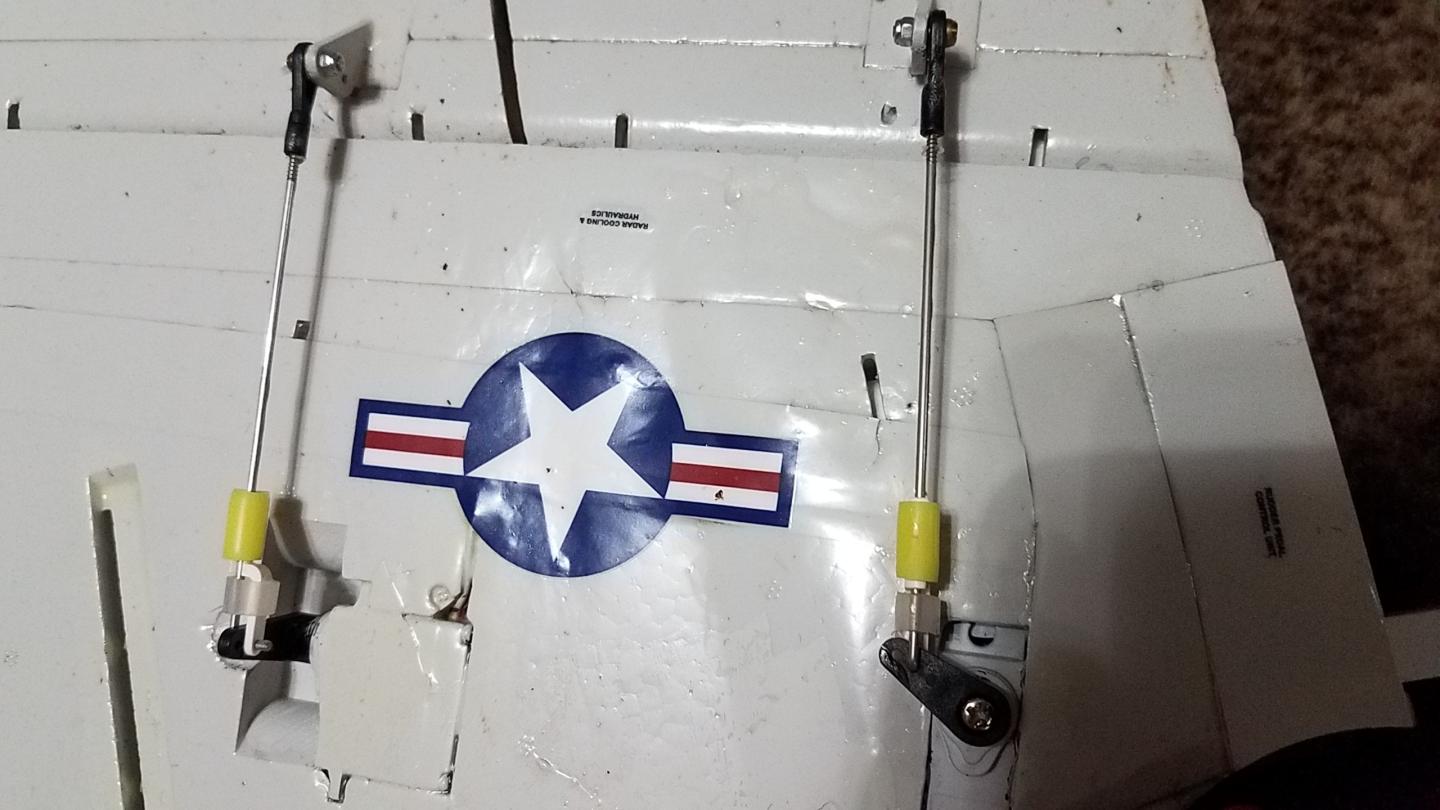

    Any recent med anything to keep servo linkages from falling right out of the servo arm? They don’t come with any to secure them
    If you do not have fuel tube use pvc insulation tape, cut a strip 6 to 8mm wide 40mm long and wrap it round. You need small fingers, Choose your colour to suit. once these fittings snap onto the rod it is rare for them to come loose so check that they have "snapped" on in the first place, if not you are better off using another one.

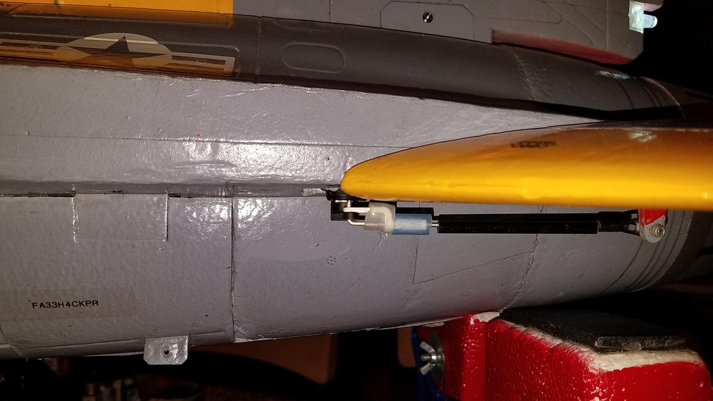

    I like to use different size fuel lines to secure the arm to the servo. Hasn't failed me yet. Is this the area that you are concerned about?
    Not great pictures, but all I have at the moment.

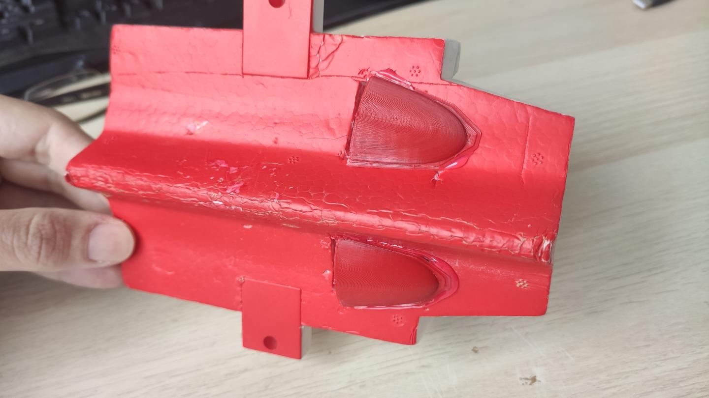

    Added air scoops for extra cooling of the thrust pipe.
    printed for 0.04 $ (4 cents) ;)

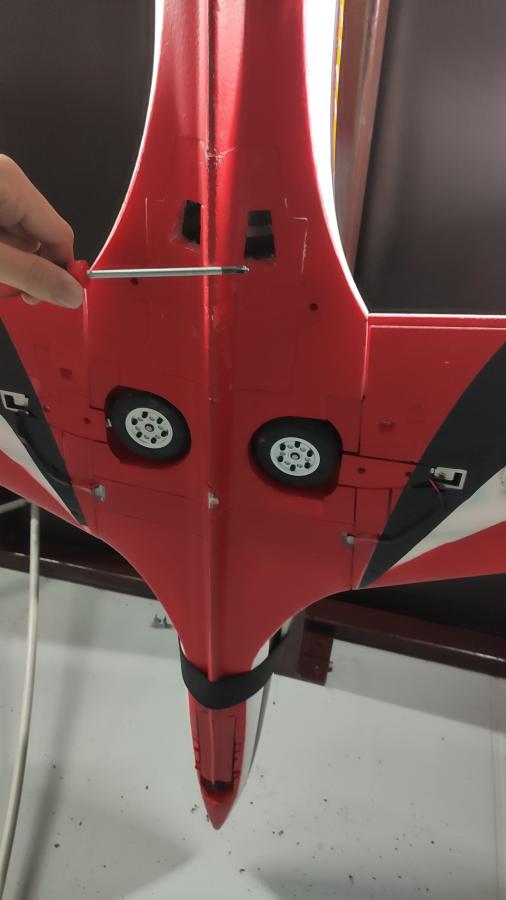

    My geardoor broke. Should I get a new one or leave it off? Thanks
    Mathew, I would leave them both off for about 20 flights after which you will have the landings nailed then fix new ones but epoxy some 2mm rods along the outside to stiffen them up. Not the inside as the nosewheel may catch as they open. . Once stiffened up the doors will align and close better. Also check how the the door springs work. if you can get the springs on opposite sides to have equal tension you have more chance of the doors meeting in the middle. Also check how the nose leg hits the the main U spring. Too strong or too weak affects how the doors close and if they close fully or too tightly. It is a bit of a pain to get right. You could also ensure that the doors fully seat at front and back by adjusting the foam as this again affects how the doors meet in the middle.
