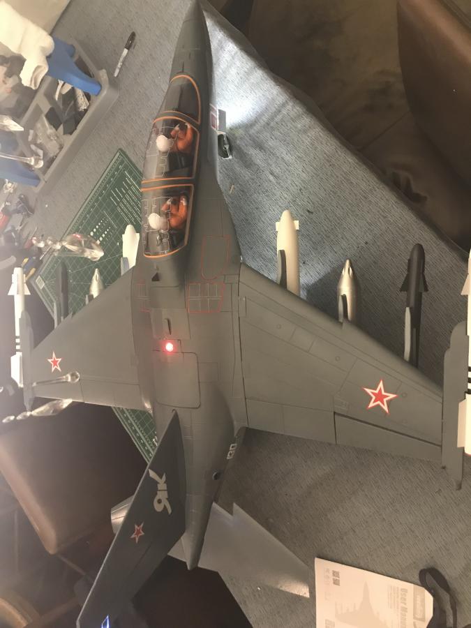

                                  I miss mine so badly , i WISH ALPHA can see this message to ask him if in any corner of the were house there is a yak , with or without power system.
                                  Everyone have a fav jet, mine was the yak and still does . Long story short , mine had the first blue box installed and had issue from the beginning. Crush with no controls . In this day’s i’m still using the same reciver and battery on my f-18 and so the radio.
                                  I never call Motion, I didn’t have a video and the jet was going out of production. Got a old used one, rough condition from previous owner. Got 20ish fly on it and sold it. To many dents and glue , i like my girls in tip top condition but i miss her very very much !
                                  I’ll pay full price Alpha...if spirit move your soul

                                    #97
                                    And here she was ....
