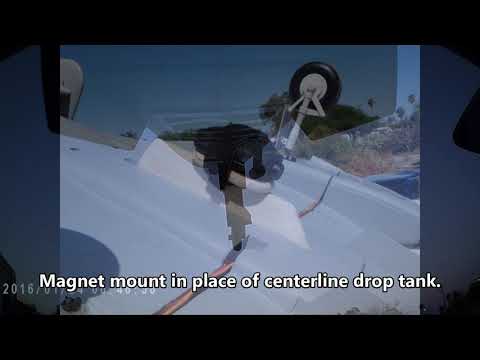

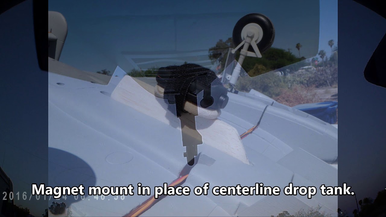

Quick test of the view from the camera mount.
Official Freewing 64mm EDF A-10 Thread
Quick test of the view using a camera mount I fabricated of balsa wood, to fit on my Freewing 64mm A-10 model. -
