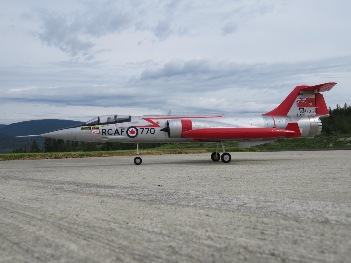

        Hi all. My first post here. I've had this 104 since Aug 2015. I really love it. 53 flights on her. Had lots of road rash on the tip tanks from crosswind landings, and a few scrapes from some bouncers! (Have to keep that power up on final.) Somewhere along the line I crashed a plane I was using an AS3X rx in, so transplanted it to this 104, and what an improvement, But I was still getting the wing wobble at high speed. I noticed the aileron hinges were quite sloppy. So I was starting to replace them, and thought, I don't really care for the camo scheme on the Starfighter. It's a STAR-fighter after all! And the road rash and bubbled foam in the cockpit needed attention. So out came the bondo (Light-weight filler) and paint. I love the NASA F-104 scheme so that's what's in the works, slowly but surely. I also transplanted a Freewing 12 blade 3048-2150KV edf into it, as a fellow pilot at the field had a FW Yak-130 that was a rocket compared to my 104, and that's what powers that. Didn't notice a huge speed difference though, but more vertical. On that note, I had a thought on intake air on the 104. The cheater holes on the bottom are squared off to the air flow at the leading edge. Now I know this would take some real aerodynamics and wind tunnel testing etc to really confirm, but I figured if the air passing outside the cheater holes is going faster than the air going past on the inside of the duct, then according to Bernoulli, air would be getting sucked out of the cheater holes! So I sanded them to theoretically create a low pressure area to pull air in. Haven't flown it this way so it's yet to see if it does anything at all. Anyway, just thought I'd share. Merry Christmas and happy flying!

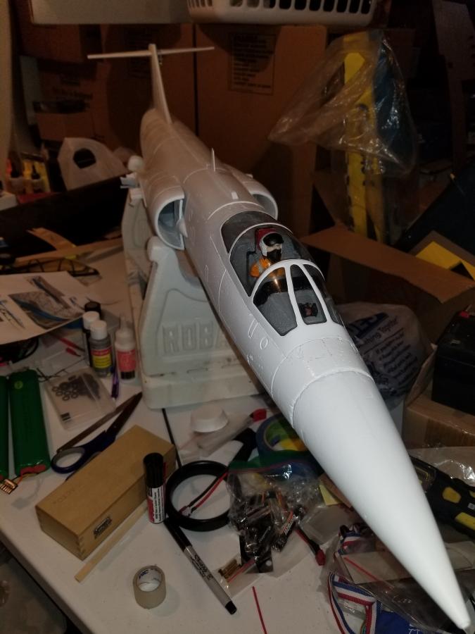

                  Here is my customized F-104. I have not flown it yet.
                  I am wondering about the CofG in the manual.
                  Is it correct ? , it seems to far forward.
                    I maidened mine on Sunday with the stock CG and I agree with you. However I'm going be very cautious about moving my CG on her. Probably 2mm at a time.
